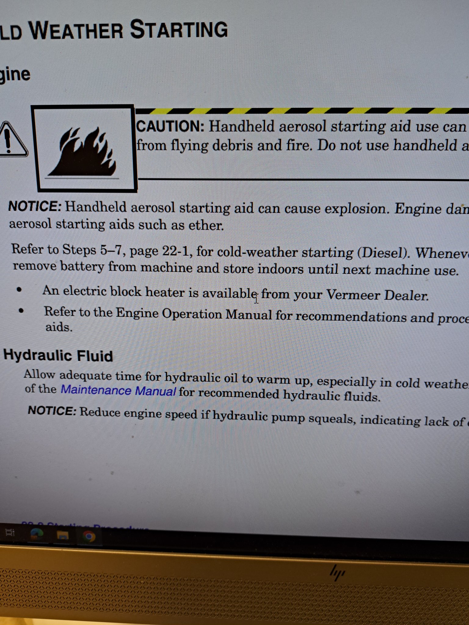

I have confirmed that either my SIL did not understand the dealer, or the dealer is full of it. (or a combo of both...LOL)
This is from the operators manual I found on google.
