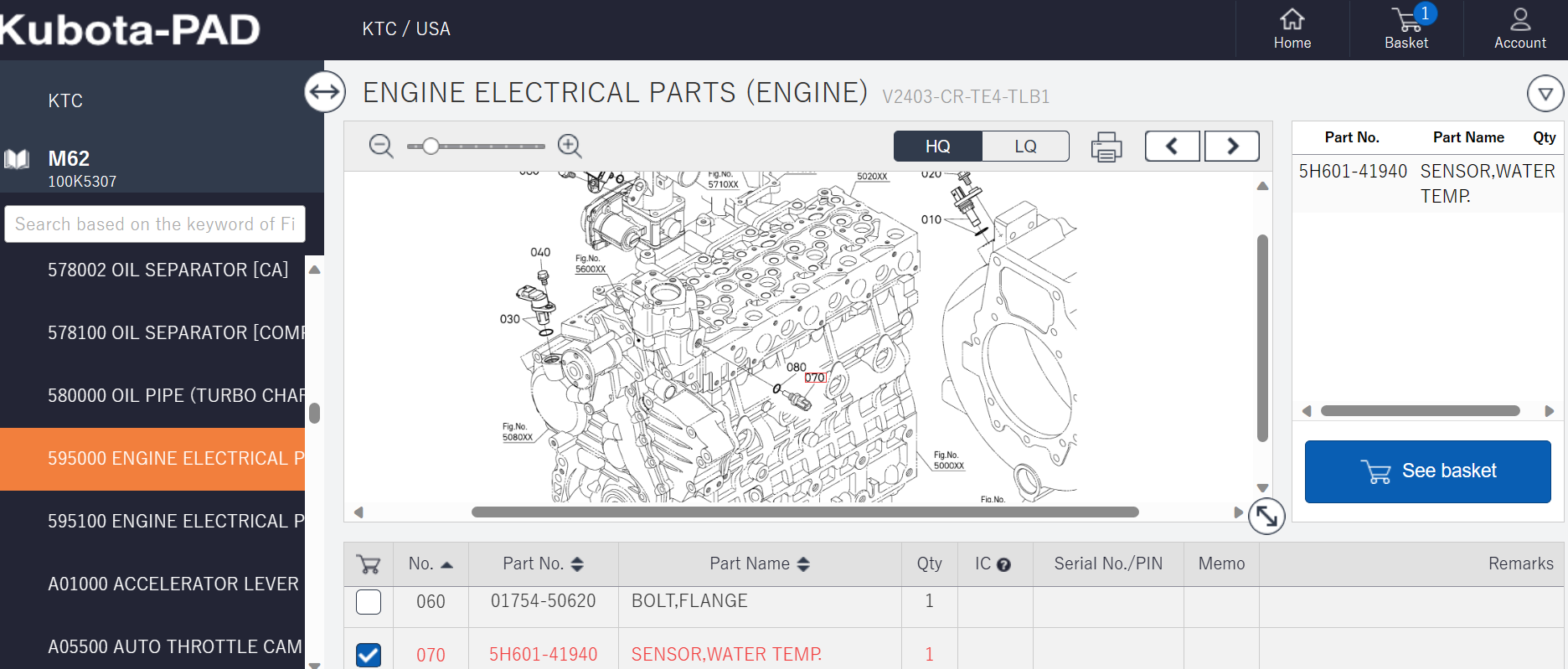

Wow, talk about culture shock compared to my BX. The temperature sensor was somewhat difficult to find in and amongst the many ECU, wire harnesses, etc...
