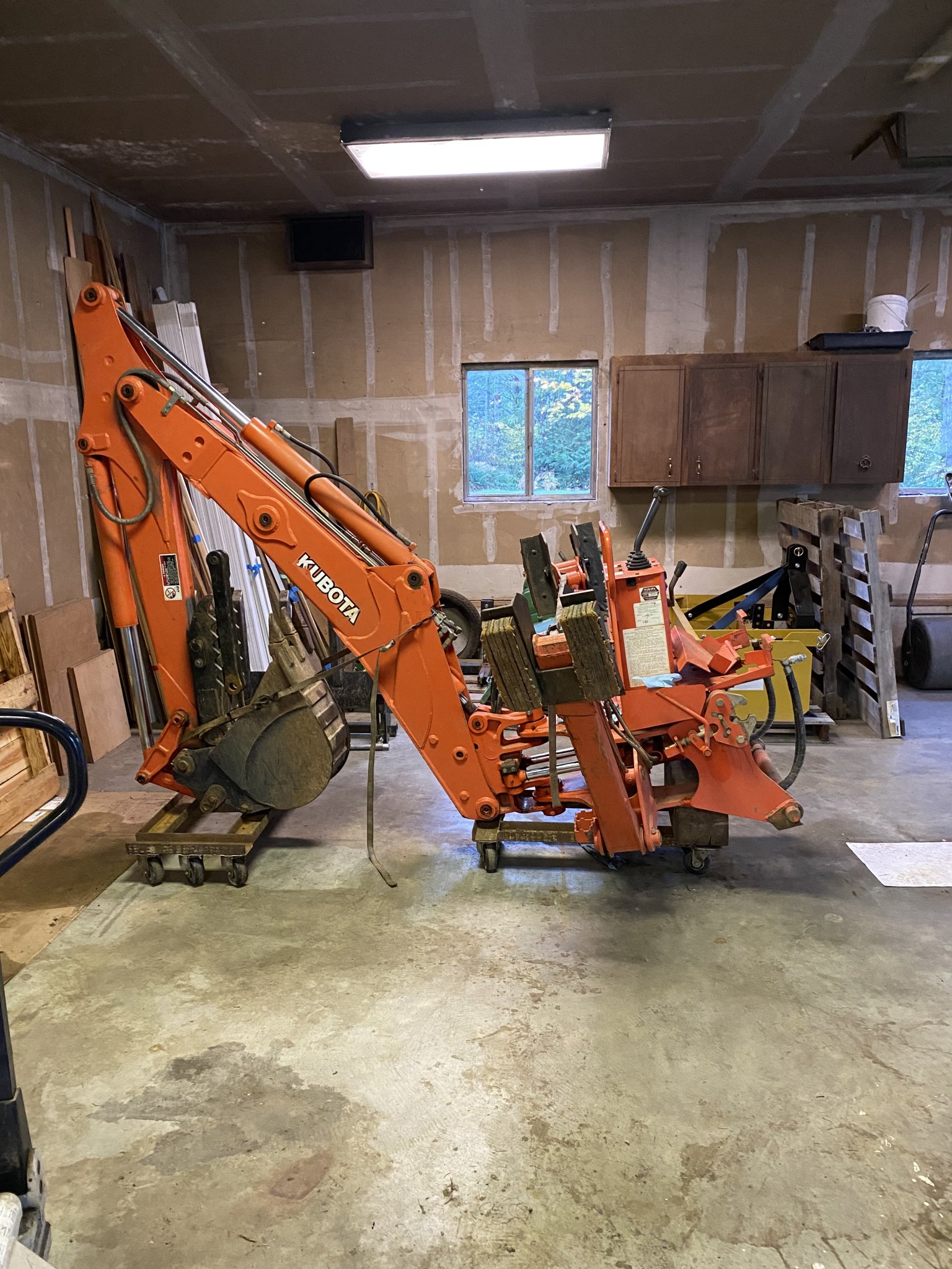

A while I after I brought the L48 home, I thought I would remove it just to see how easy/difficult it was to remove. I was impressed at how easily it was to dismount. Also, just as impressed at how easily it was to remount.
I have a couple of 6 caster, c-channel dollies that I lowered it down onto so I could move the dismounted backhoe around. Moving it around was a little harder than the dismount/remount. It was kind of an exercise in isometrics. The set up was a little sketchy, but it worked. I will lube the caster axles and swivels before I put it on the dollies again, if I ever take it off again.
I have a couple of 6 caster, c-channel dollies that I lowered it down onto so I could move the dismounted backhoe around. Moving it around was a little harder than the dismount/remount. It was kind of an exercise in isometrics. The set up was a little sketchy, but it worked. I will lube the caster axles and swivels before I put it on the dollies again, if I ever take it off again. View attachment 113434
My first thought was, holy crap the backhoe is bigger when it's off the tractor!
Then I realized that isn't a BT603. :p
Yep, it is a little bigger than the BT603. My other tractor is a John Deere 855, with a number 7 backhoe. Comparatively, it is a toy compared to the L48 with the BT1100.
