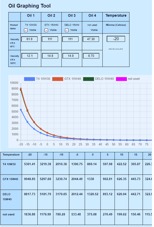

To illustrate here is a viscosity graph of three oils :
BLUE = Shell Rotella 10W30 conventional​
RED = Castrol GTX 15W40 conventional​
GREEN = Delo 15W40 full synthetic.​
For cold weather startup the conventional 10W30 is the clear winner and there is no difference in the conventional versus synthetic 15W40.

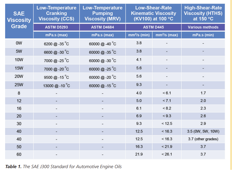

Here are the current SAE J300 requirements including the ASTM test methods to be used for measurements. . The xxW grades are shown in columns 2-4. and xx grades in the columns 4-6, The only overlap between xxW and xx grades is column 4.
A multi-grade oil meets exactly one of the xxW requirements AND exactly one of the xx grade requirements.
A monograde oil meets only one of the xxW requirements or one of the xx requiremnts but not both.
SAE 20 and SAE 20W are entirely different grades.
SAE J300 also specifies the ASTM, test methods to be used for the measurements. There is no such thing as a 08W20 multograde oil.

That is utter BS.
The 20W is for like a 20w50 oil, for the 20W part. SAE 20 is just 20 weight oil. Neither above nor on line could I find any spec on VI or a lower temperature spec for it to know what xxw20 it is.
The first number is NOT the grade of the oil. It is for its specification at some lower temperature. The 2nd number in the xxwyy spec is the grade of the oil at operating temperature, e.g. 100 C.
I've read where some of you have called 5w30 oil a 5 grade but acts like a 30 grade at operating temperature. No. It's a 30 grade oil that meets the low temperature spec for a 5 grade and likely has about 140-190 VI.
