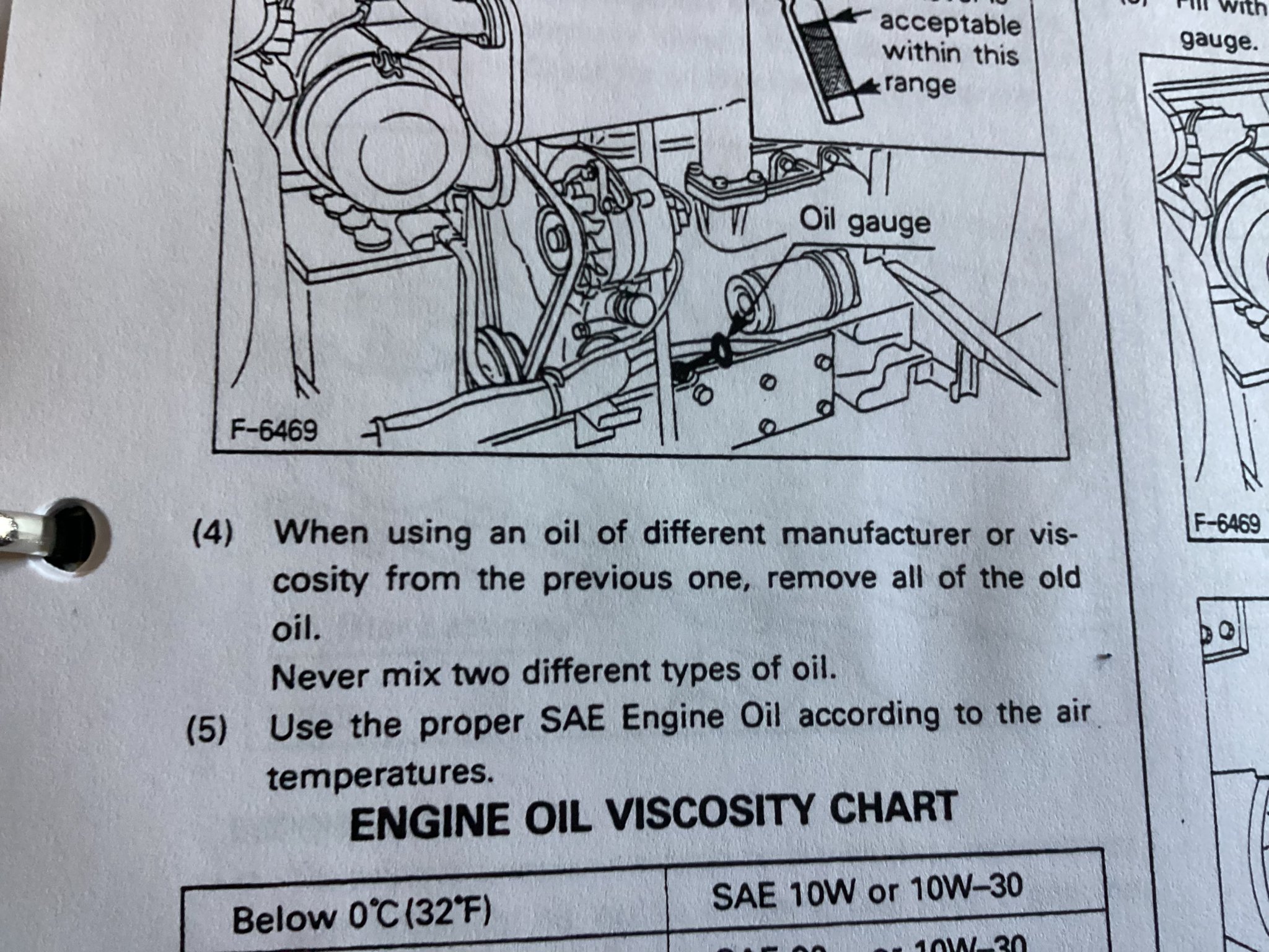

Someone posted a pic right out of the Kubota owners manual. I’m sure it will resurface now.

Consider it resurfaced…. It was in my owners manual.
I’ll restate I am NOT in agreement with it.

Interesting thought process even though this was printed in June, 2002
