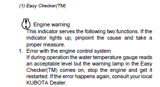

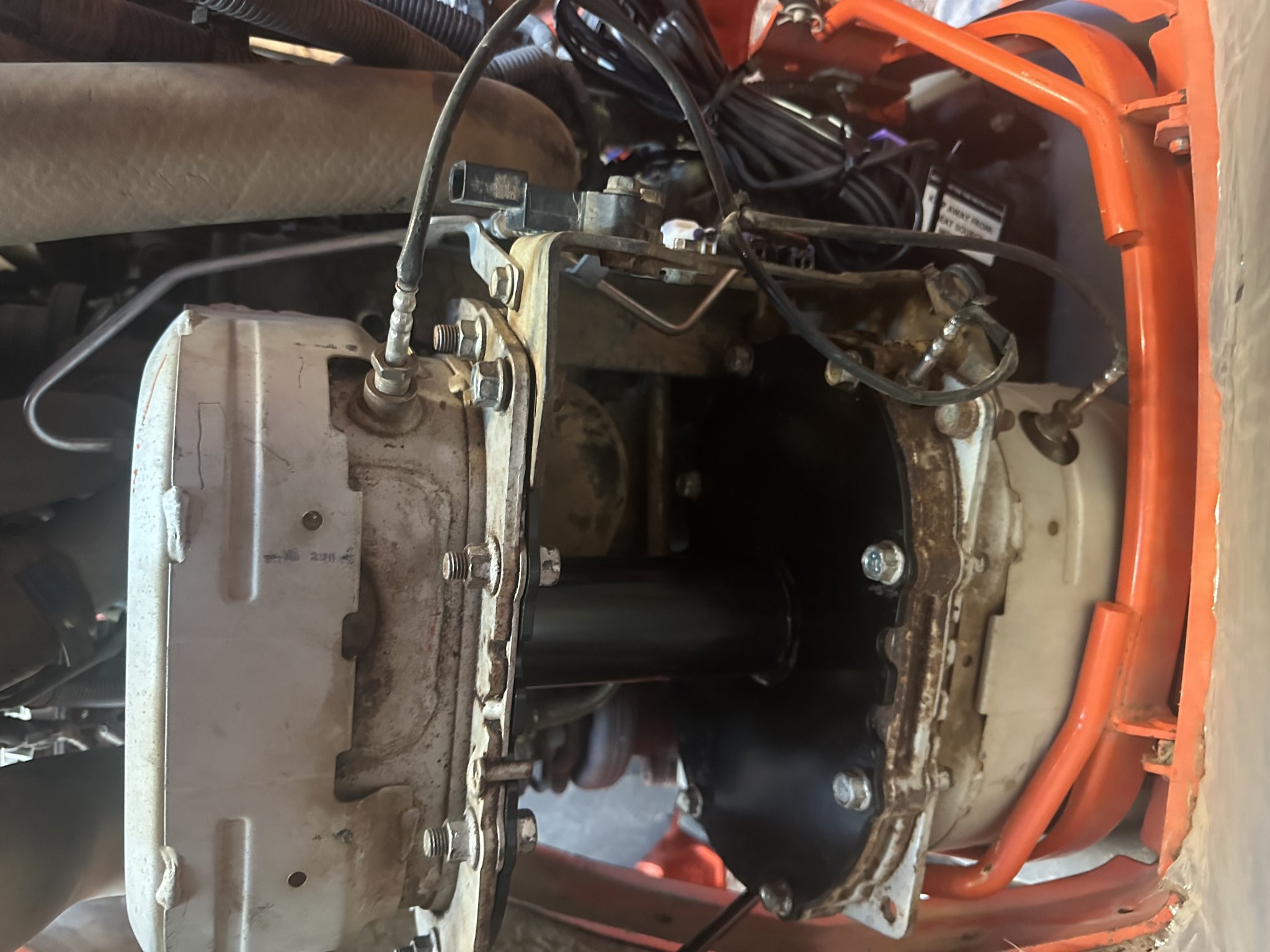

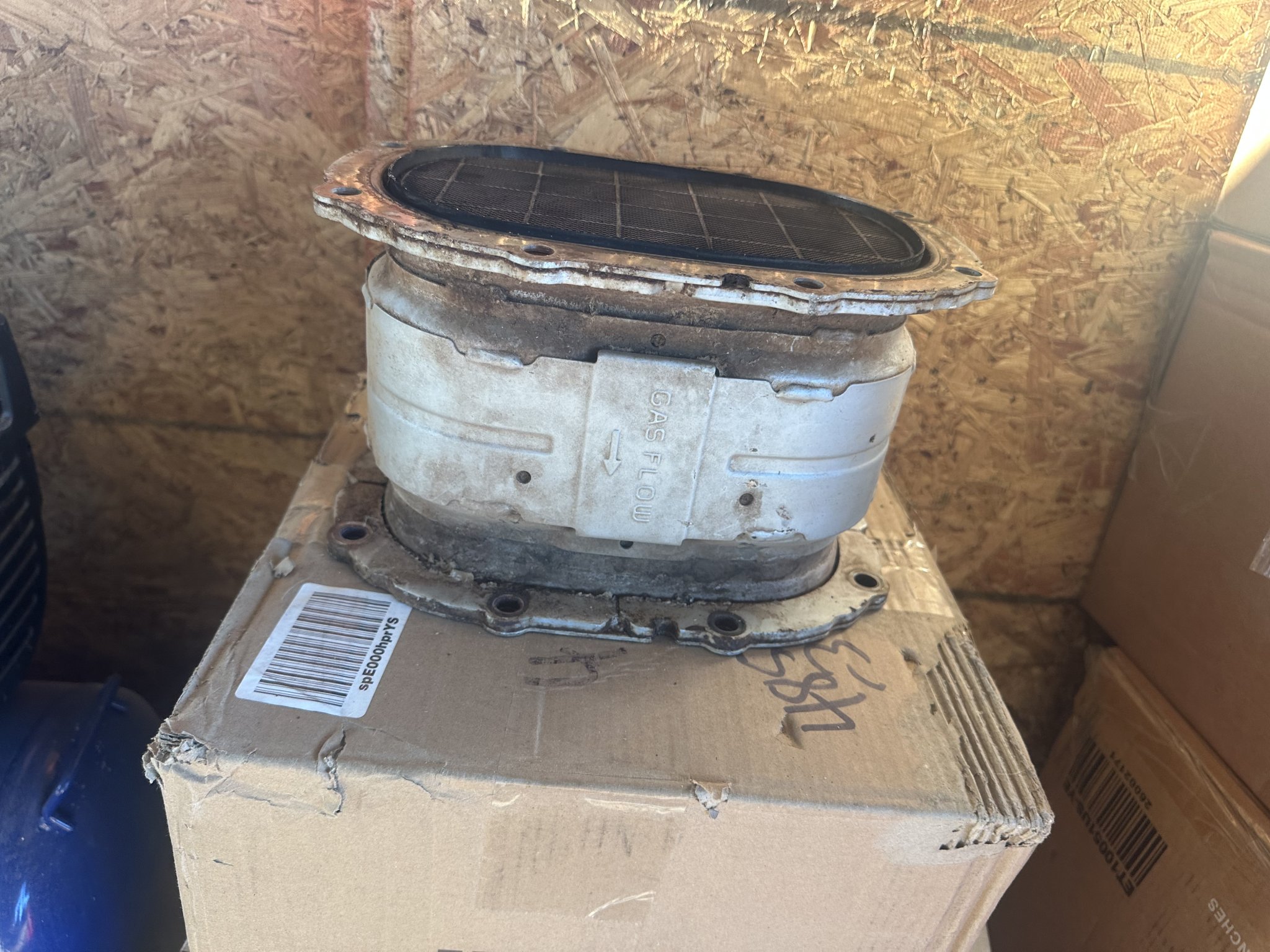

Yes the light come on and i bring it to dealer they said my DPF is bad need replace.i just bought the tractor a month ago dont have enough $9000 to replace the DPF.And i installed the emulator but the light still on..
tractor run and operates fine with the light on
the picture can tell you what i have replace on the DPF..
today i call in same dealer ask them if they can clear the code.meet different tech.After explaining my situation and problems on the tractor she said look like your issue is not the DPF..And she sent me some picture..
OK .... so the DPF has been replaced with a straight pipe, and the emulator needs to make sense of the inputs from the thermocouples pre and post the straight pipe. As was suggested, I'd be calling the company who sold you the emulator and straight pipe kit to see if this issue is related to the emulator since an issue with the ECU can cause the light to illuminate. If it's something else you'll have to trouble-shoot via the WSM to see what's causing the light to come on.
Thanks you..Tomorrow i will go a head and buy oil pressure tester to see if the issues relate to that or not..Anyway thanks you so much for helping me

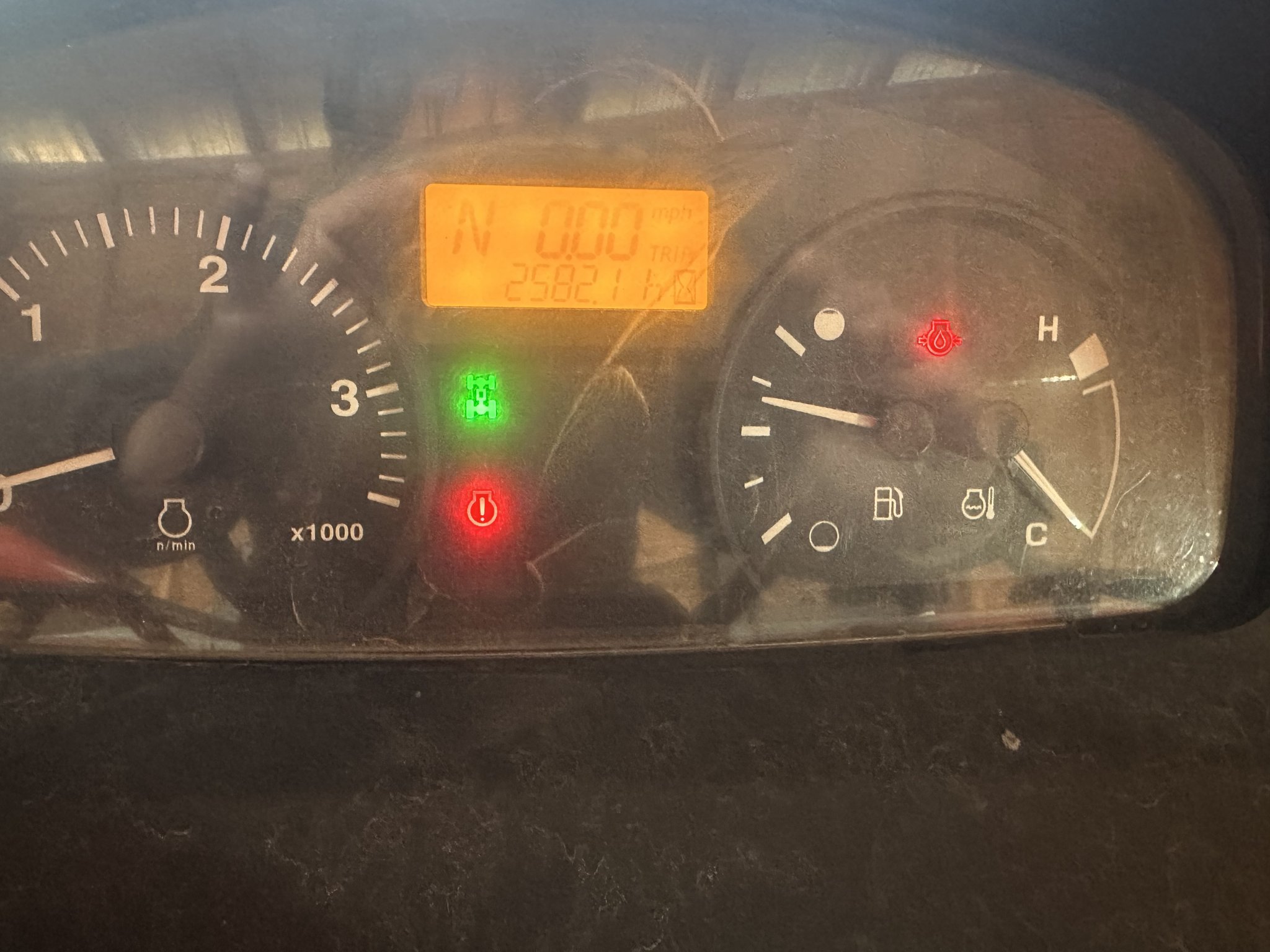

i dont know yet..have to trouble shot first..right now only 2 light come on..
1 engine light and stay on from ignition to started
2 low pressure oil light on when ignition but turn off when engine started

1/ the check engine light on b4 i installed DPF by pass kit.The DPF filter is still on the tractor i only replace the middle one with the pipe come with the PDF Kits.
2/ Yes the Emulattor come with all the connector..temperature sensor,differential presure sensor and rail fuel pressure sensor
3/The tractor never got over heat befor..

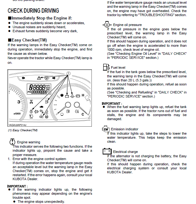

i saw when put the key to ignition both oil presure light and check engine light stay on..But when i start the key the oil presure light come off..Dont know if the problem is oil pressure..
That's normal operation for the oil pressure light to be on when the ignition is on and engine is not running.
Did you actually take it into a dealer and have them run a scan on it?
It's possible that it may not have overheated, but the system is saying that it did hence why the light is locked on.
Do you have the WSM?

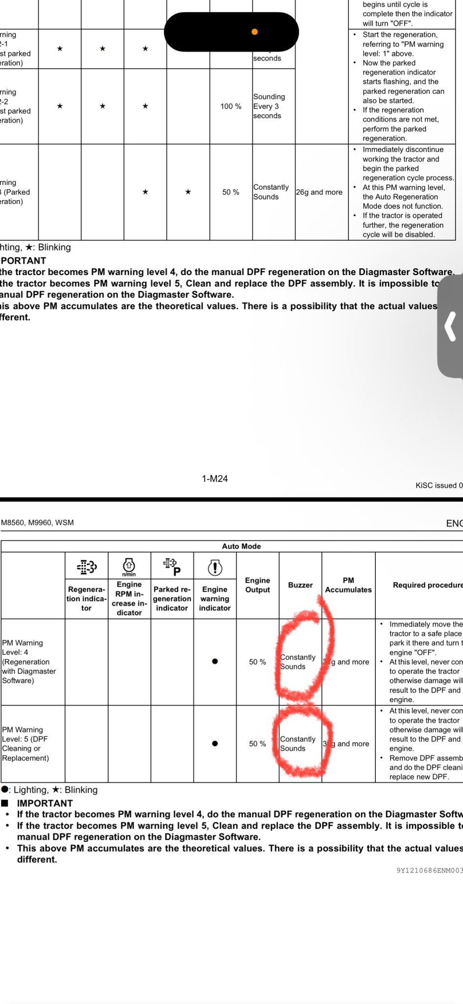

i dont think it relate to the DPF..The light come on befor i replace the DPF
Reimer Tuning includes a Denso DPF reset tool with their programmer for similar tractors to yours. If the reset tool isn't installed, the ECU will record but not report a DPF related code after a set number of hours (around 15 hours I think). The ECU will start to log but not report DPF warnings levels and go through PM warning level 1, PM warning level 2-1 and then sound an alarm and illuminate a bulb at PM warning level 2-2. If the Denso DPF reset tool is installed it will reset the ECU "clock" every time the tractor is started.
Obviously I have no idea of what your problem is but it's just another possible piece of the puzzle. Good luck in your troubleshooting.

Thanks you..I have no idea if the Denso installed or not..I read the WSM of my m9960 the light is for DPF regen..level 4-5 but there is no buzzing sound continuously..Just only the light is on 😂..
