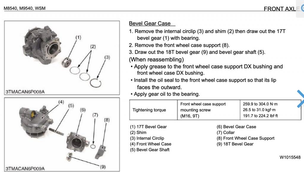

Firstly, I dont have that tractor, I have an M4700DT (4WD) and cannot find a planetary hub in the WSM. Perhaps theres a terminology issue?
The M4700 WSM does address bevel gear case on the front axle and prescribes a torque of 122-144 ft lbs.

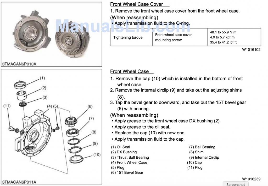

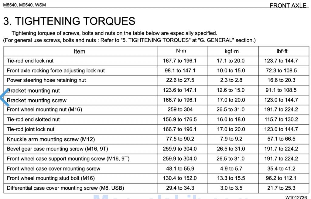

attached below are the front axle parts torque specs, bevel gear case figure and front wheel case cover figure from the WSM for the M9540 to make sure of torque spec you want. If you can view the website from Canada, the following is a link to the WSM BY CLICKING HERE.

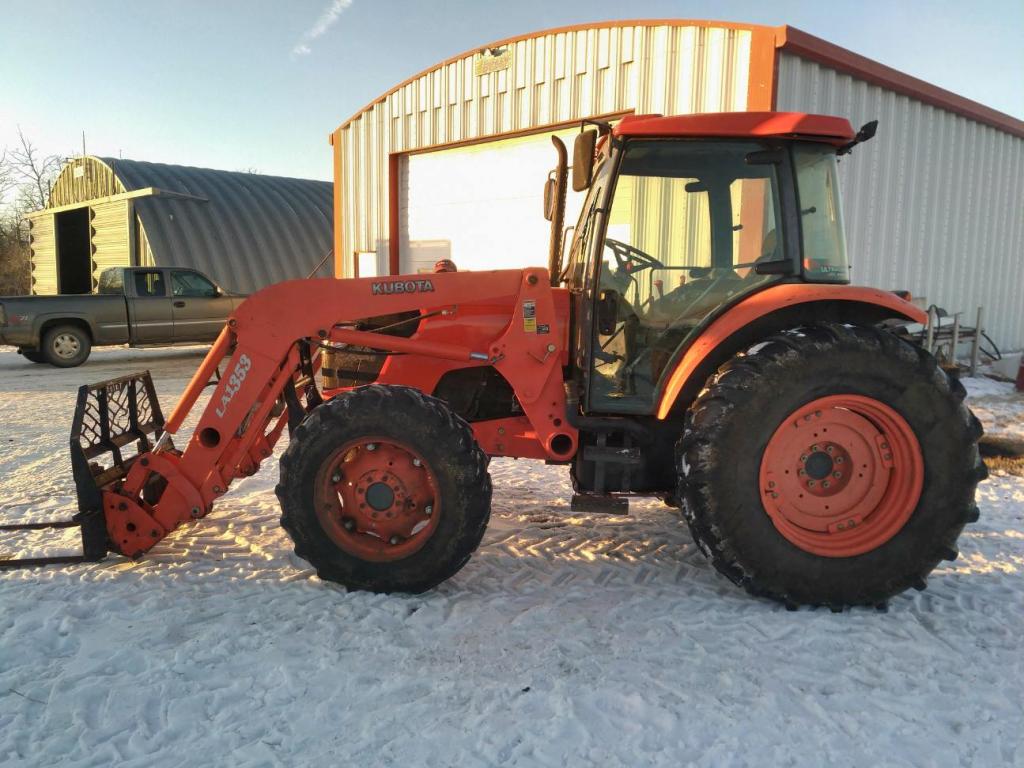

There she be. Up and running! Thanks guys!

Please not that the GENERIC table listing torque values for various sized fasteners DOES NOT APPLY to every case. (Pardon the pun)
Specific applications have specific torque values regardless of the size fastener. (Compare that Generic table to the actual specification for this item.)
Thanks Flip for posting that however as it is useful for general purposes.
