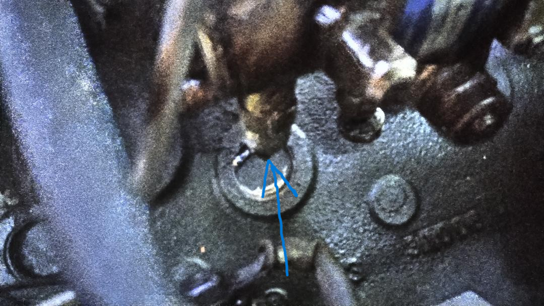

Drained the fuel tank and changed the filters out. Got fuel coming out the lowest bleed plug on injection pump and some will come out the top bleed plug but not a lot. Been cranking a lot on engine and getting very little fuel at the #1 injector but it's some fuel... I've used start fluid to help start it but it doesn't make any difference. I've never seen a engine that would not kick back at too much start fluid but this engine won't, no matter how much start fluid I spray. Don't know what to try next. Any help would be much appreciated. Thank you

I don’t know anything about that pump, but what you marked in blue looks like a drain to me. Why do you think it is something electrical?
My picture was wrong. This picture shows the fitting and it has a wire coming out of fitting. Not a good picture but I think you can see the little piece of wire. Thanks

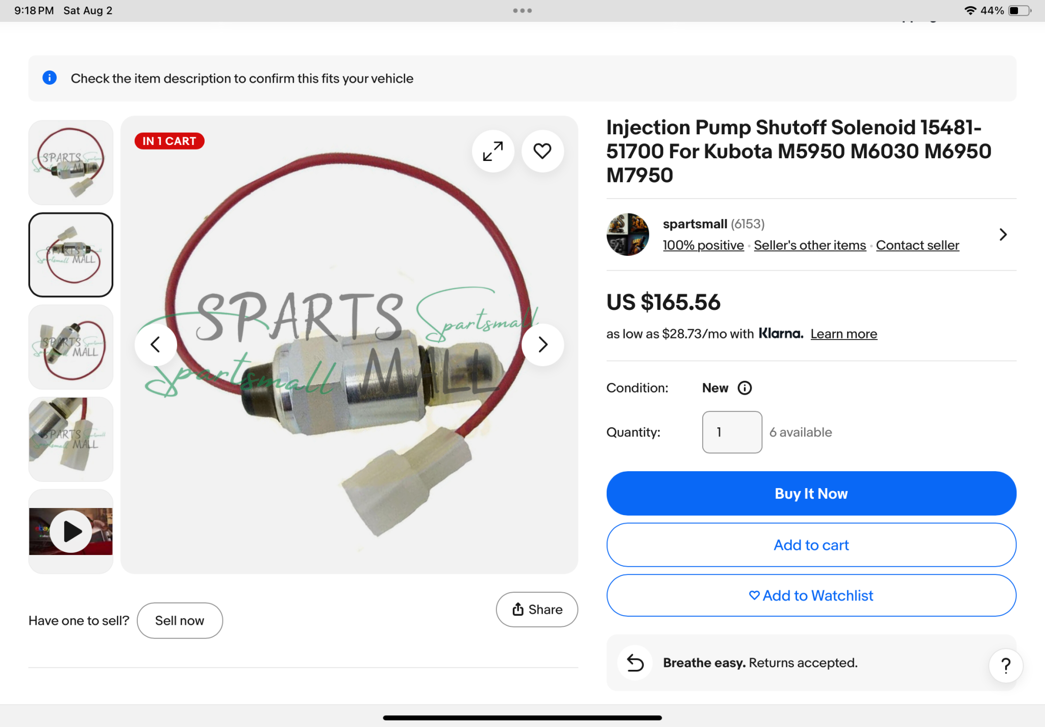

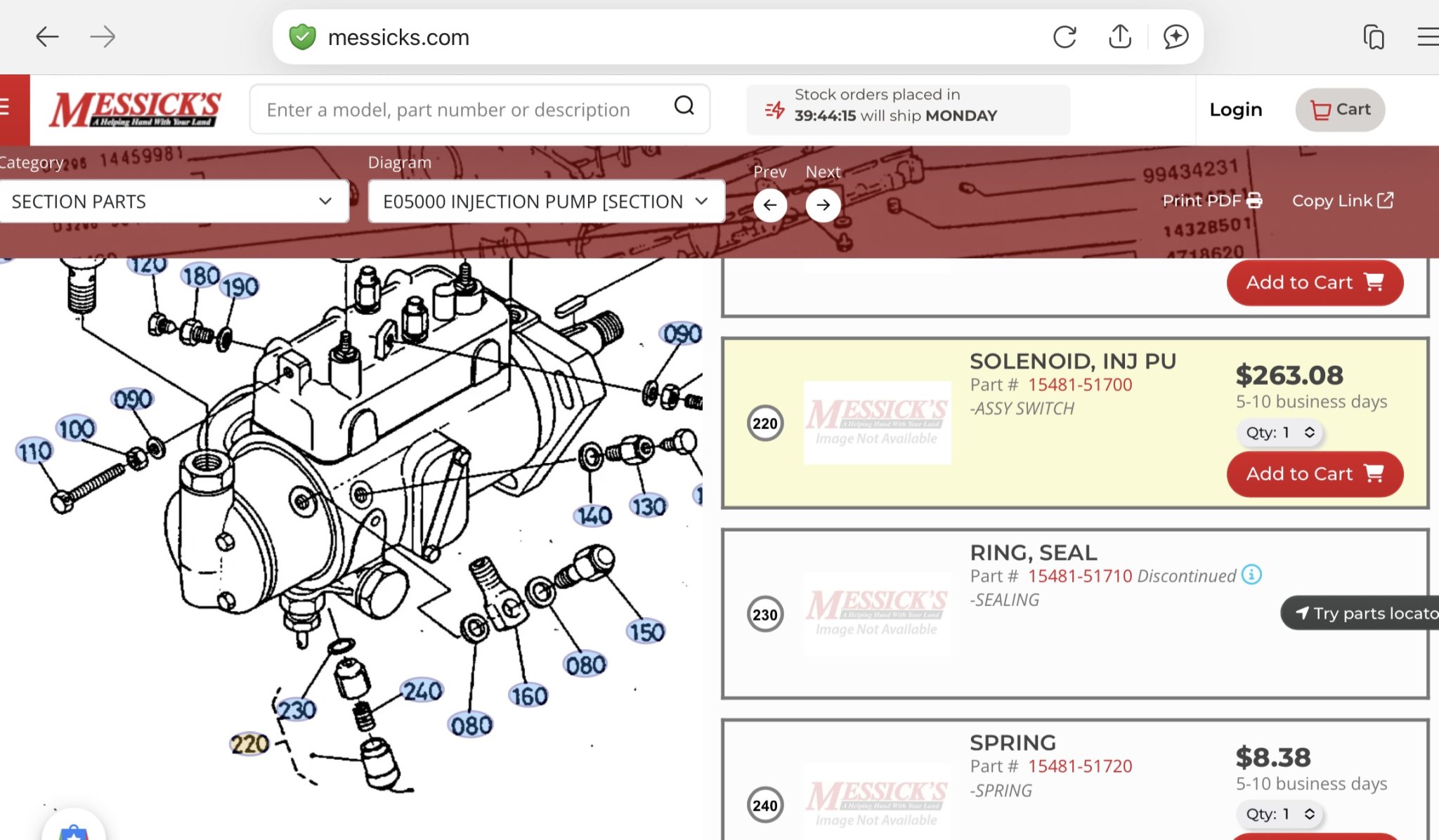

Looking at Messicks illustrated parts list I found this
Looking on the internet I found this more descriptive name = you may have stumbled upon the problem!
6,863
2,384
So you can shut off your tractor when the electric switch fails!
