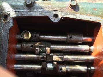

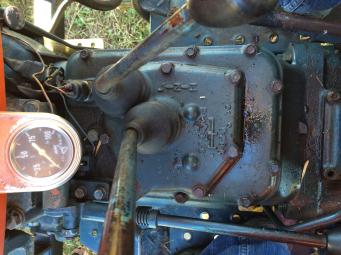

I'm gonna pull off the cover plate and take pics. Maybe y'all will see something that way and be able to help better. I've never messed with a tractor transmission so I probably won't know what I need to move around. Thanks.
Jckruid
M4500DT
Oct 24, 2015
20
Leavenworth, KS
From the first pic, do I need to align the one that's not in the middle with the other two? If so it doesn't move by hand. What say the smart guys? Please help
