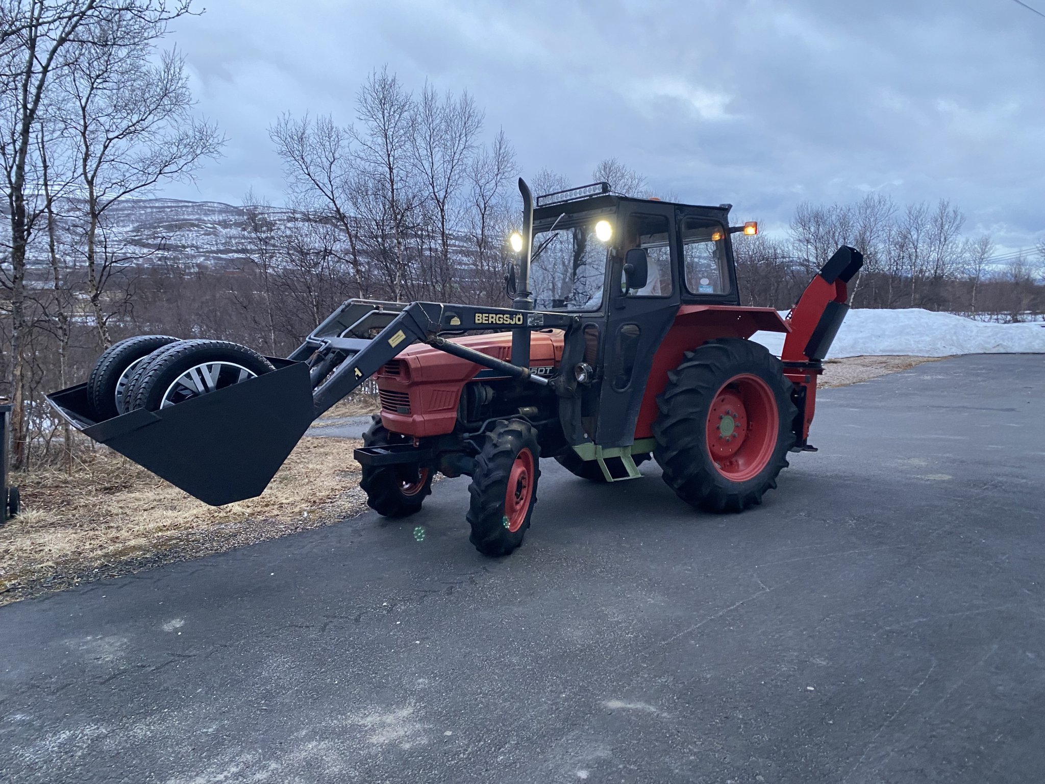

I have a L345Dt and it will not start anymore. When i try to start, it glows, but when i try to engage the starter it blacks out. Then i have to wait a few minutes before i can try again. it goes all black exept accessories like lights, they work as normal. Im not sure if if the starter solenoid engages. Just put in a new battery (new used) i have a feeling that it is not good, and the starter don´t get the amp it needs, but before i get a new one, i try here if anybody have had this trouble before.
