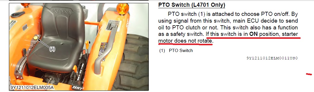

I looked at the WSM for your series of tractor which includes the L3301 and the L4701.
Read in the images below the description of engine start relative to pto switch position. These two tractors are doing opposite things.
I can see this important difference between two tractor from the same series causing confusion.
My quick guess is for you to jump your switch connector after unplugging it. It should then start
Be very careful as you are bypassing an important safety feature .
