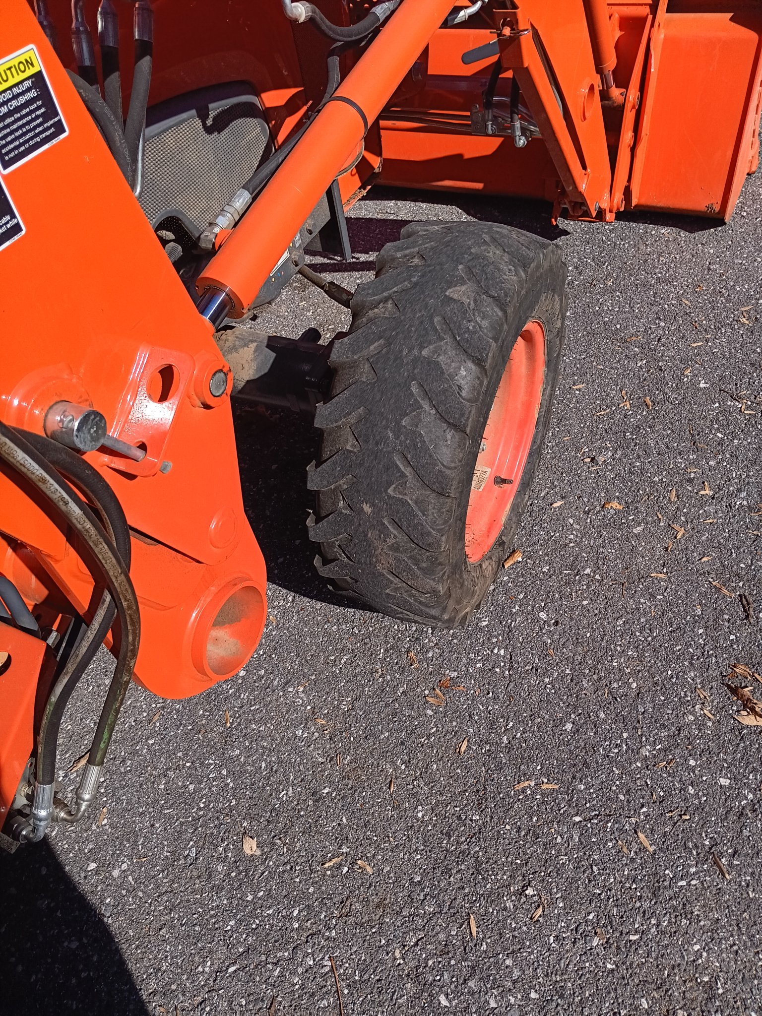

Ok, I did the test. I would say it passed it, huh? 🙂
Here are the results:

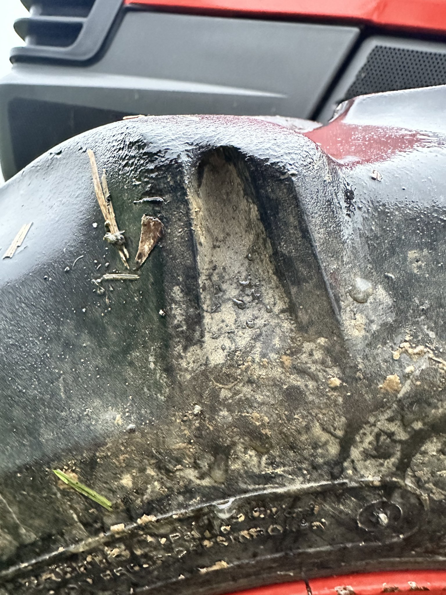

I am not surprised. Here is a picrure of the fronts on my 2021 L3901. It has 410 hours on it and is operated full time in 4WD. I am going to say 95% of that time was on grass, dirt, snd gravel with less than 5% on the asphalt and a lot of that in snow. In 4WD the fronts are always slipping by design and that simply "scrubs" tread off dirt or pavement. The good N ews is the f et onts are not terribly expensive. Two new fronts is going to set me back less than the tires on any of my cars or trucks.

Yep you are good to go, so don't worry about it and just get a new set of tires if you need more traction!

I just checked. It says it should be 4-8 mm toe-in. And I have 15 mm toe-out instead. By what I have read, toe-out wears down inside side of tires, yet in my case outside side is more worn out as you can see from attached images. Image 3752 is outside and 3755 is inside. Previous owner might have switched sides, who knows. OR, what about camber? I observed positive camber and it might outweight toe-out in context of which side of tires will wear more.
Yeah, excessive toe-out should wear more at the inside. As for switching sides, that's involve dismounting and remounting the tires on the rims - unlikely, but who knows.
Camber might do it, but there's no adjustment for that (that I'm aware of).
I'd adjust the toe-in to spec and run it. There's still plenty of meat left on both tires. See what happens in another couple hundred hours.
