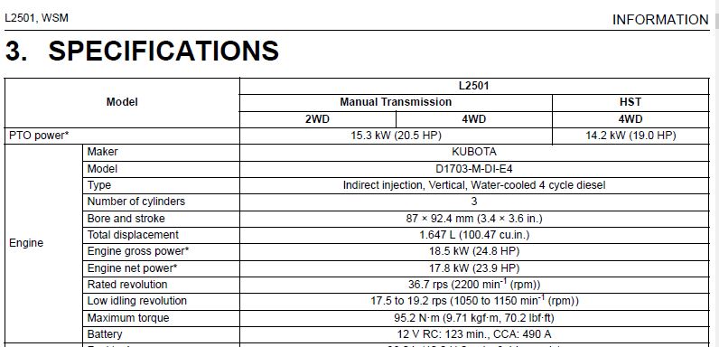

Anyone reading this do not raise the rpm over 3050 that is max rpm according to the service manual.
You service manual must be way different that the thousands of other ones out there! :rolleyes:
Yes I can find other manuals that show other specs.
BUT...They are different engines!
The only specs that matter are on a D1703-M-DI-E4-LB1 Tier4 engine.
Rdrett
Dec 5, 2017
222
Paris Ky
That is not from the service manual for the kubota d1703 engine.
Kubota only makes one d1703 engine.
Are you saying that the d1703 engine in the kubota L2501 is not a d1703 engine?
I already posted specs for the d1703 engine.
SRG
B8200D 4WD........ JD 870, FWA, 300x FEL.......... JD 797, 72" Z-Trak
Jul 15, 2017
490
N. IL
He's saying that the specs of the other 'off shoots' of the d1703 engine, do not matter, because it's not the same specific d1703 (-M-DI-E4) engine that's in your CUT.
36,878
11,559
That is from the L2501 WSM which includes the D1703-M-DI-E4-LB1 Tier4.
Post what WSM manual # you are referring to?

We're talking two different animals.
One is a d1703 engine sitting by itself, with engine specs by itself.
The other is an L2501 system, with a d1703 powerplant. The powerplant in the L2501 system is rated by design to 2200rpm. Apparently there are other subsystems in the L2501 which will not tolerate an engine running above 2200 rpm.
Kubota only make ONE d1703 engine.
The M means nothing important.
The DI means direct injection.
The E4 means teir 4 engine.
Kubota only has one d1703 engine. They do not make a special d1703 just for the l2501.
Here is some information on what the rest of the engine model number means.
