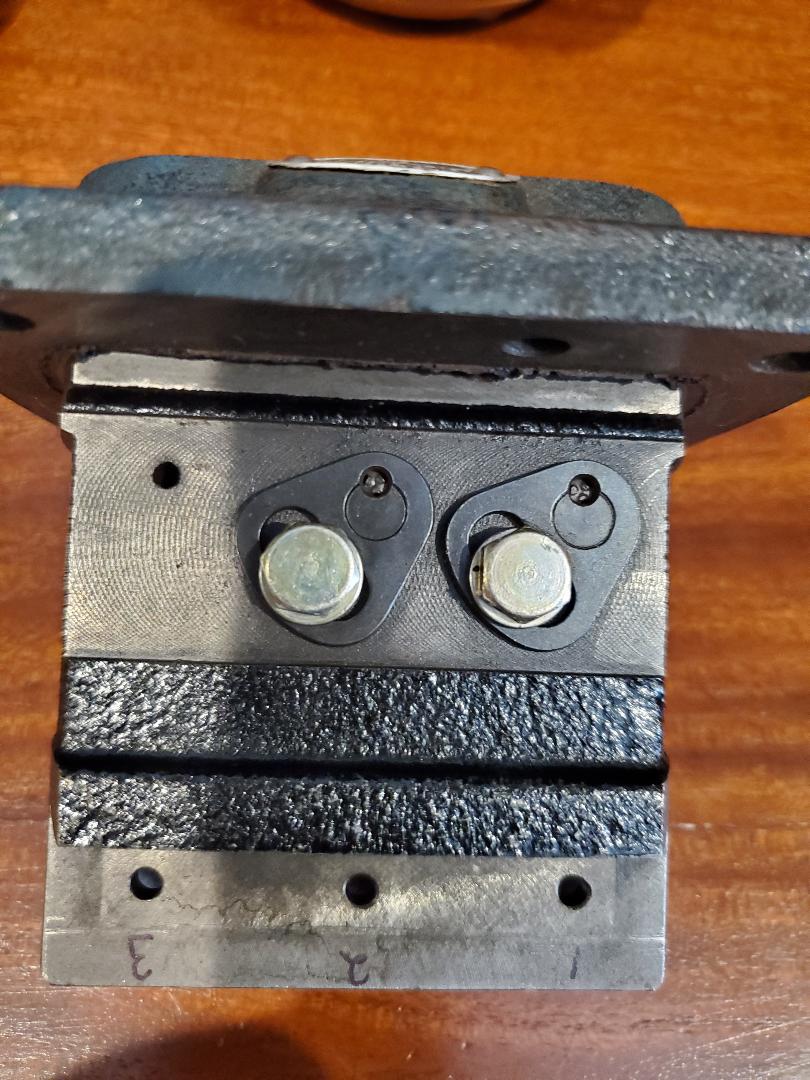

B banochris New member Equipment Kubota L245F with BushHog 1846QT Front End Loader Jun 15, 2025 14 0 1 Georgia, USA Oct 16, 2025 #22 I was inspecting the main body of the pump and noticed there is no pin in the whole to the left of the 2 adjust plates. I'm assuming that pin is to keep the element from rotating in the cylinder. Am I wrong? Attachments IP housing.jpg 148.1 KB Views: 13
North Idaho Wolfman Moderator Staff member Lifetime Member Equipment L3450DT-GST, Woods FEL, B7100 HSD, FEL, 60" SB, 743 Bobcat with V2203, and more Jun 9, 2013 34,069 9,274 113 Sandpoint, ID Oct 16, 2025 #23 No there is no pin that goes in that hole that I know of.
