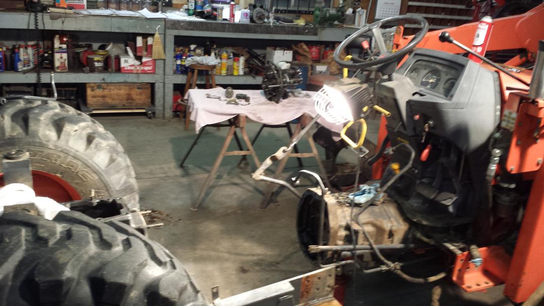

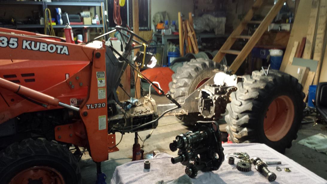

Well splitting the L35 was a way bigger job then I thought it would be. Looked like it might be pretty easy till the side cover on the transmission had to come off just to unhook the shifting fork in the rear section. So off came the ROPs the left rear tire and left sub frame.

Al Got it back together Saturday so can't take more pictures. It's a big job you need to take the left sub frame off to get the side off the GST to take a shift fork loose to split the tractor. I think the hardest part was the floor sheet metal. The problem was the arm that goes through the case and goes in to the grove in the gear was ground off so it just flopped around. The gear was fine ordered a new one to compare with the old one they were the same spec's so for $240 sent it back. To split it I just put a jack and jack stands under the front half and a floor jack under the center of the back half and rolled it apart. I would not use a come a long to put it back together as if everything is lined up it will just slide together there are several bearings to line up and could not be forced together. Make sure its on a flat concrete surface. It took me a little over 20 hrs. to do it and you will need help with the ROPs and sub frame as there heavy.

I forgot to explain why it might have happened in my opinion. The 4WD lever when pushed down to disengage will go passed the detent there fore the weight of the lever is pushing the end that goes in the grove against the side of the grove there for just grinding it off over time. Just my opinion.
