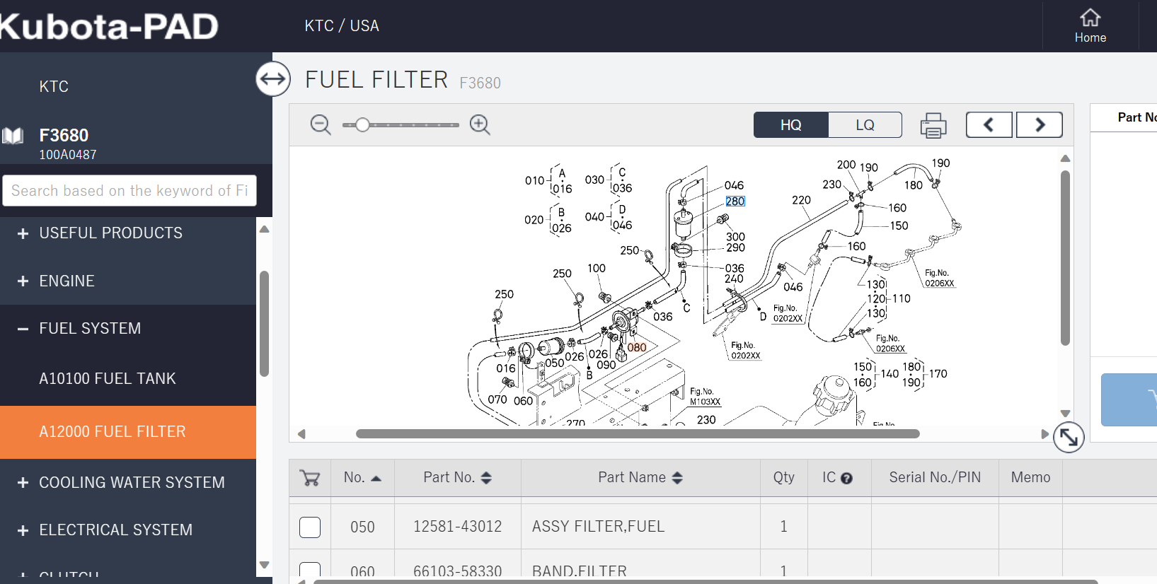

You're across the Pond? I looked up parts @ Kubota Tractor Corporation - Illustrated Parts List (kubotausa.com)
I think there's a similar parts look up for Europe. If you're smarter than me, you can adjust your VPN accordingly to access USA site?!?
I see 12581-43012. There's 2. One is between tank and electric lift pump and second should be near the injection pump.
Here's a screenshot with part number. Both are the same #.

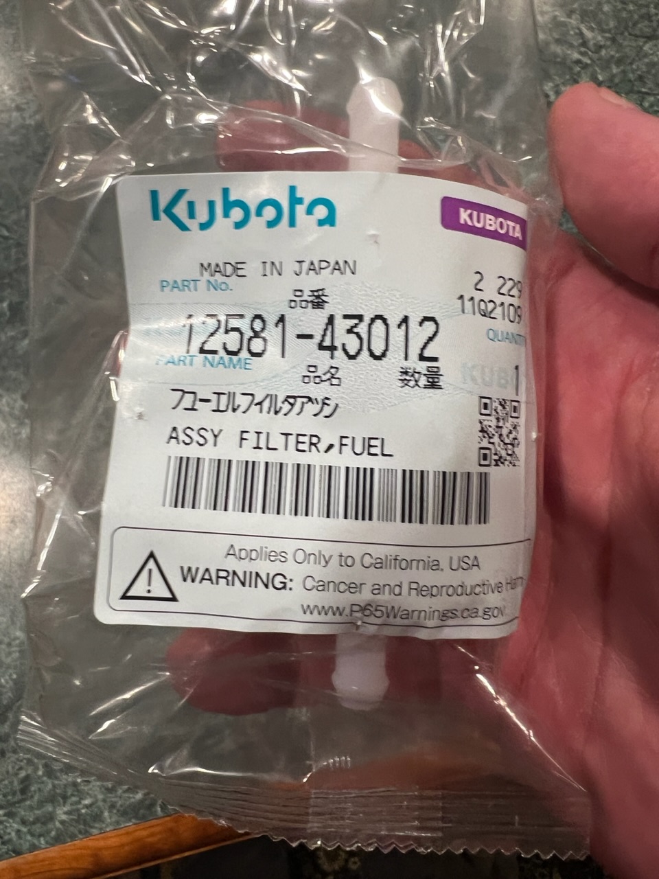

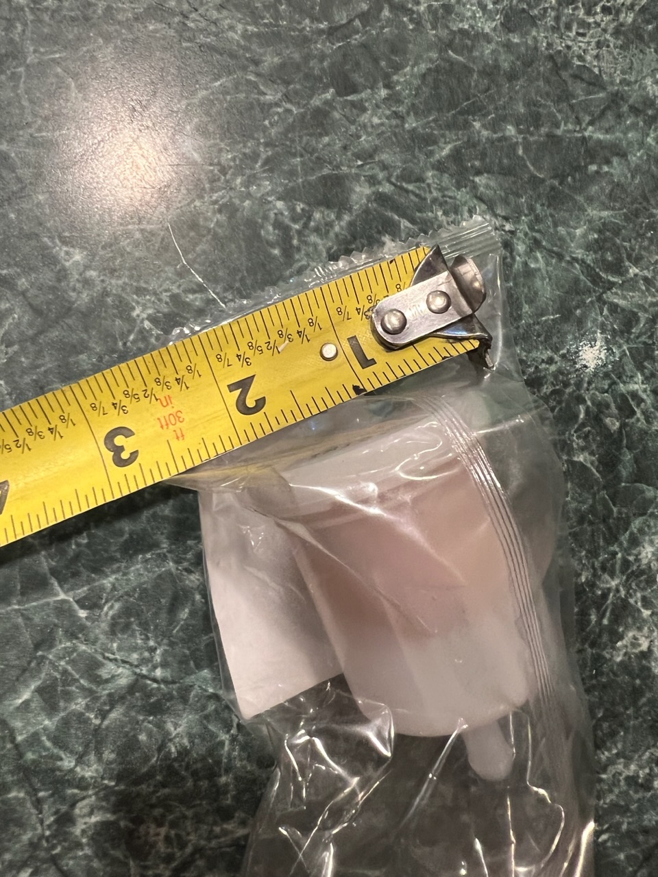

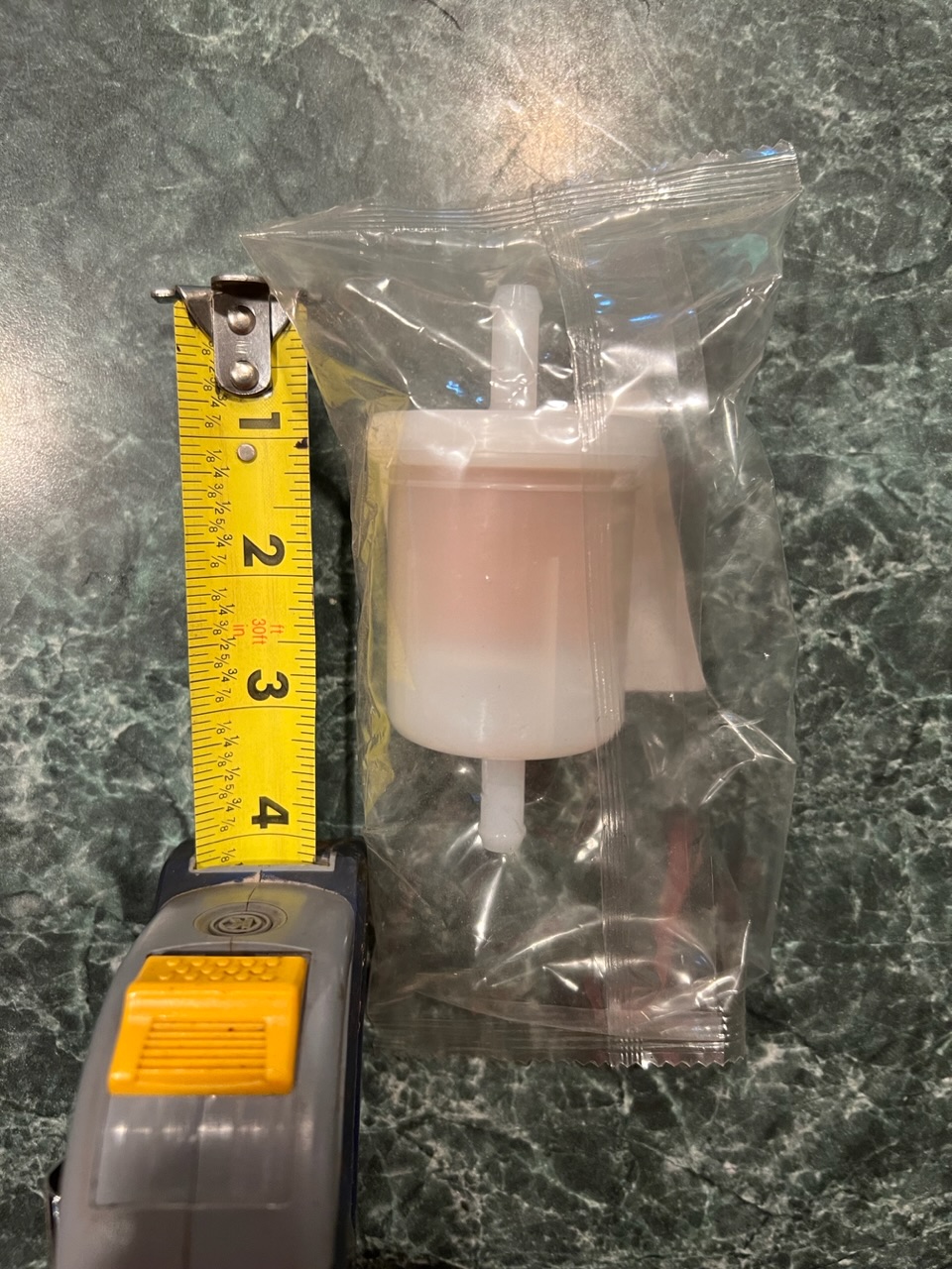

That's the same part # as my BX2360. I'll try to get a photo with measurement reference.
Looks about 4” long and cap is about 2”.

Those will work. They are just fuel filters. One is located on right side of radiator support. Other is under floor pan just behind the front tire on same side.

He got the right ones. For whatever reason the F’s used a larger filter. I’ve been getting bulk of the part # you have and running them in our 4 F mowers with no problems, other than the clamp doesn’t clamp them.

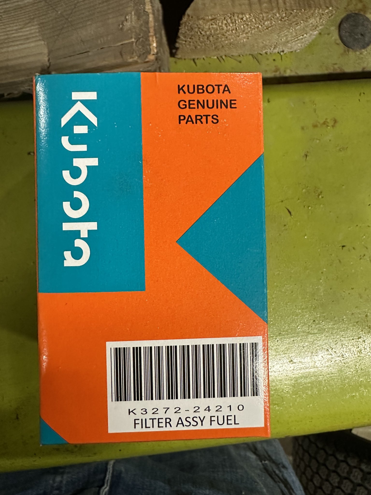

@Th02msn here are the filter locations. The one under the floor pan should be clamped to that little bar poking up to the left of the filter. Don’t mind the ratchet strap… axle fell out of this one today.
