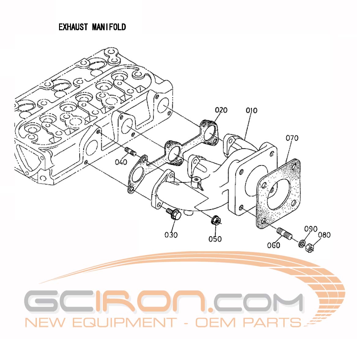

First up, exhaust manifold part number 19462-12312
Listed often as Kubota original or "default", if you so will, exhaust manifold.
You can see it here: http://www.gcironparts.com/GCIronPartsSelection.asp

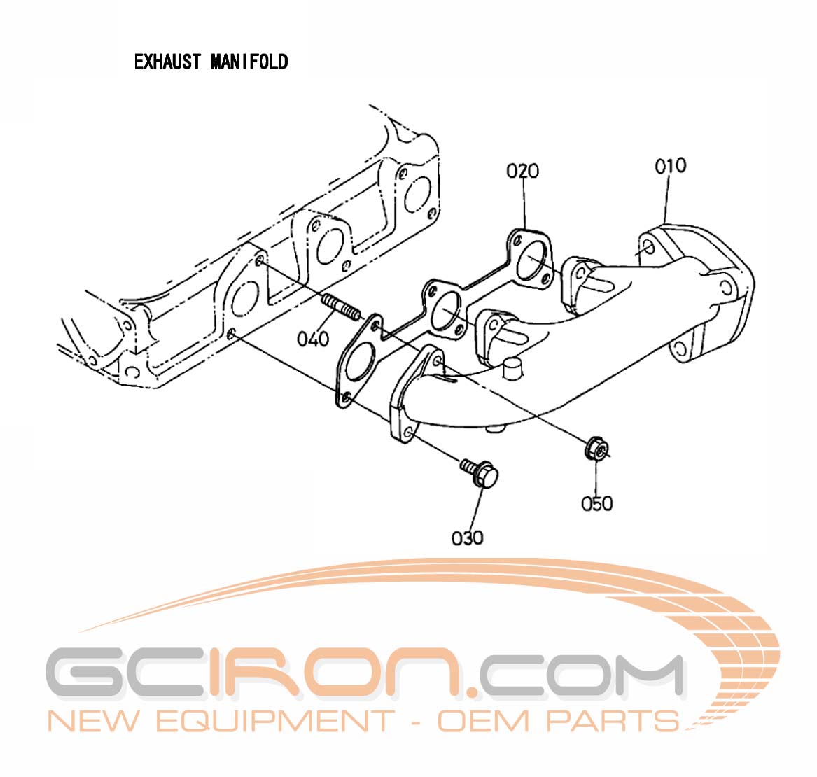

Similar, but somehow diffirent apparently, exhaust manifold part number 15861-12313
And the third one, isn't even listen for the D722, but for the L2000 tractor with the D1100 engine. Exhaust manifold part number 15321-12313
If the exhaust ports and flange bolts line up I really can't see any problems with it.

This is the manifold I had. It will collide with the gearshift linkage under the steering shaft that comes down from the instrumentpanel. I can't put an angle on it either, and cutting it open is out of the question.
Here's the manifold I've been checking out. Part number: KU-15861
It looks like this one. Part number: KU-19462
But I think I've figured out the differense, one of them is missing the bosses for the alternator heatshield. No differense in the exhaust exit flange height like I thought earlier. But both styles have this hump sticking up. So I can't use this either because of this...

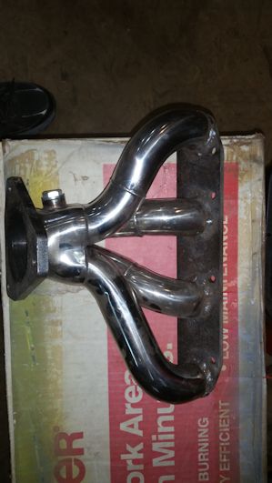

What you need is something like this!
This one is off of a V2203 that was going to go in a jeep.
If anyone needs one of these give me a shout! ;)
Something like this is fairly cheap to get built.
