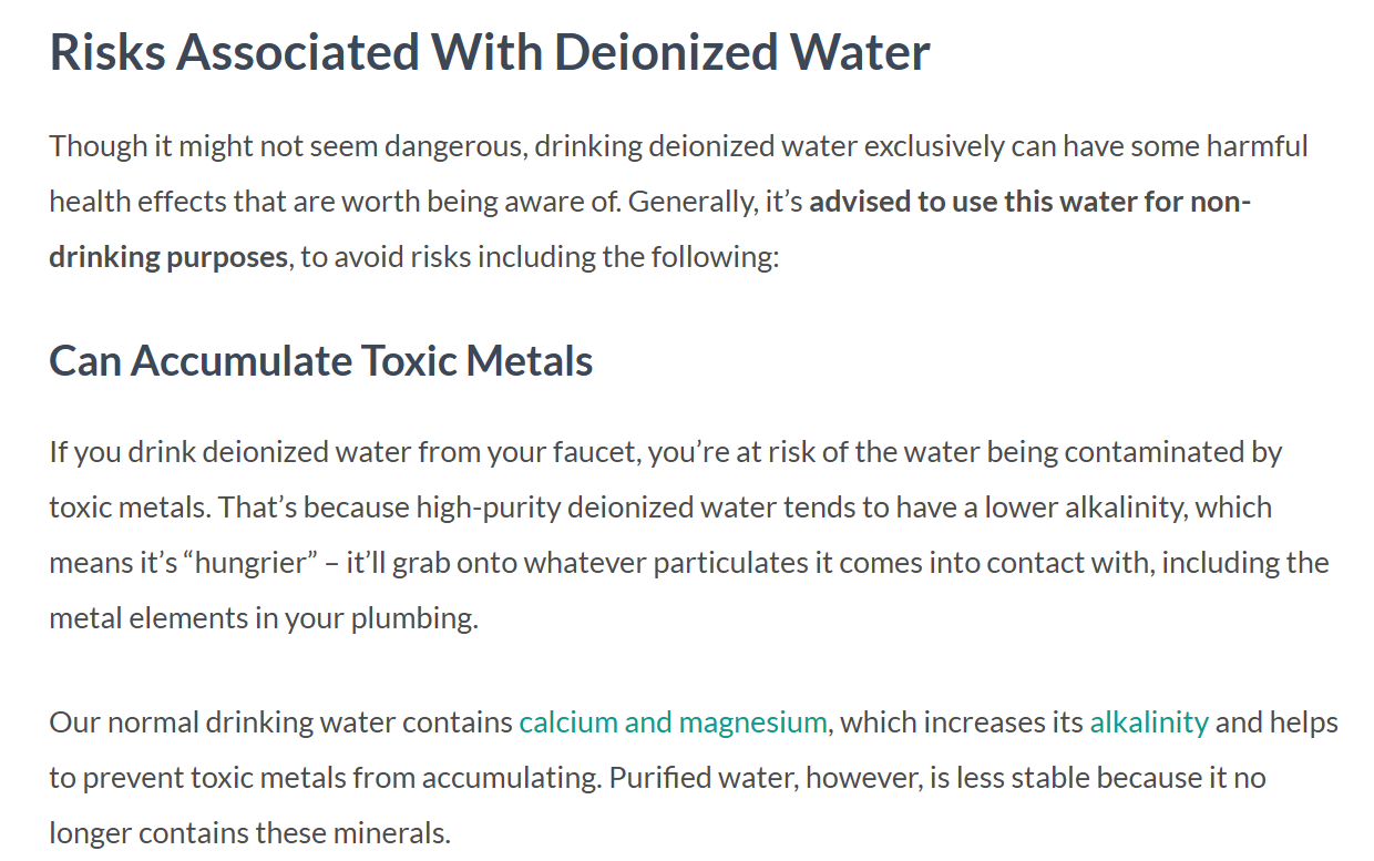

I've always used distilled for everything. Curious if anyone has one of these deionizers.
I looked around and found some articles:
Doesn't seem like drinking it is a good idea eh?
