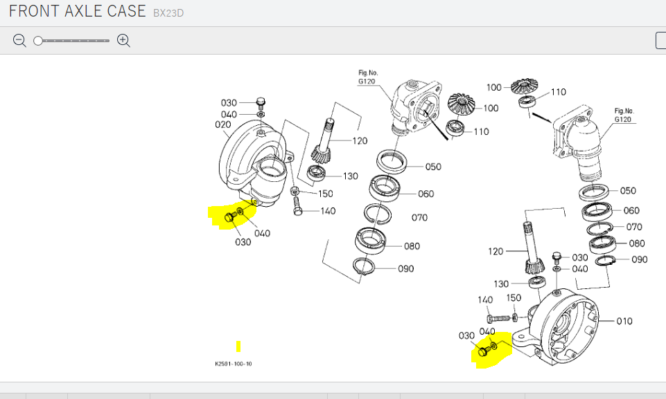

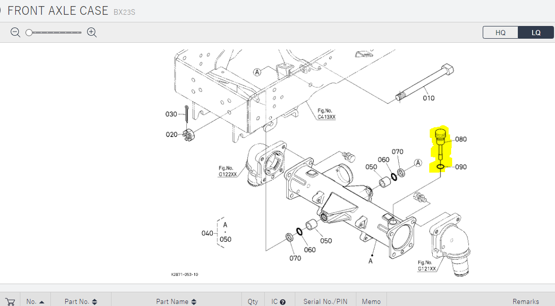

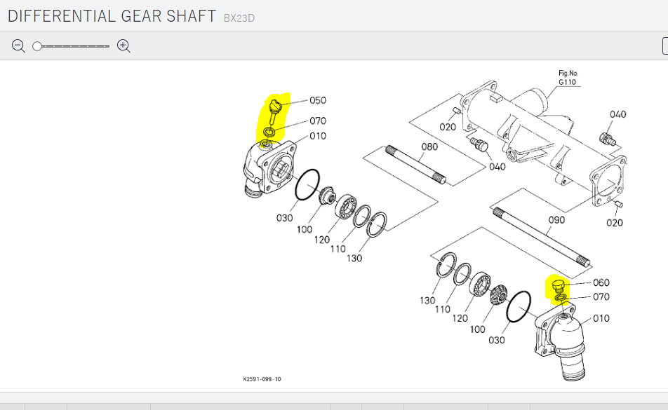

First do you have a BX23S or the older BX23D?
Water settles and freezes in the gear cases not the differential.
And locks up the gears in the cases.
DO NOT FORCE THEM TO MOVE!
Both have gear case drains in the same places.
open the plugs and see if you have water in the cases.
If you pull the plug and nothing comes out, you need to heat the cases.
Replace with new UDT or SUDT2.
BX23D Dipstick and fill
BX23S Dipstick and fill.
Thank you for this!! I am not sure? Says BX23MLB on one part of the tractor. Little sub compact with the mower...
