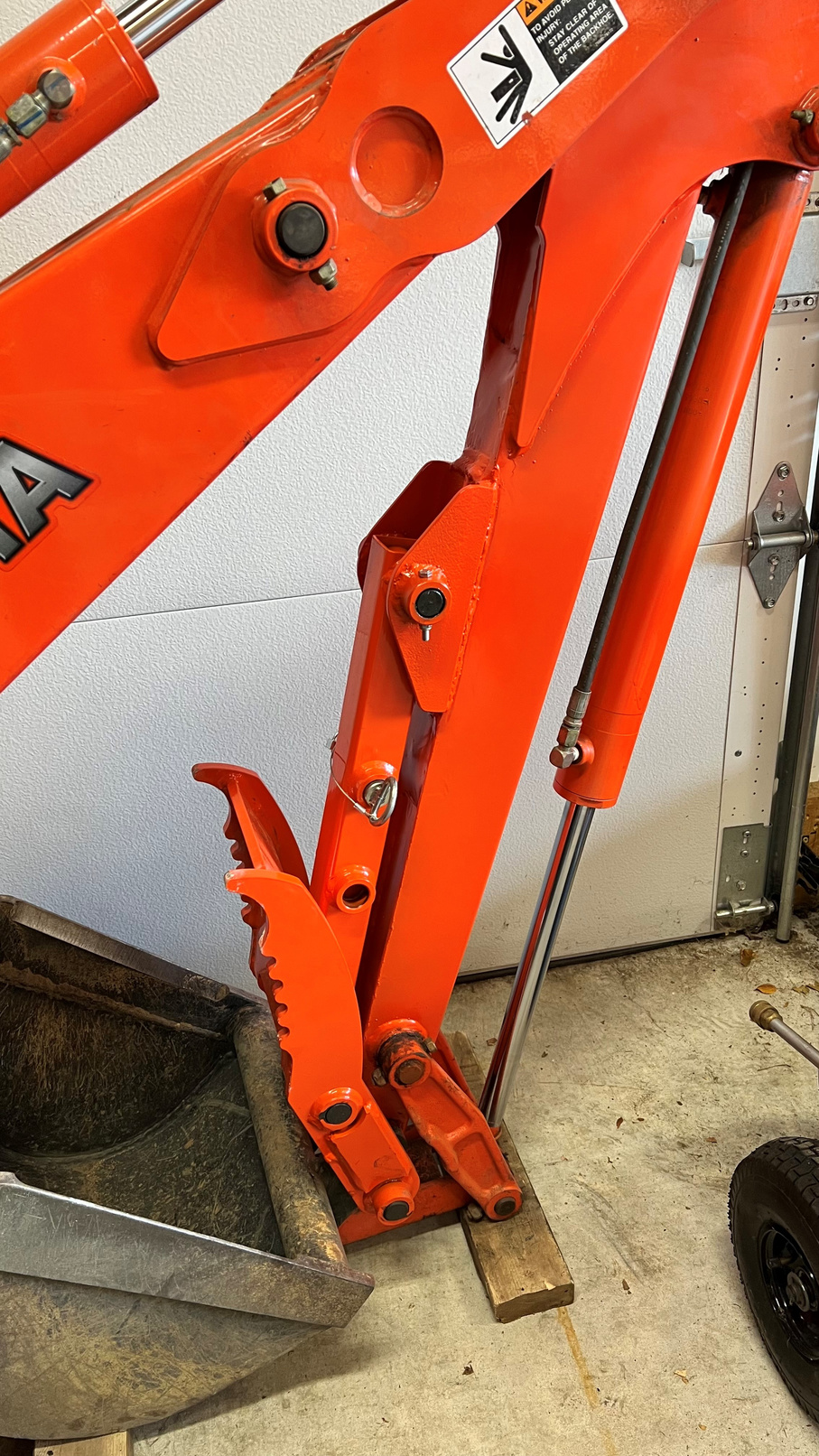

So I ended up ordering this one today, The Amazon one seemed to be hit ot miss with fitment and I don't really want to weld it on.

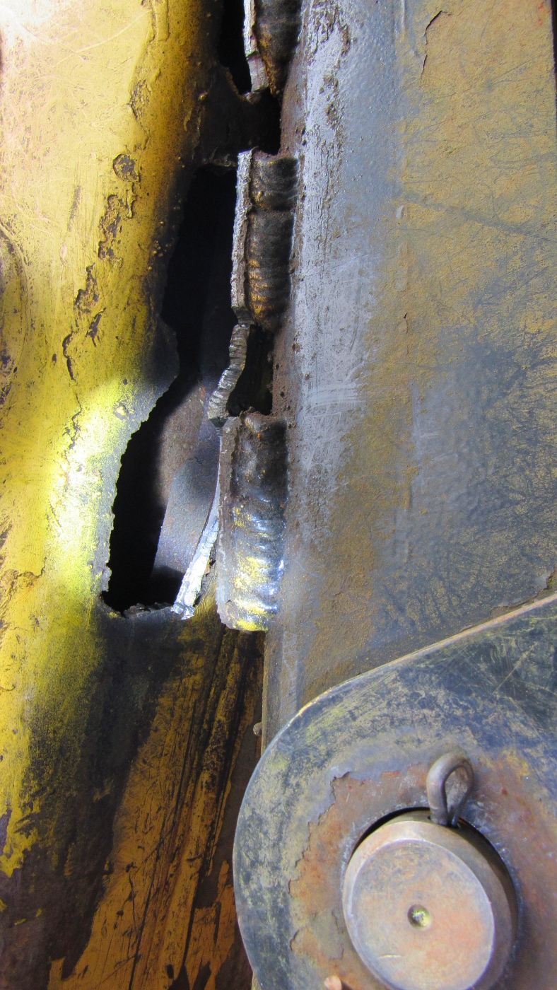

Understand that any add on thumb is capable of applying full digging force to an area of the crowd arm that wasn't designed to take it.
That said they are extremely useful. I put a Titan weld on thumb on my full size backhoe and just broke it after 8 years. My welds held up okay but it ripped the metal open on the crowd arm. I should have reinforced the crowd arm which I will do after repairs. I have to cut the thumb off and straighten and weld up the arm metal first. This machine has over 10,000 lbs of digging force though.

I got the Thumb installed, it took less then 5 Mins, I have not tried it yet but it looks good on the machine lol. Fed ex did a number on the box and packaging, I called BX and they were helpful and it appears I have all of the parts that I should.
