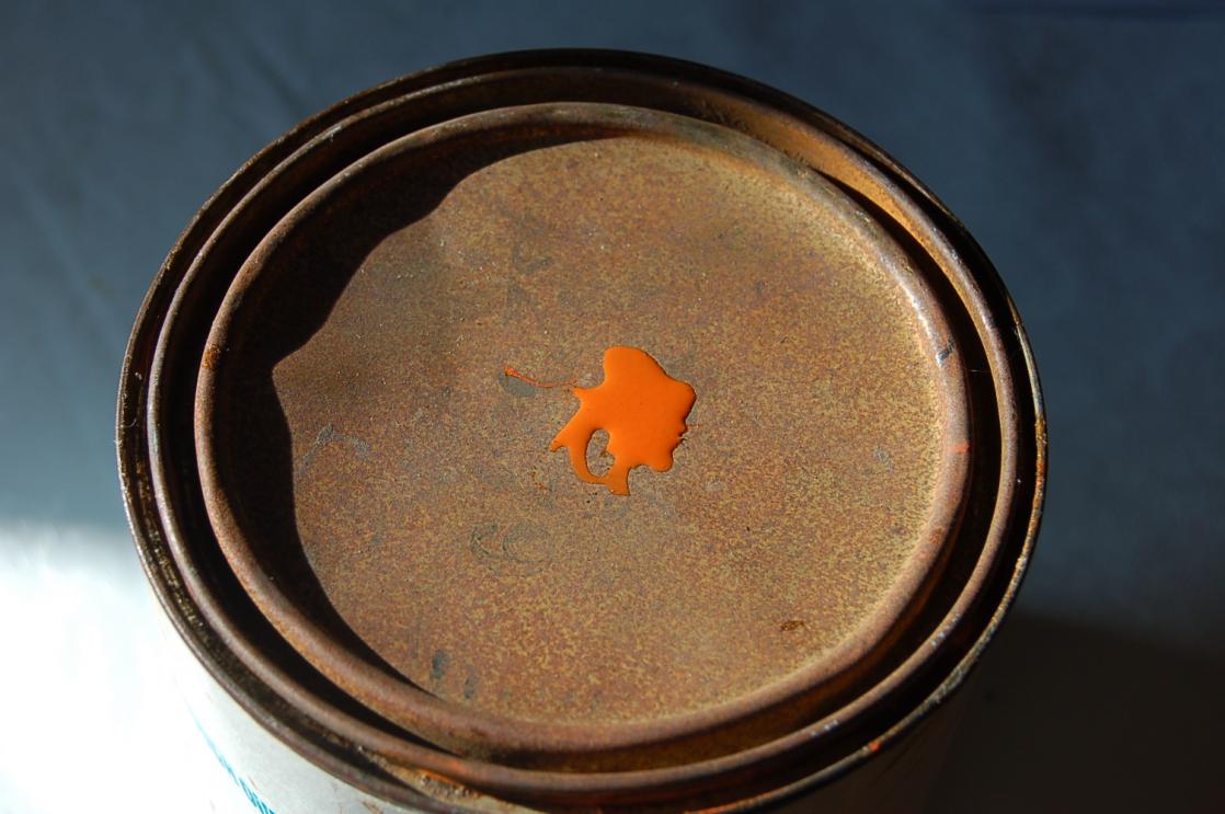

A few weeks ago I was at the dealer picking up some parts and asked about a quart of Blue Paint,
computer showed none but he poked around and found an OLD quart. Must have been "at least 10 years old, thats when we moved here".
He gave it to me for half price / $16.00, opened it today, irregardless of what the label says. It was Orange! and had a cam bearing in the can!
(I am guessing that is not normal!)

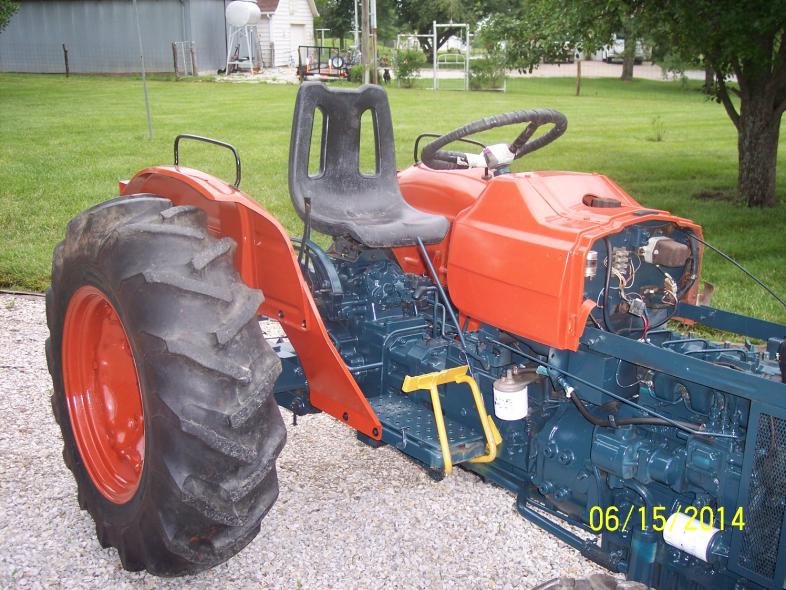

Bill, I am not a painter! I'd rather take a beating then paint anything.
When I was working on my L305 I had no option but to do something. I have a friend who is a retired auto body man and still works in his shop at home. I asked him for some coaching.
Here's what he told me to do: "4 parts paint to 1 part hardener. Splash of reducer so it will flow through the gun."
I do have a nice gun. So I got the hardener at the local farm store. About a 1 pt. can cost about $15. Had compatible reducer.
I actually sprayed the wheels first (for practice) then a few days later I did the blue.
Here's a couple of pictures.
billrigsby
Mar 17, 2015
1,021
208
Florissant CO USA 8213'
www.facebook.com
That looks real nice, I also have all the painting stuff, including reducer and hardner.
Guess that is the route I will go. I do not see a left side pic, is the clutch pedal blue?
Is there two different blues, or is everything the same, can not tell ( phone )?
