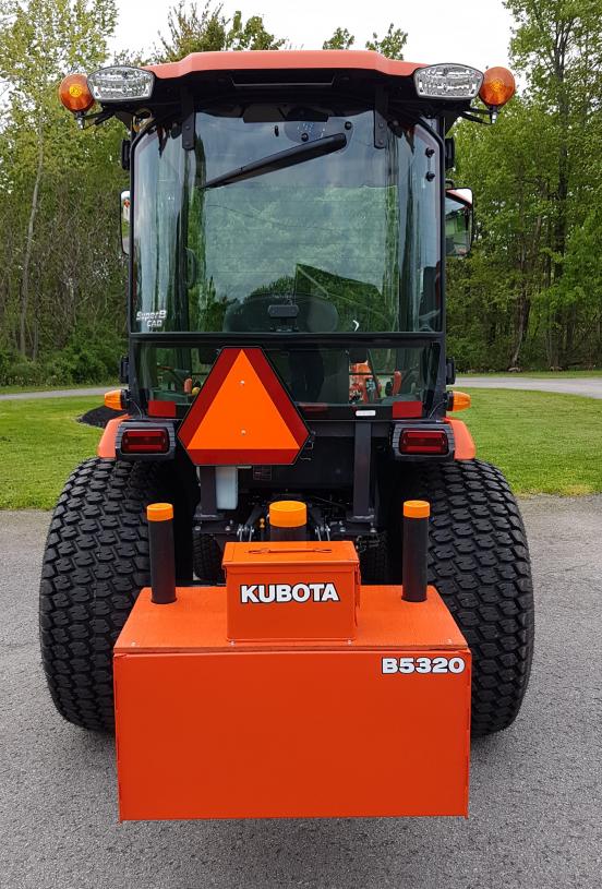

Kubota ballast box to fit your tractor is B5320 If you have a loader one should have came with it.

There are 2, definitely get the B5320. I bought the B8160 and sold it due to not fitting a quick hitch. I wish I new there was 2 :confused:
