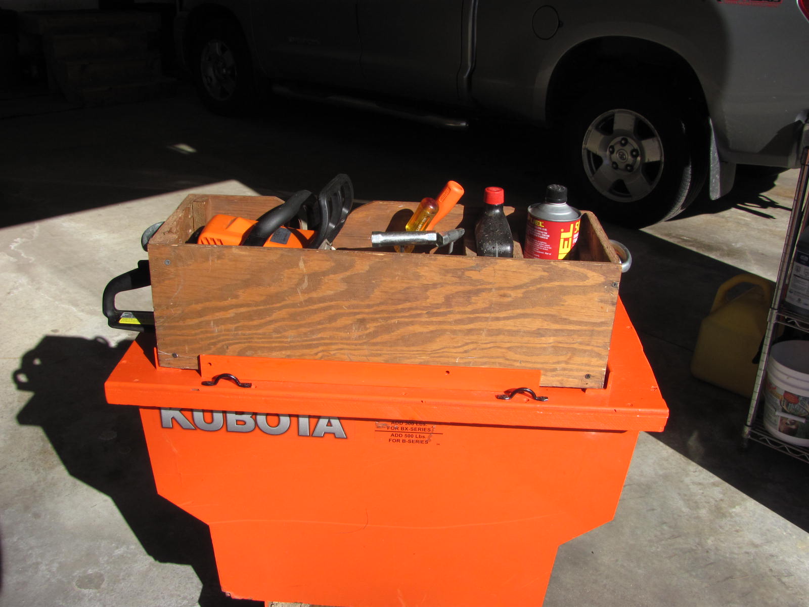

I saw a short video of a fellow that built a cover for his ballast box. I liked
his idea and decided to expand on it.

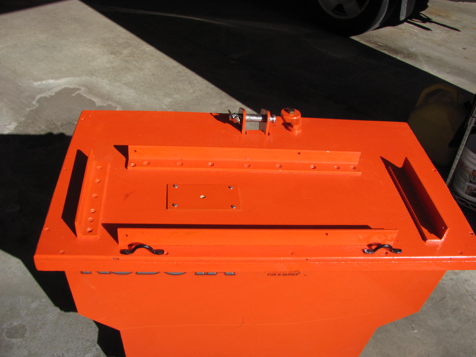

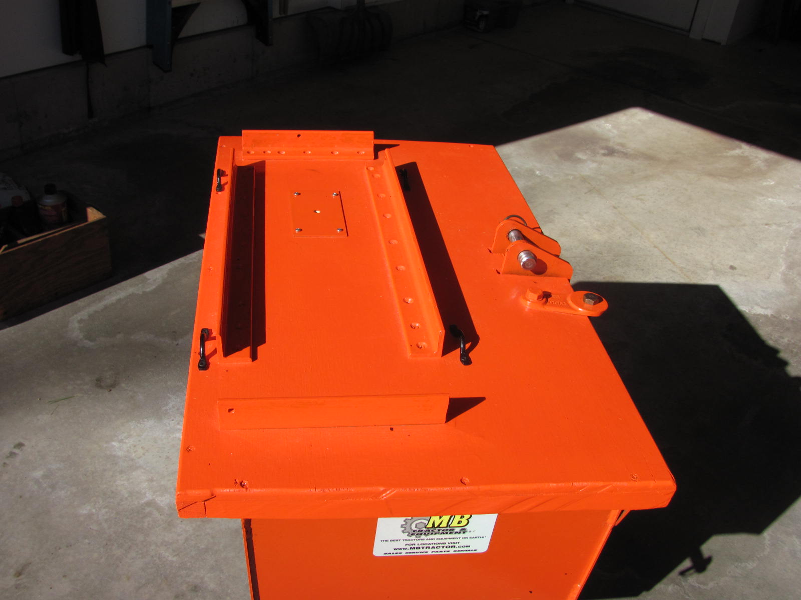

The cover consist of 3/8 inch plywood with one inch sides. It fits on the top of the
ballast box and slides in to where the 3pt quick hitch with a cutout. I found some
used aluminum and secured that to the top of the cover, with 4 tie downs locations
for my Chain saw Box
I built this box several years ago, to carry the chain saw, chain oil, Tru fuel gas, and
all the tools I would need to do simple adjustments. I just adapted it for use when
using my tractor.
The chain saw box locks into place on the cover. it does not interfere with lifting
and lowering of the ballast box. Items like a jacket, boots, can be added inside the
ballast box, and remain dry even in rain. The Chain saw box on top is and easy lift
off when not needed, and secured in place when needed with simple rubber or
stretch bungies. You will also see a drop in bolt to the right of the 3pt pin which
hold the cover from sliding back and off the ballast box.

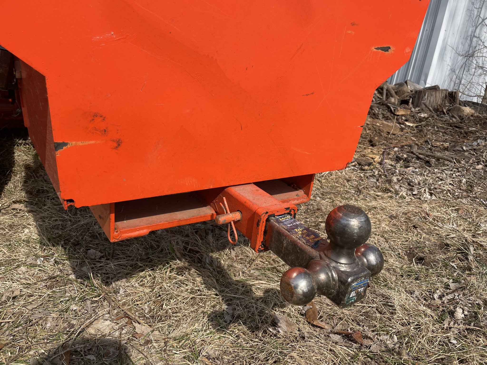

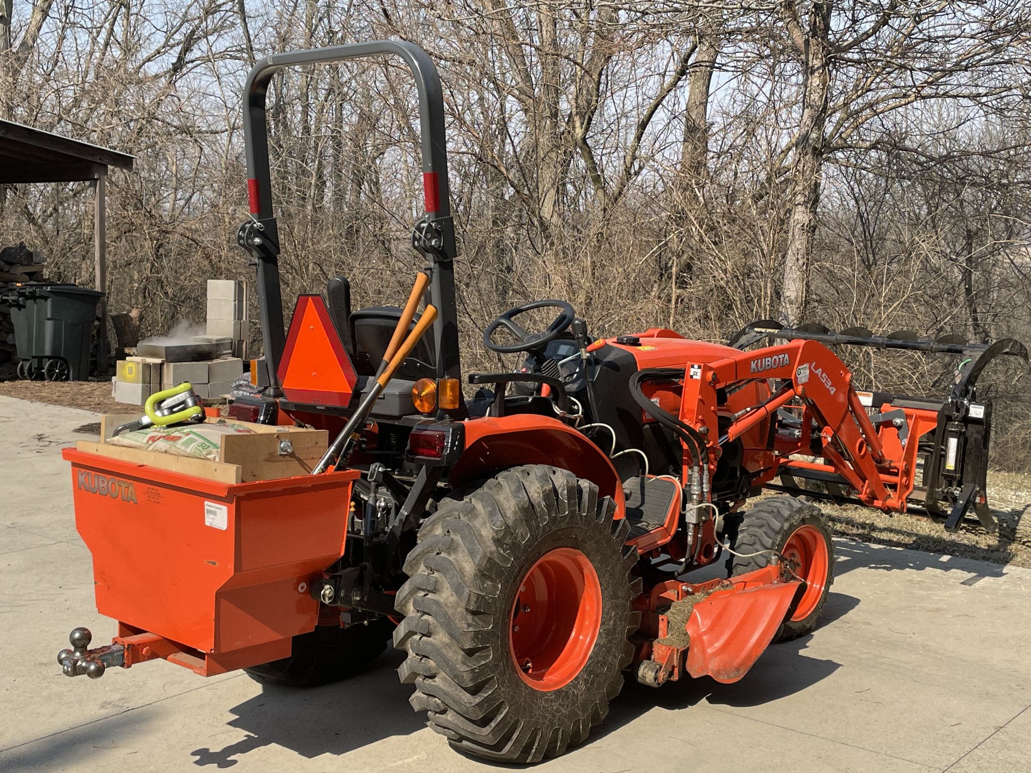

I think I mentioned on another thread I had the same one….here is are are some old previous pics…the trailer hitch really increased its flexibility for me. The step side that original was helpful as it allowed the box to not set far back off the machine…however as my machine(s) changed, that step side ultimately became the reason I sold / upgraded.
