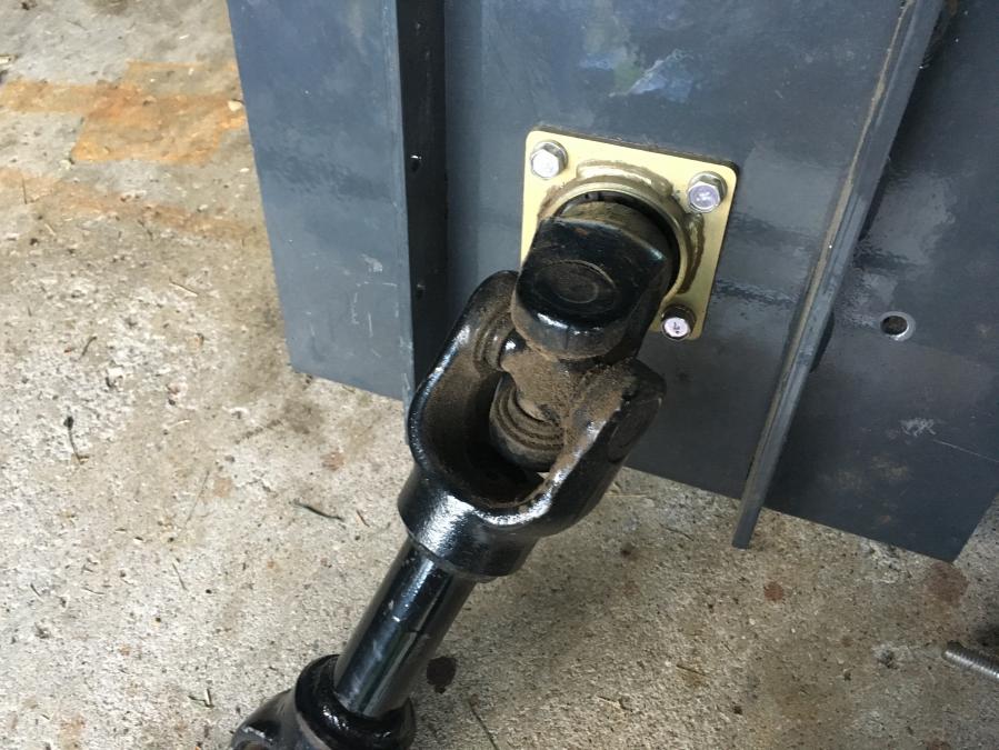

I did a bit of research today on the GCK60-76BA grass catcher, and it turns out that Kubota made three different versions with either a 5", 6" or 9" drive pulley. I have the 6" pulley. All units have a 4.5" driven pulley and the fan pulleys are 9" and 4.5". I tore the thing apart tonight and pulled the 6" pulley and will replace that with a 9" and I'm also thinking about changing the 4.5" driven pulley to a 3" which should give me a fan speed of about 3240 rpm (according to the online calculator) are my calculations correct and is that too fast?
One more question, the pto shaft is welded together and pressed on the driven pulley shaft. I want to replace this with a slide shaft to make it easier to install on the tractor pto but I'm not sure what to look for, can someone give me some info on what I need?

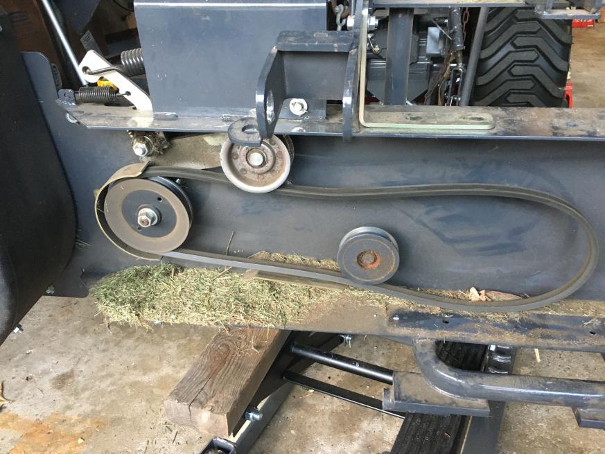

Sorry for the confusion- yes, two drive belts. The image with two pulleys is the fan, 9" and 4.5"
7,659
2,967
I too am confused about the belting and sheave diameters...
Please measure the outer diameter of each sheave.
Sheave 1 is the one driven by the PTO shaft, then sheave 2 is driven by the belt from sheave 1? Then sheave 3 is attached to the same shaft as sheave 2? Then sheave 4 is on the fan shaft and driven by belt from sheave 3?

Your drawing is correct, sorry for the confusion on my end.
Pulley #1 is 6" I want to change this to 9" like the GCK60-26BX
Pulley #2 is 4.5"
Pulley #3 is 9"
Pulley #4 is 4.5"

Yeah the speed seems a little low to me too.
Now for another what if-instead of changing the 6" to 9", how about changing both 4.5" to 3" ? This would give me something around 3,240 which is on par with the other brand you mentioned and the pulleys are available locally and cheaper.
Thanks for everyones help and I'll post a link to a video when this is completed

Just a quick update. I replaced the 6" drive pulley with a 9" and a new belt.
Today was the first time I had a chance to use the vac and what a difference. The first thing I noticed was the very loud whirring sound. I always wear earmuffs but I'm probably gonna wear earplugs as well. Anyway, the thing sucks like crazy. I was able to cut thick grass and weeds moving pretty quickly without any clogs! I am very happy :D
