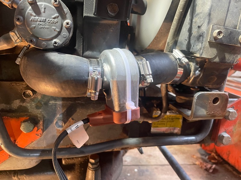

OK after some research and forum searching I have installed a coolant heater in the lower radiator hose of my B7100HST. This is a 600 watt heater with 1.25 inch diameter hose connections. (There are many such heaters that are 1.5 inch diameter and many of the newer Kubota apparently use those. )
Here's what it looks like. Note: Later I rotated it to position the electrical connector ABOVE it.:

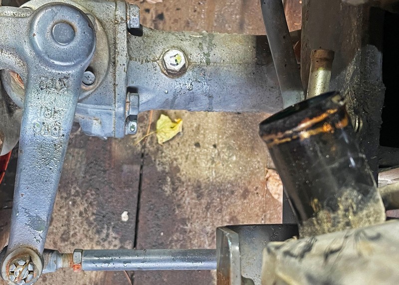

After draining the coolant from the front-of-radiator drain valve, I carefully pried with screwdrivers and hand rotated and finally got the OLD hoses off.. I was worried about stress on the radiator connections.. The lower hose connections are a little unusual. The Radiator connection has quite an offset to clear the engine:
The other end is on this 'pipe' which appears to be screwed into the block:

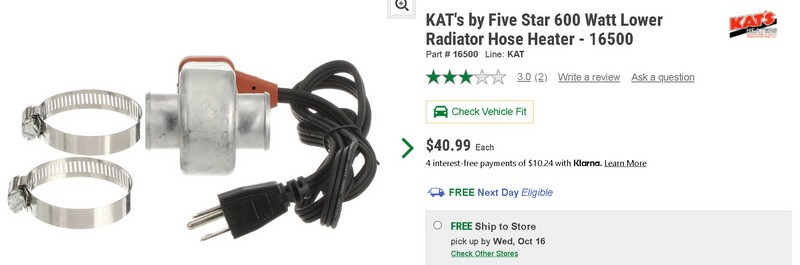

The heater itself looks like this: (This from O'reilly's, but most auto parts places have these..) Amazon has it here for twice as much .
After holding the parts up to see what would fit, I marked and cut the hose. I took out a 1.25 inch section which is the heater width.
Later I thought 4.0 inches would be better.. Here it is with the electrical connection rotated below. (CHANGED later to UP)
Hose clamps tight and time to refill:
I put in 4.5 Qt and it was ALMOST full:
Another 3 or 4 Oz and it was overflowing. Here's the (NEW UPDATED) view:
I ran the engine for 30 mins to check for leaks. A little coolant came out the overflow as expected.. Left it all day until engine head and radiator were down to 48F. (Infrared scan thermometer). Plugged in the heater and its metal case quickly got hot to the touch. I was a little concerned when it got up to 180F pretty soon. But then it stabilized there or lower. It is supposed to have thermostatic control. It took a Long time to start heating the radiator and engine by convection. But after an hour it took the engine head from 48F to 85F. Radiator top was same.

The electrical connection should be to the side or the top.
Do not leave it plugged in for more than an hour if you want it to last.
Yes, usually agree. I don't think the side panel will go on with it to the side, and I think the top position would hit the upper block. I'll get a better look with the side panel back on.. Can probably rotate it with clamps backed off and no pressure in system.. without loosing coolant. Need to route and secure the AC wiring. Probably will have battery maintainer and battery warmer all on same external short AC dongle.
***UPDATE*** Wolf, NotToMySurprise you were Right. I loosened the clamps a bit and rotated it so electrical connection is UP. It just fit under the air cleaner bracket after all. Thanks!
