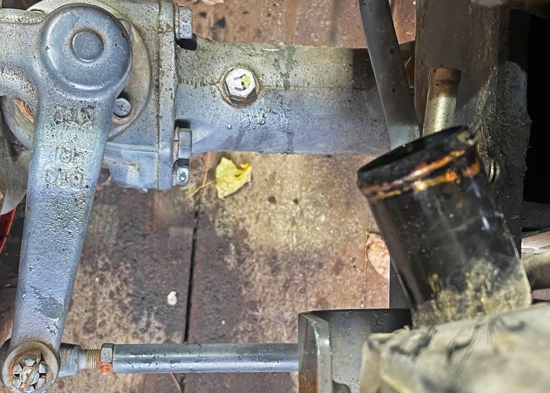

After draining the coolant from the front-of-radiator drain valve, I carefully pried with screwdrivers and hand rotated and finally got the OLD hoses off.. I was worried about stress on the radiator connections.. The lower hose connections are a little unusual. The Radiator connection has quite an offset to clear the engine:
The other end is on this 'pipe' which appears to be screwed into the block:

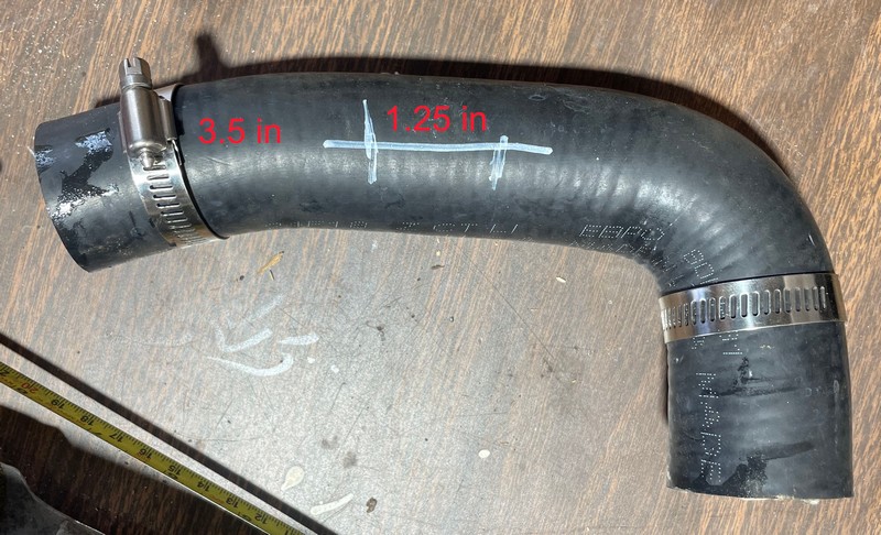

After holding the parts up to see what would fit, I marked and cut the hose. I took out a 1.25 inch section which is the heater width.
Later I thought 4.0 inches would be better.. Here it is with the electrical connection rotated below. (CHANGED later to UP)

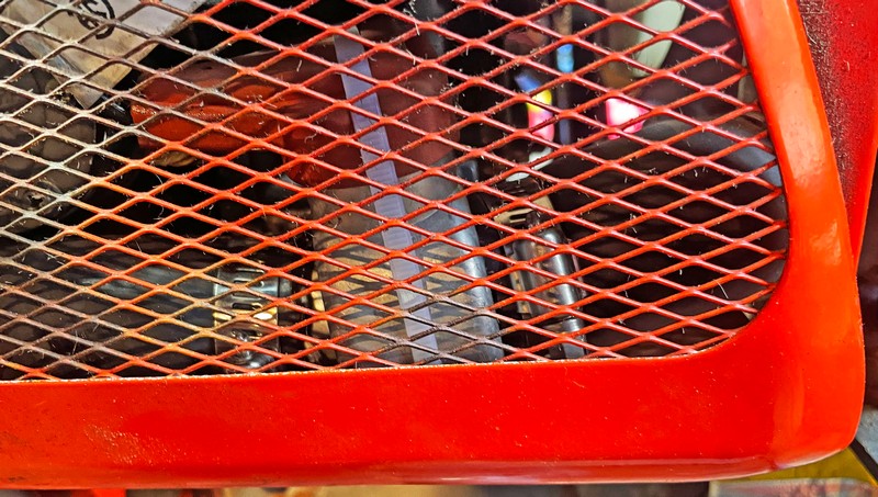

I ran the engine for 30 mins to check for leaks. A little coolant came out the overflow as expected.. Left it all day until engine head and radiator were down to 48F. (Infrared scan thermometer). Plugged in the heater and its metal case quickly got hot to the touch. I was a little concerned when it got up to 180F pretty soon. But then it stabilized there or lower. It is supposed to have thermostatic control. It took a Long time to start heating the radiator and engine by convection. But after an hour it took the engine head from 48F to 85F. Radiator top was same.
