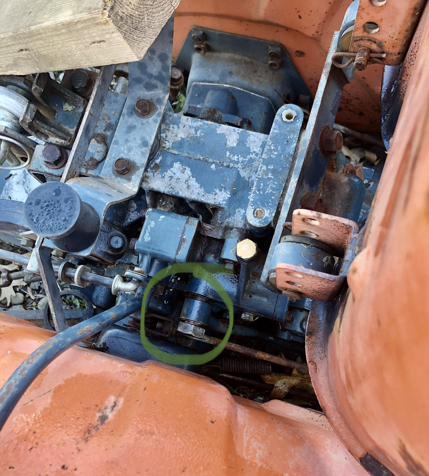

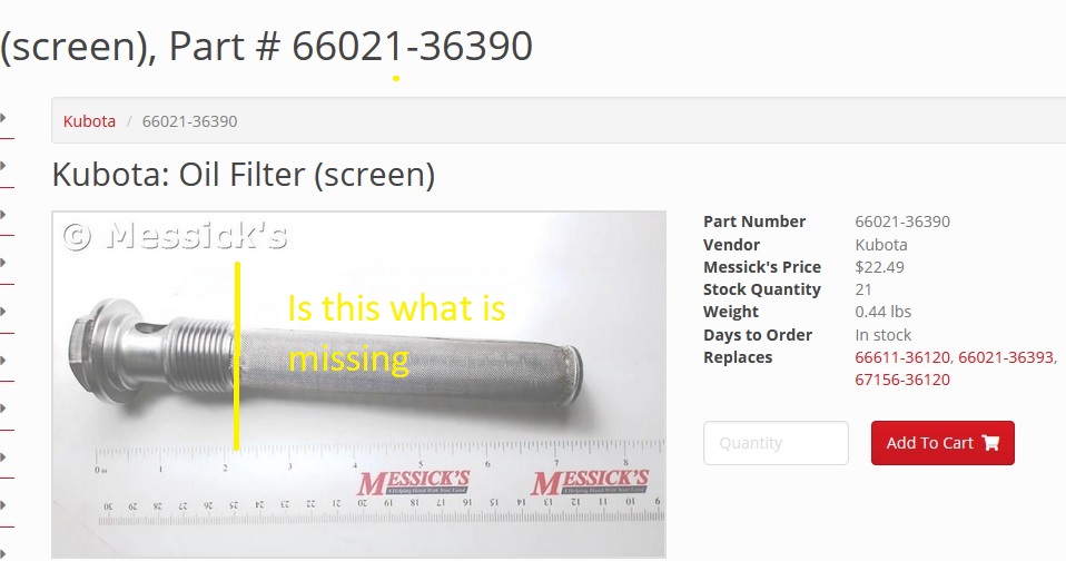

1978ish B7100. Rear lift seems to have gotten weak. So I removed the bolt which appears to be the 3 point oil filter part #66611-36120 but there is no screen. So is it possible it fell off? Would that contribute to 3 point losing power?

The part number has changed.
It is more likely that if your hydraulic system has been running without a screen, the pump has been ingesting small particles leading to accelerated wear.

Yes. The screen is gone.

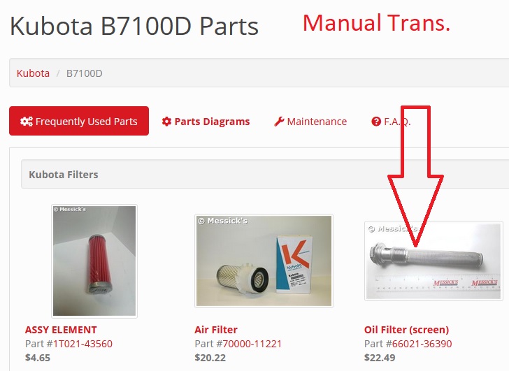

Does the B7100 have this screen? I thought only the HST models do. I havent had my B7500D for long, but I think only the HST's have that screen, not the manuals.

Well maybe mine does not have a screen after all. Photo of what I thought was it. I searched around and found another which is on bottom of gearbox.

Well maybe mine does not have a screen after all. Photo of what I thought was it. I searched around and found another which is on bottom of gearbox. View attachment 54485
The fitting that you have circled does not have the screen. It is down below.
They all have the suction screen, manual trans or HST. The pump suction is located low in the transmission so it does not suck air.
