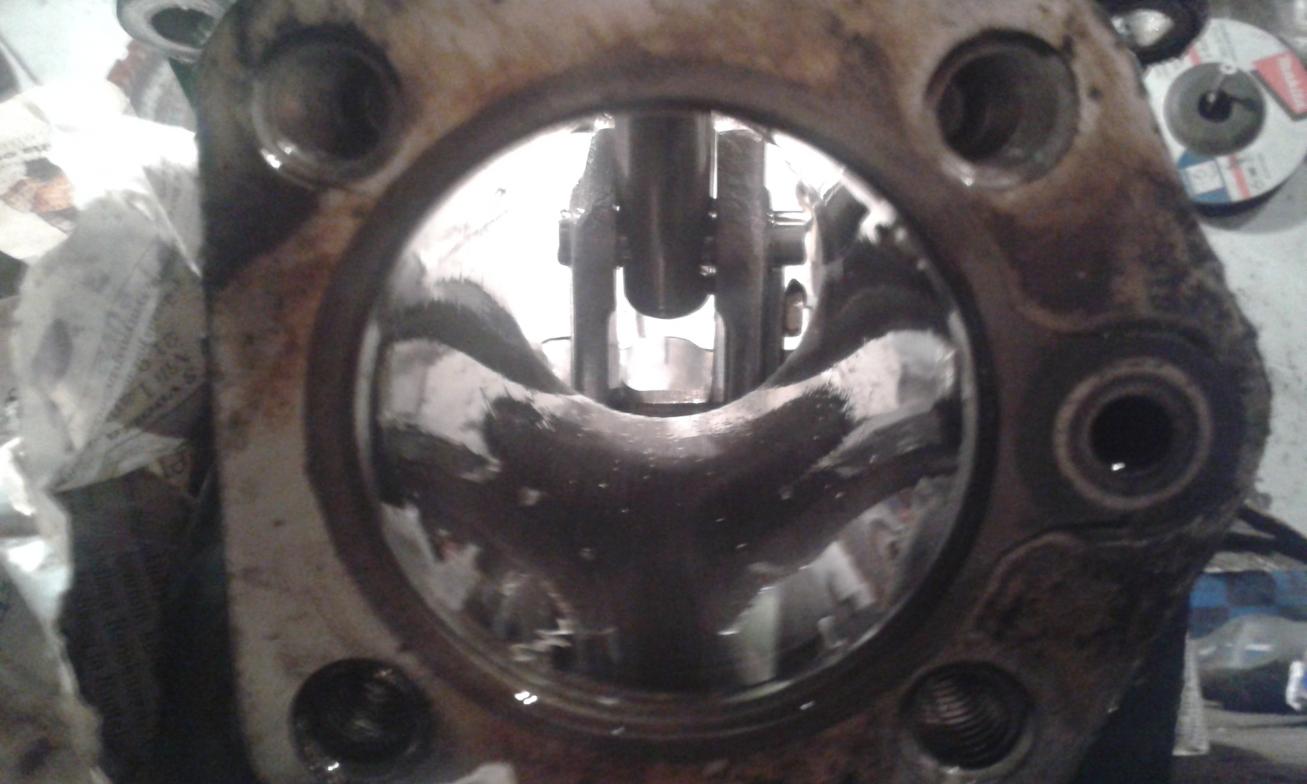

the exhaust pipe to suck and blow when trying start. Valves?
If it's doing what I think your saying (moving air in and out of the exhaust pipe) yes it's got a valve or valves out of adjustment and /or a problem with the valve train.

As "ford-9in" mentioned it could be the adjustments for the compression release.
Definitely check the pump timing too, not the gears but the mark on the flywheel and fuel starting to be pumped that's adjusted with the shims under the pump:D

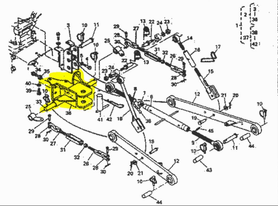

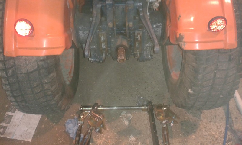

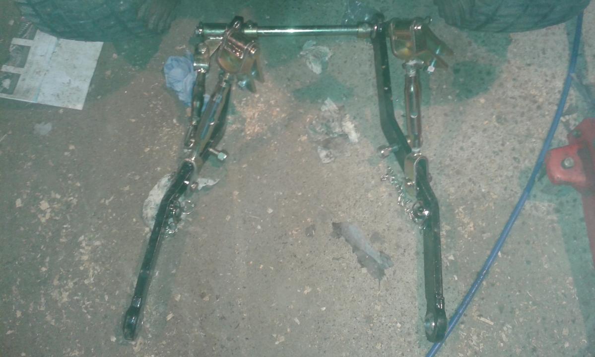

Hello again! I ordered the 3-point hitch set but how do I get it put in? Could someone take a photo of your Kubota 3-point hitch in place ??
What part i need?
I prepare the parts of myself ..
Thanks :)
(and again bad english, google translator..)
-Esa
31,438
7,255
Esa,
Your not going to like this answer but you need a major part, it's the hitch assembly, it also has the rod for the lower arms on it.
If your not able to find it you could make that part as it is just steel and not cast.

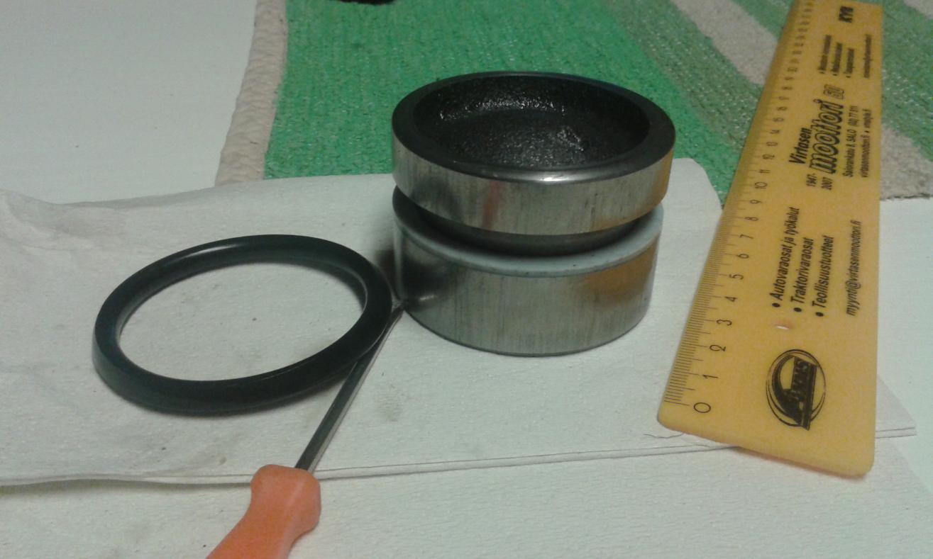

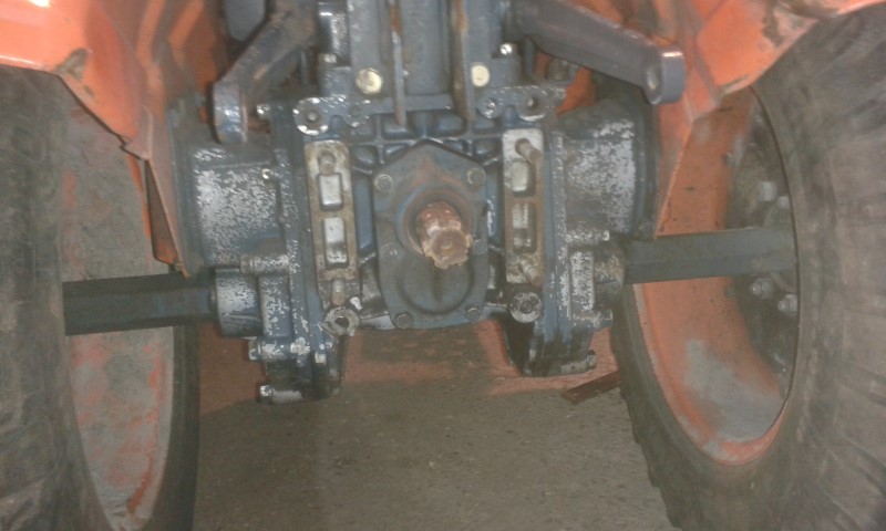

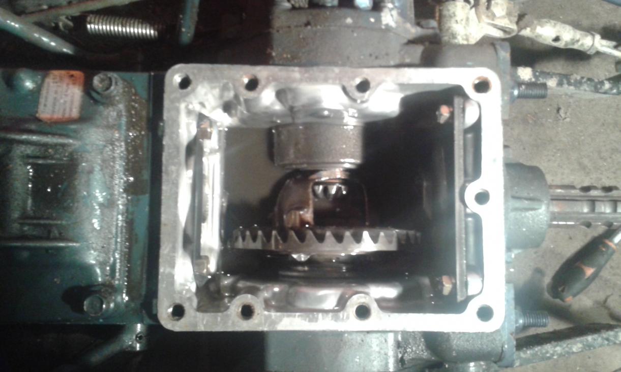

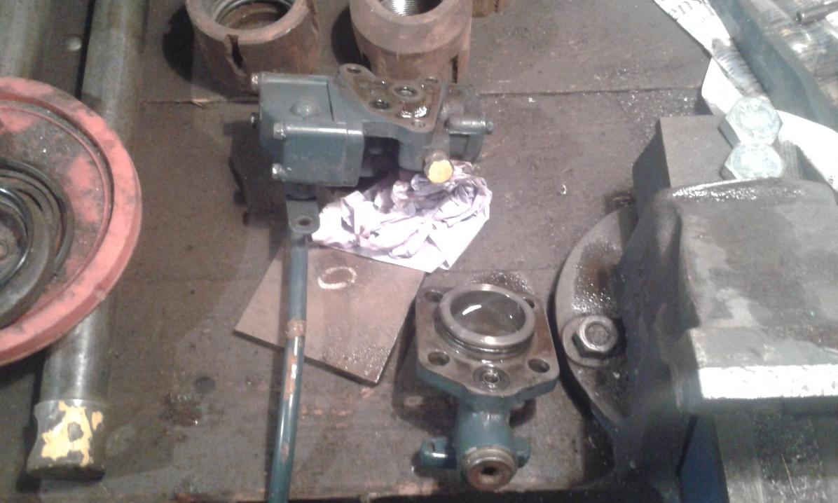

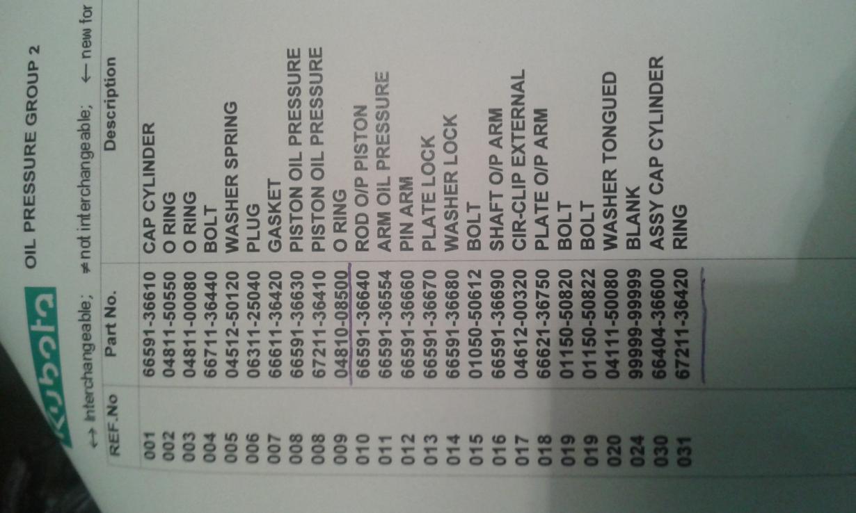

Hello again! My 3-point hitch work now, but it going to slow down. Is the valve 's wrong ? Can someone post a picture of the rear inside? Google translator.. I hope you understood :)
-Esa
ShaunBlake
B6100D; B219; Piranha bar; Hodge stabilizers; Filled Ag rears; R322T w/48" deck
Dec 21, 2014
899
82
Sugar Hill -- next door to Buford, GA
The 3-point hitch (we call it "3PH") does go down pretty slowly. The pump pushes it up, and the fluid is released to let it go down.
So the 3PH will go up pretty fast, according to engine speed, and will "drift" down. If you put a load on it (example: stand on it) it will go faster. Also, there is a valve that regulates the release, but I do not have knowledge of that. It would be documented in your owner's manual -- I hope you have been successful finding documentation.
Esa
Jan 22, 2014
FINLAND
I meant that goes down slowly by itself .. Something let off the pressure. I found in the images, that were sent to me curlycarroll a e-mail :D. Sorry :).
