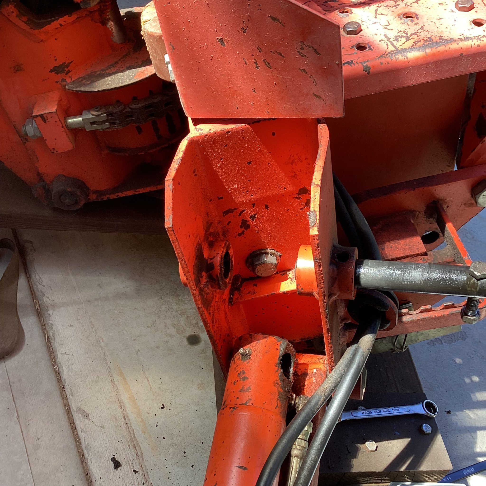

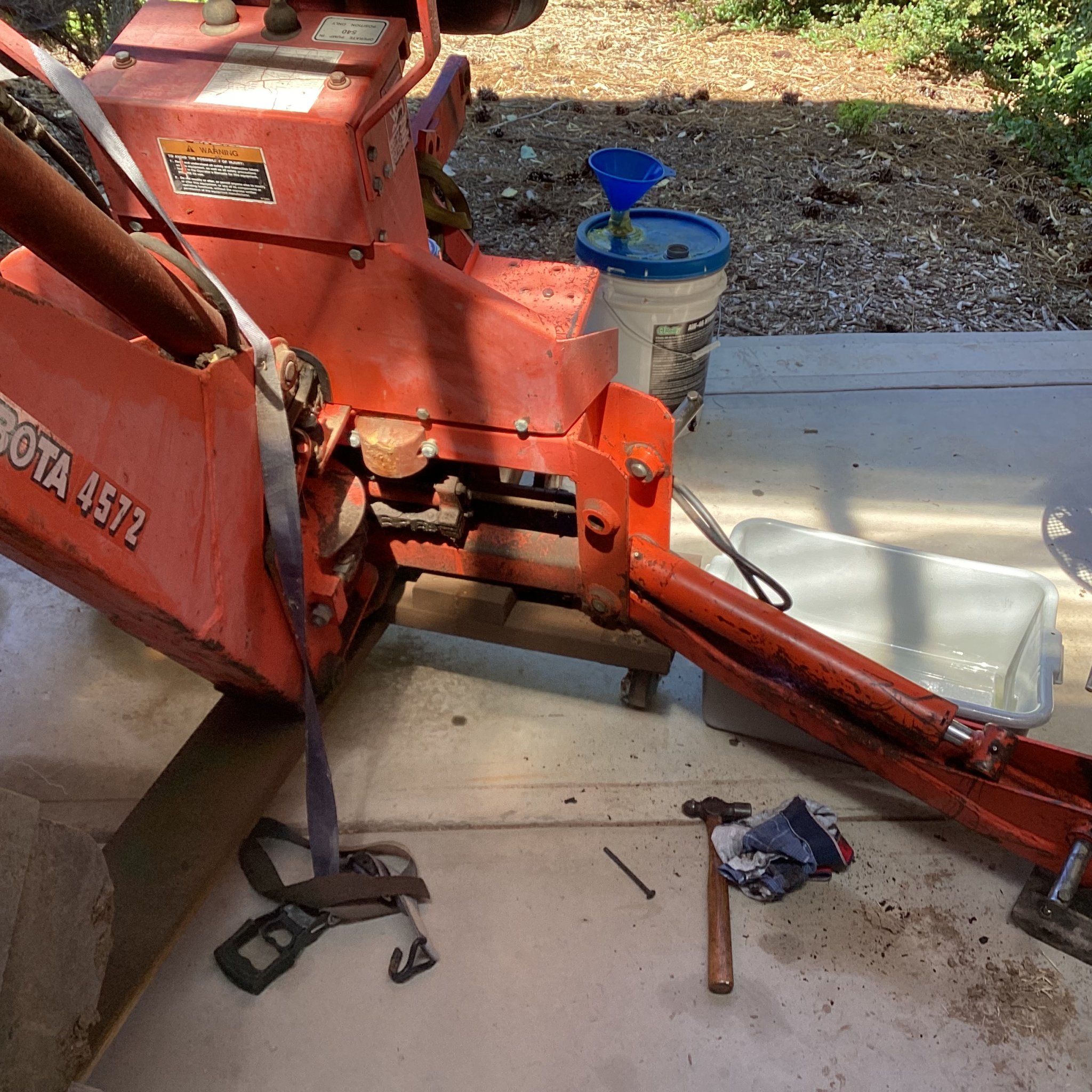

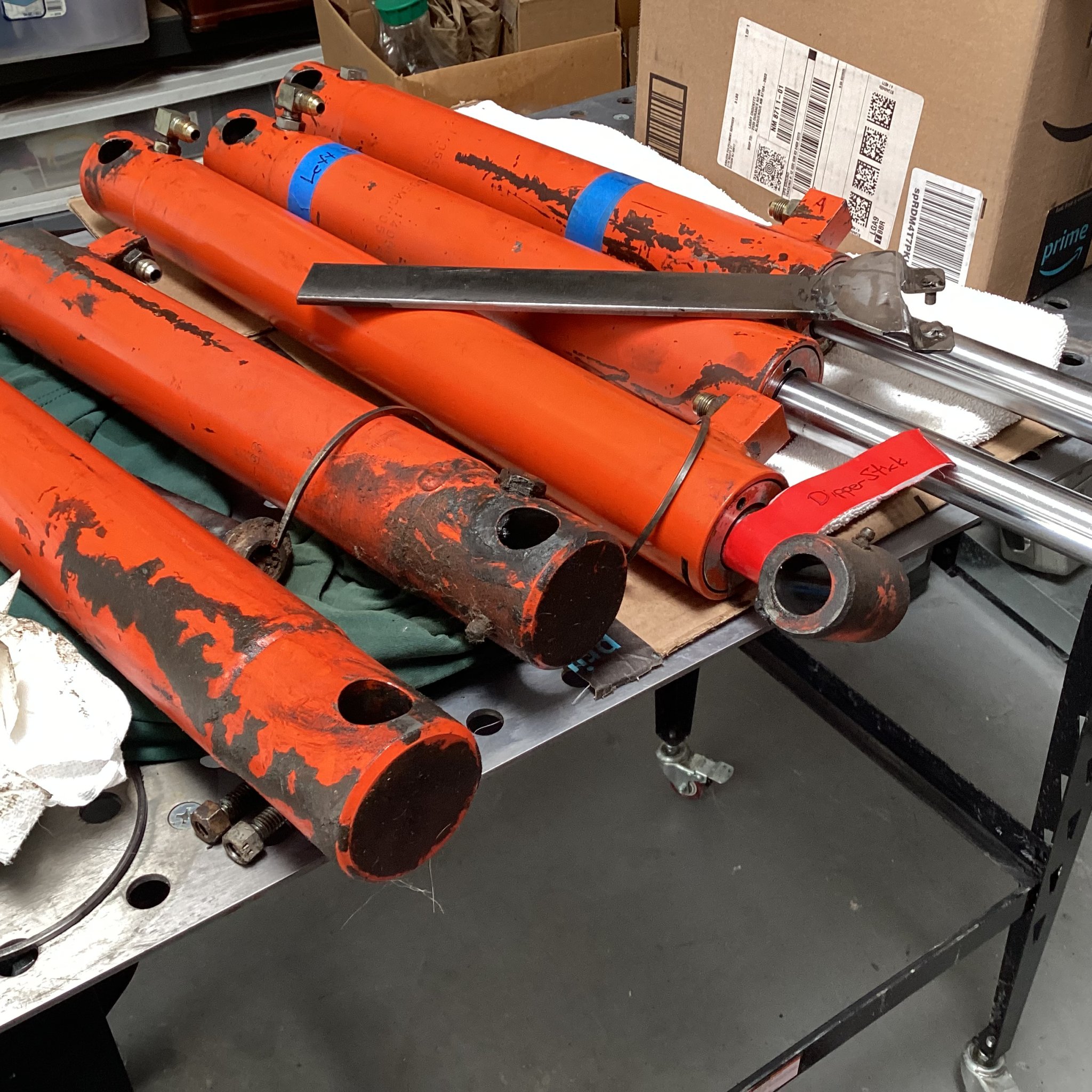

It’s time to give the backhoe some overdue maintenance. Swing and stabilizer cylinders are leaking and hoses are old and frayed. Some movements are jerky and the lower pivot zerk is hard to grease.

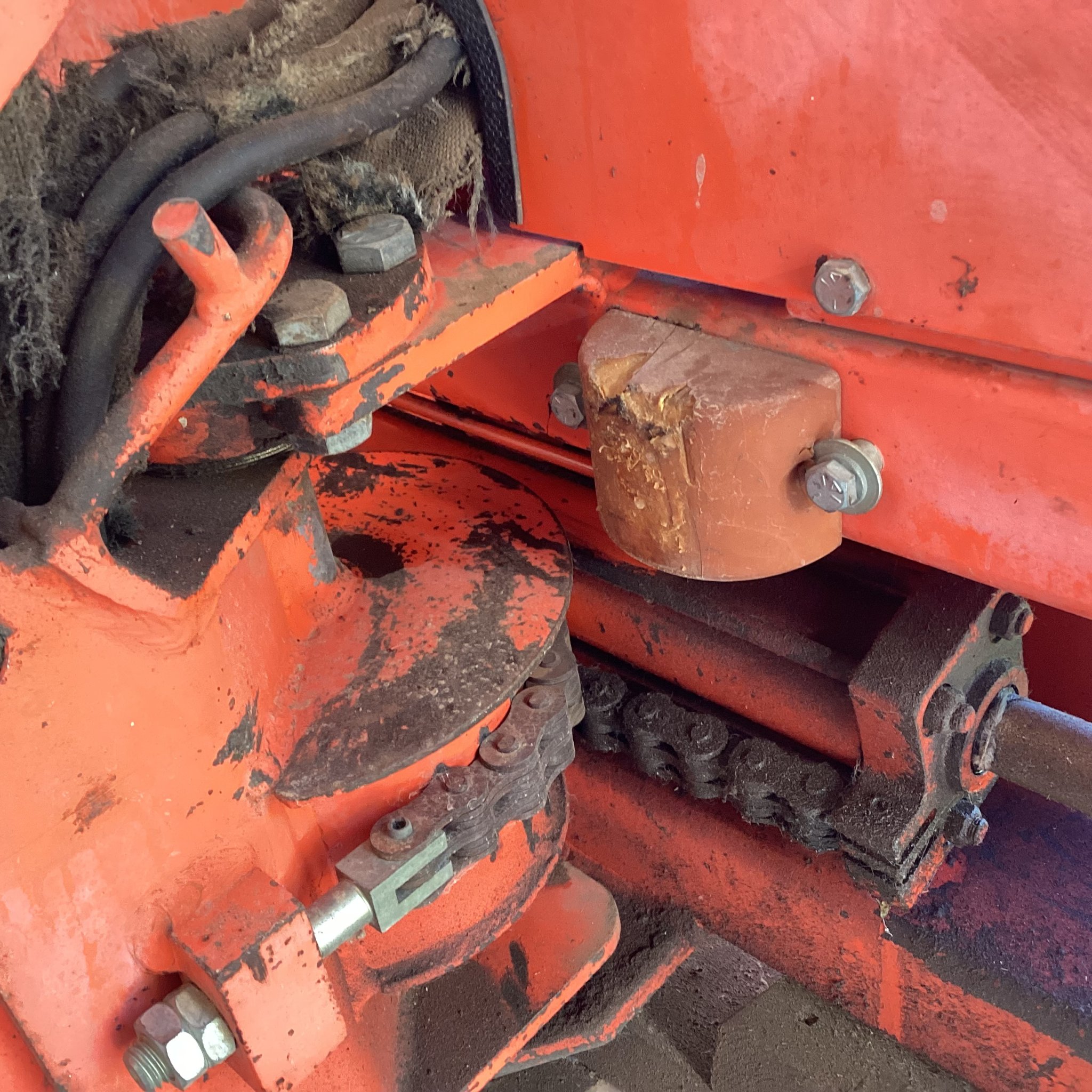

I believe this bh was made by Woods. Very similar to their BH6500. Swing is a double sided cylinder with chains to move the pivot.

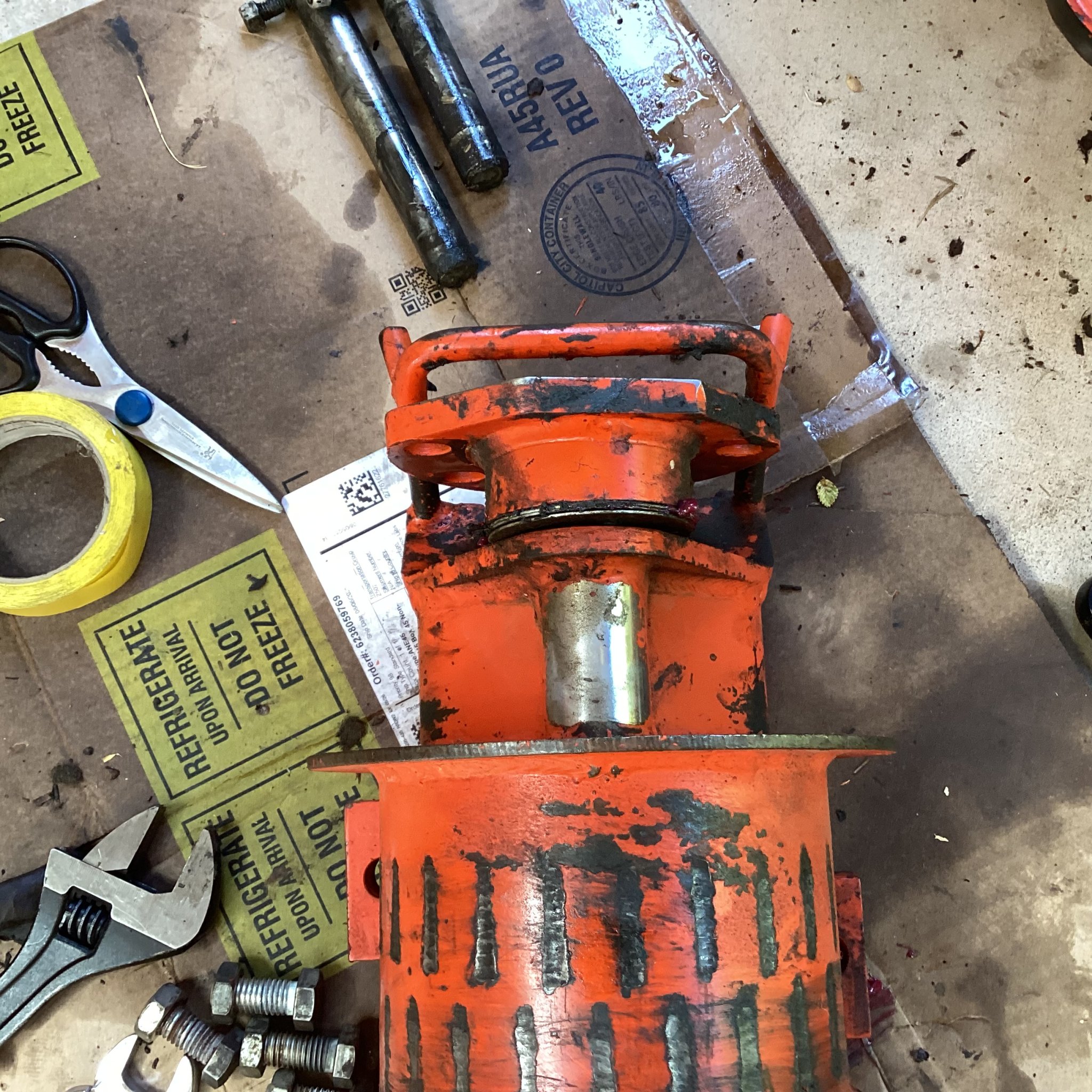

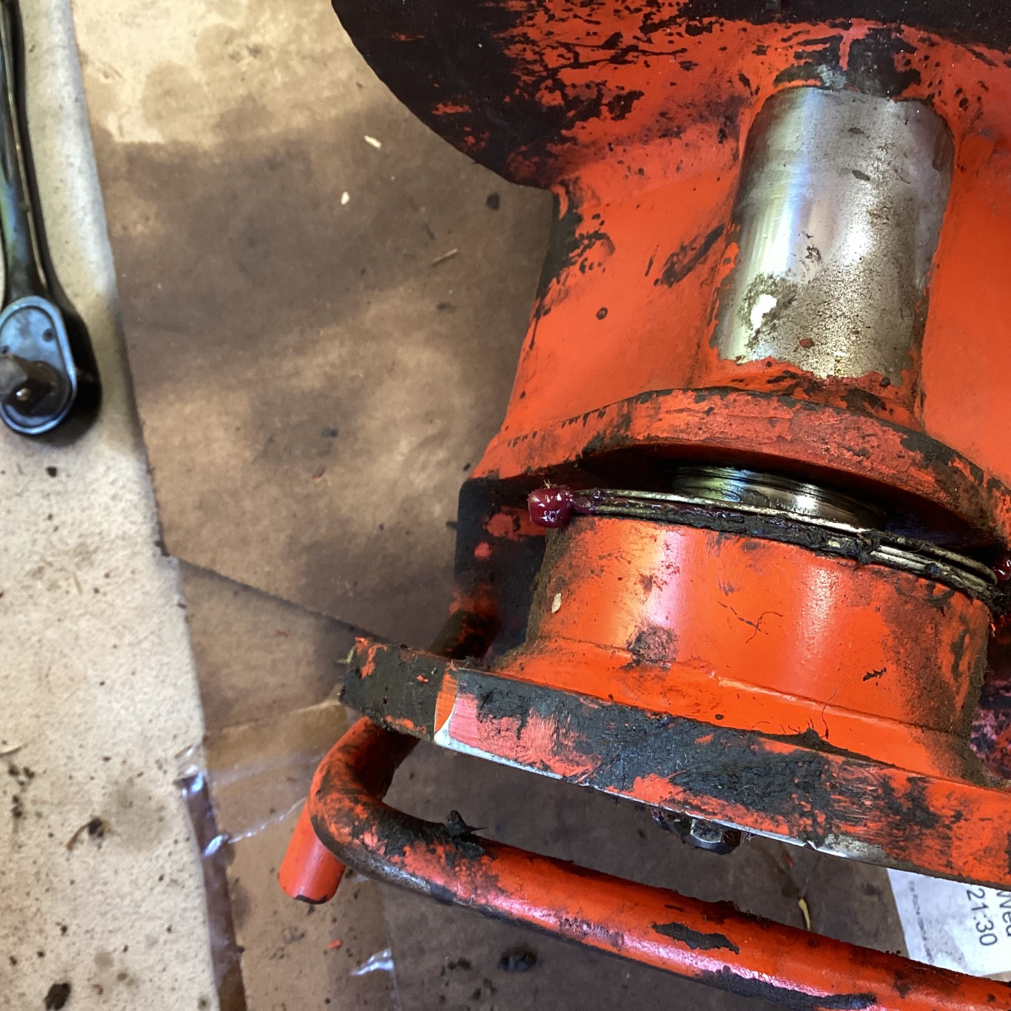

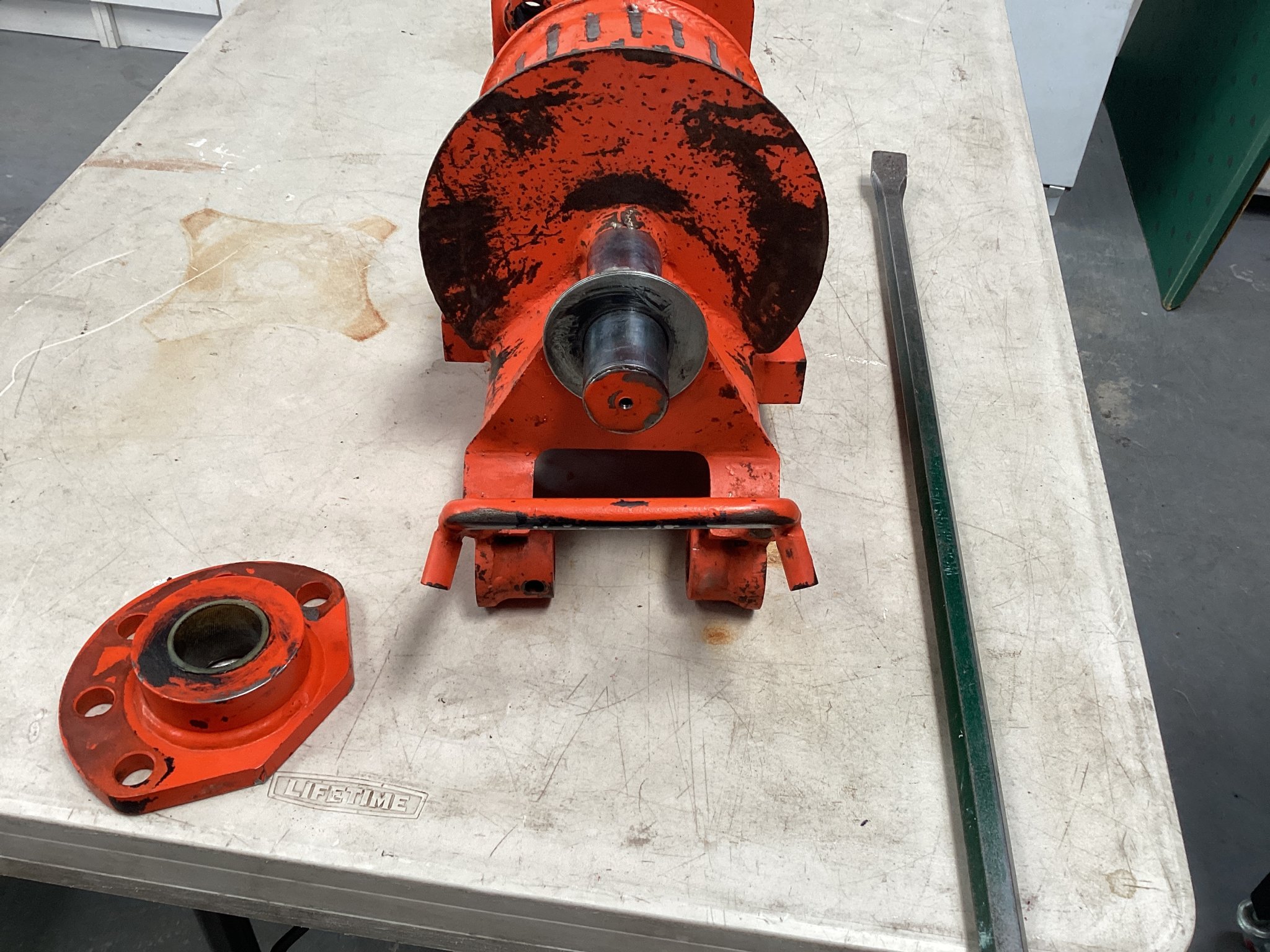

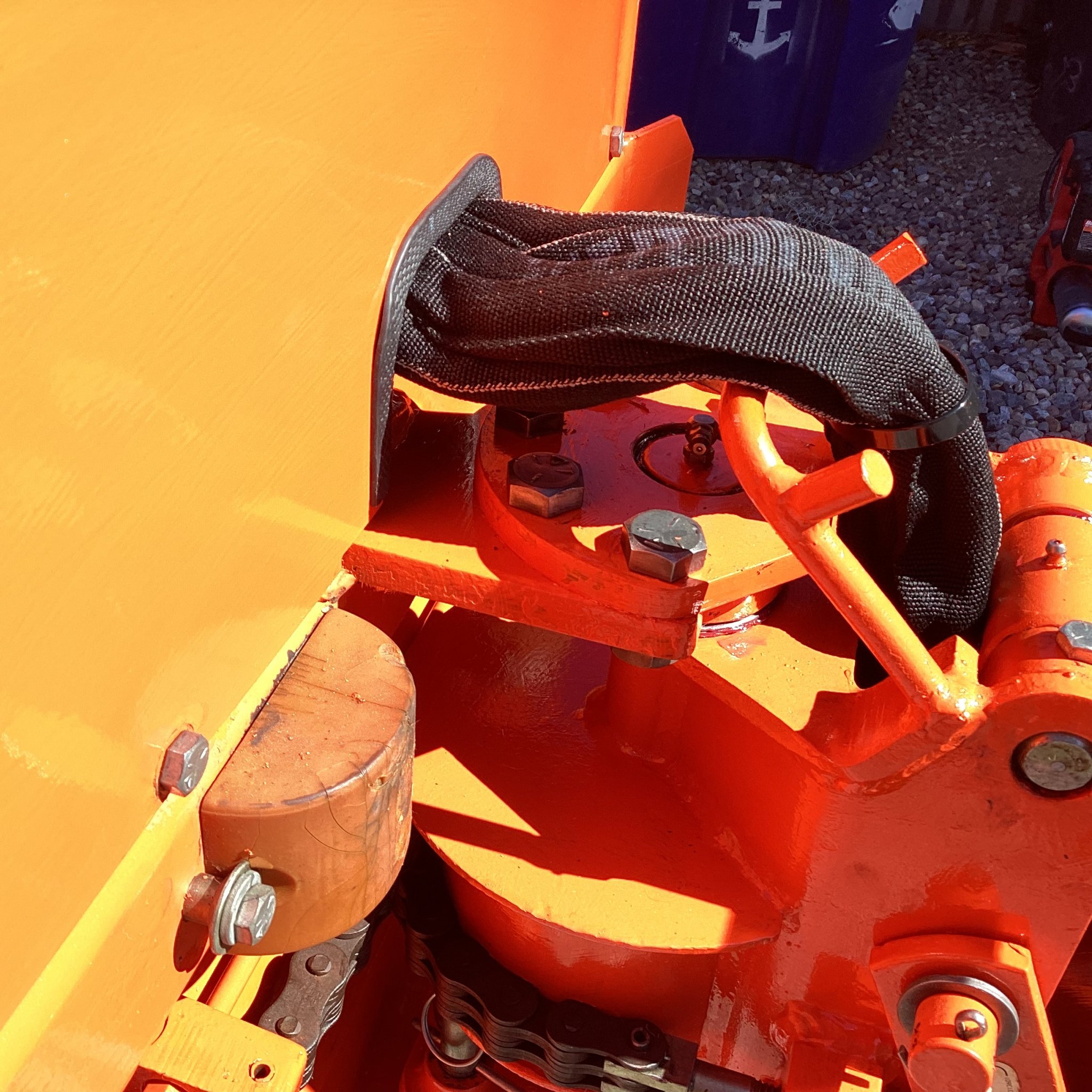

I am stuck trying to replace the pivot bearings. The upper won’t separate. Any idea how to get this off? It slides easily, but hits the hose holder, that rod with the two horns.

Swing cylinder had me scratching my head until I realized it was just bolted in on each side, easy to see once stabilizer cylinders are removed.

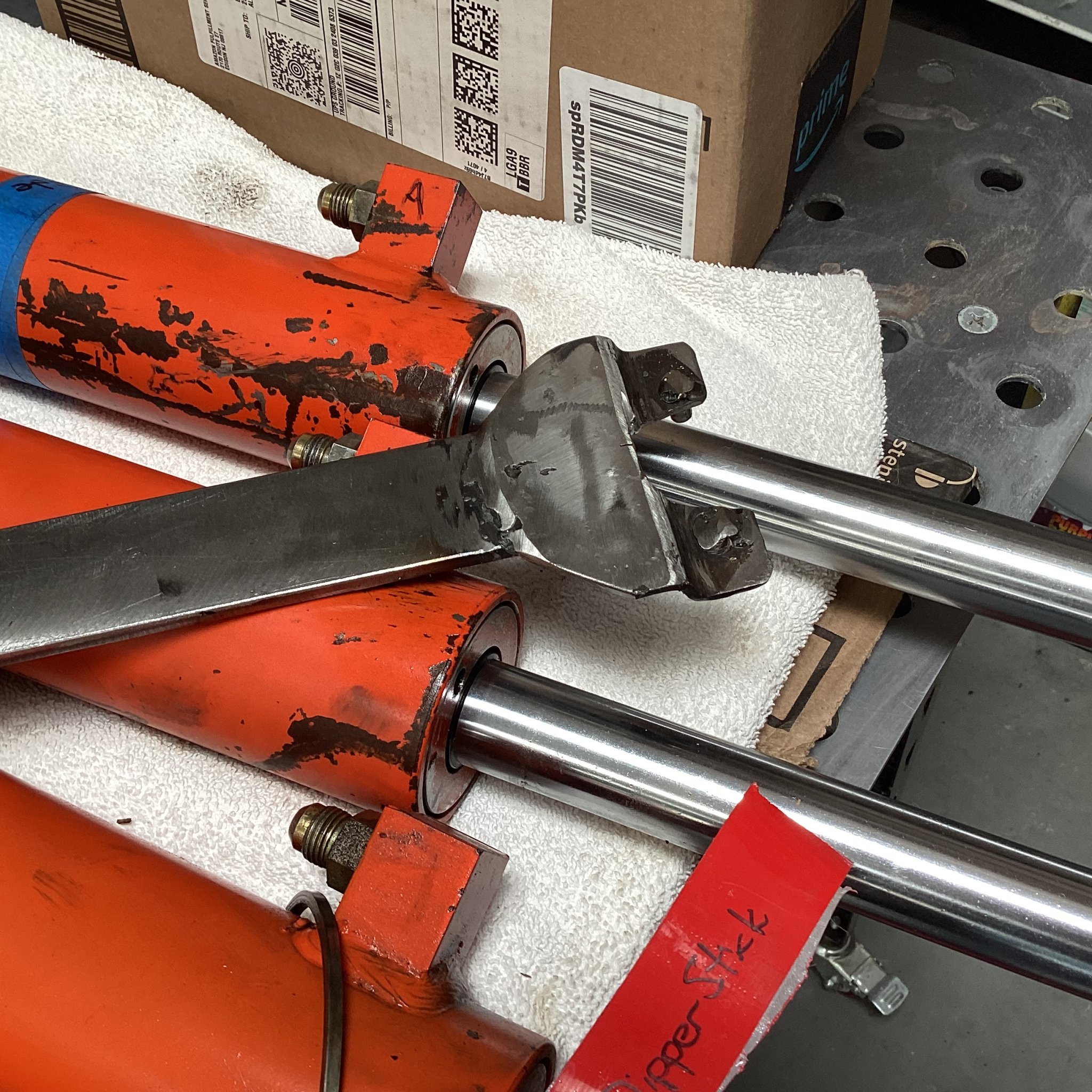

Look like you're going to have to cut that hose holder off.
Cut it off and then weld it back? I’m thinking of trying to bend it first, but I need at least an inch.
#40Fan
Jul 21, 2022
404
280
Yep, weld it back. If you could bend it, that would be better.

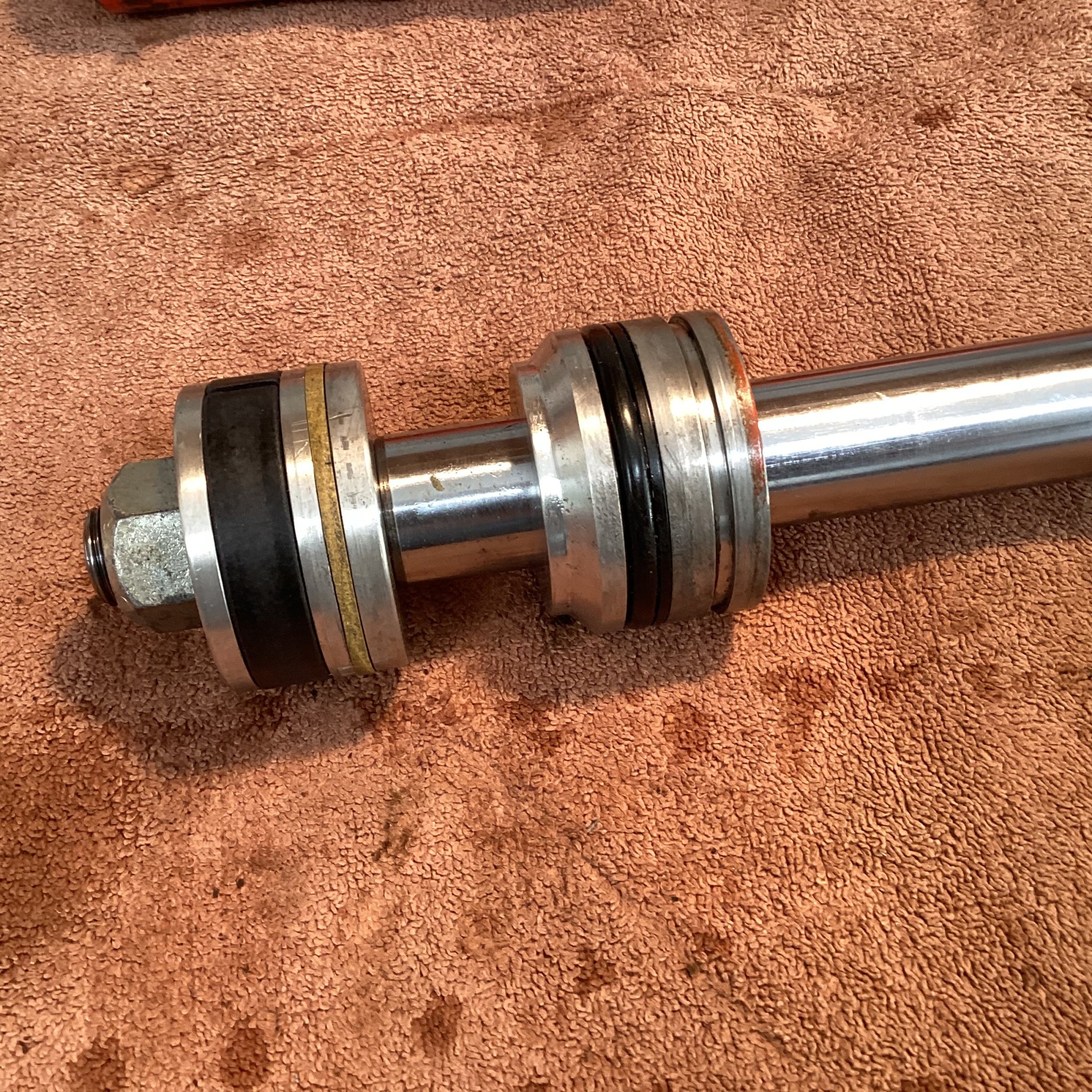

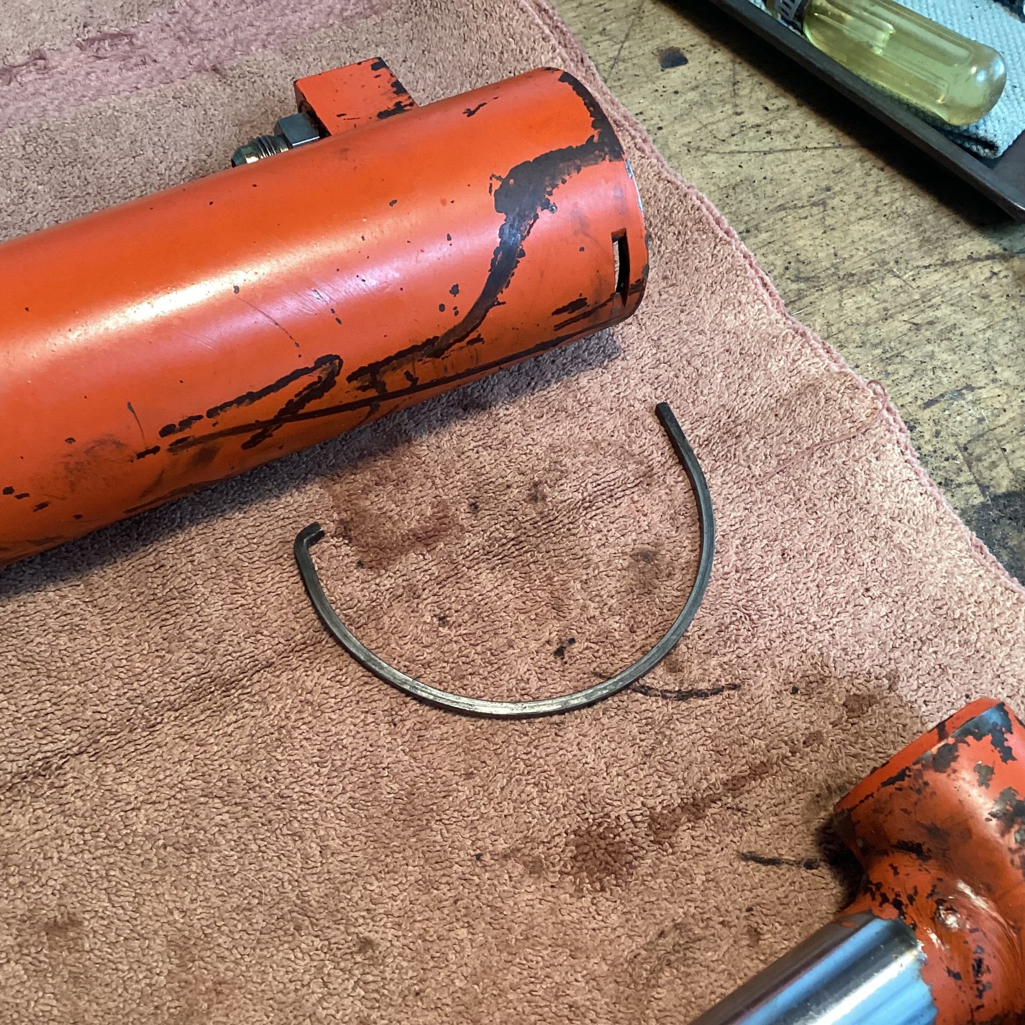

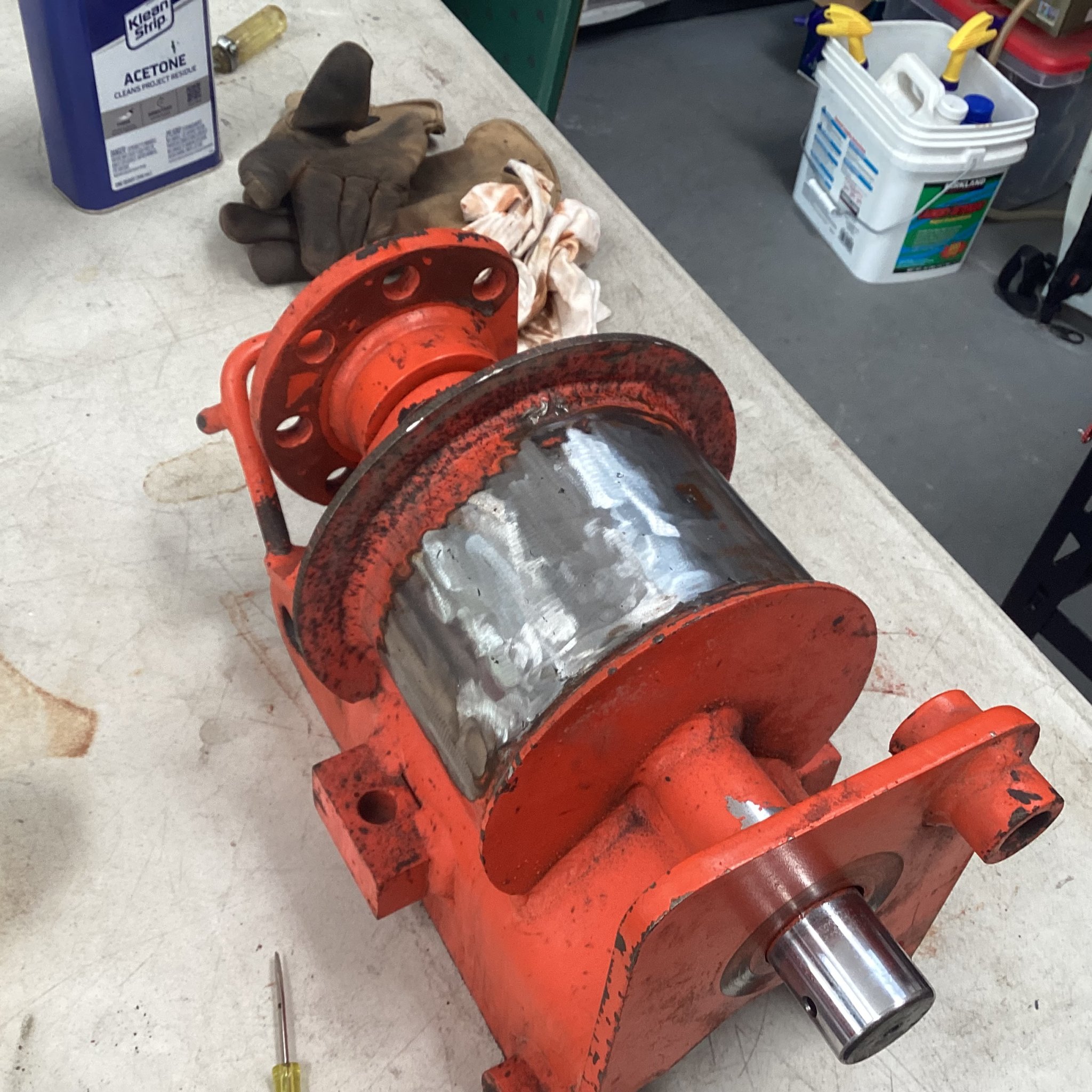

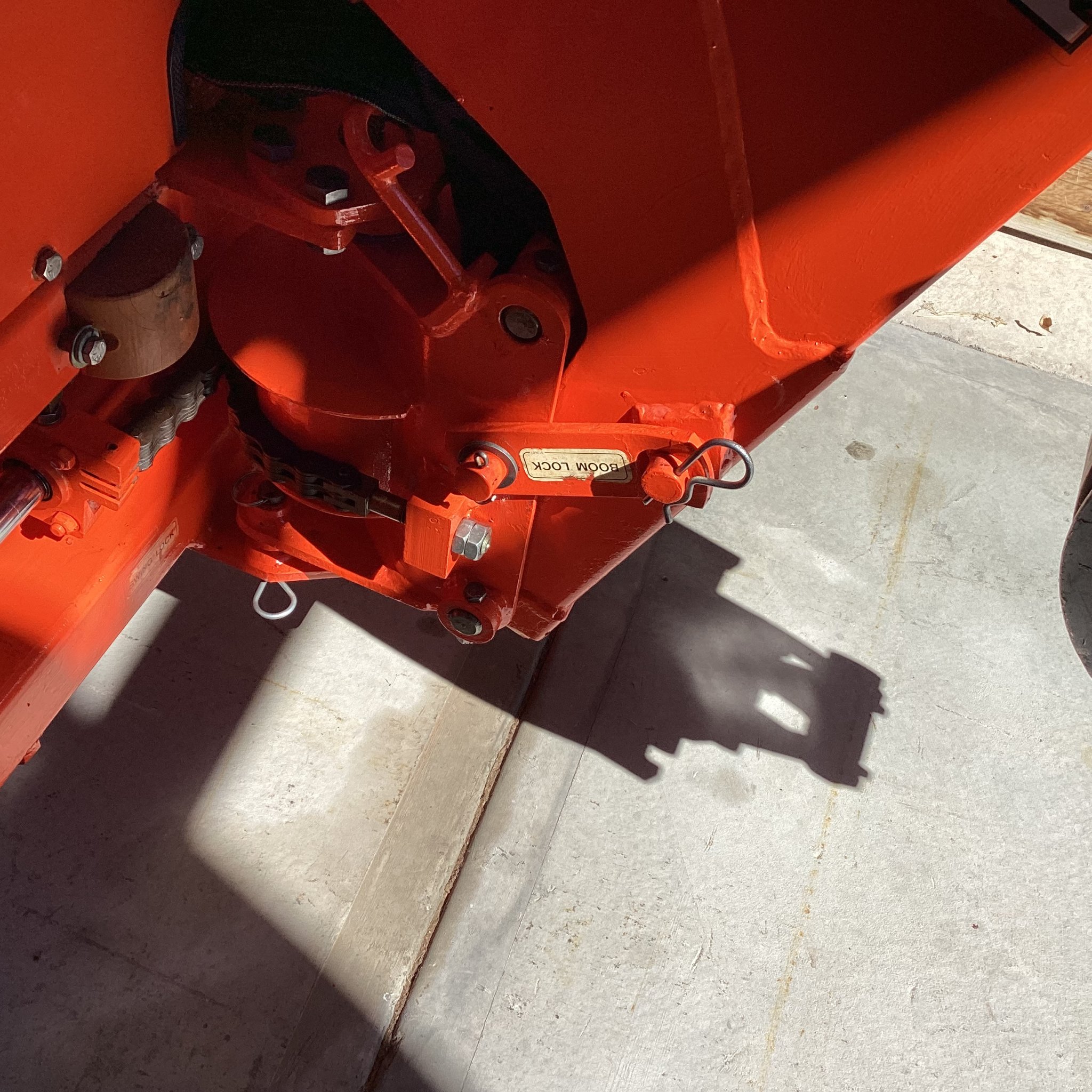

Time for an update. The chains had been loose and cut into the pivot. I filled the grooves with welding wire and sanded it smooth. Replaced all the cylinder seals and hoses. Cleaned off 30 years of old grease and gave it a fresh coat of paint.
Lencho
B7100hst
Jan 21, 2017
441
110
NM

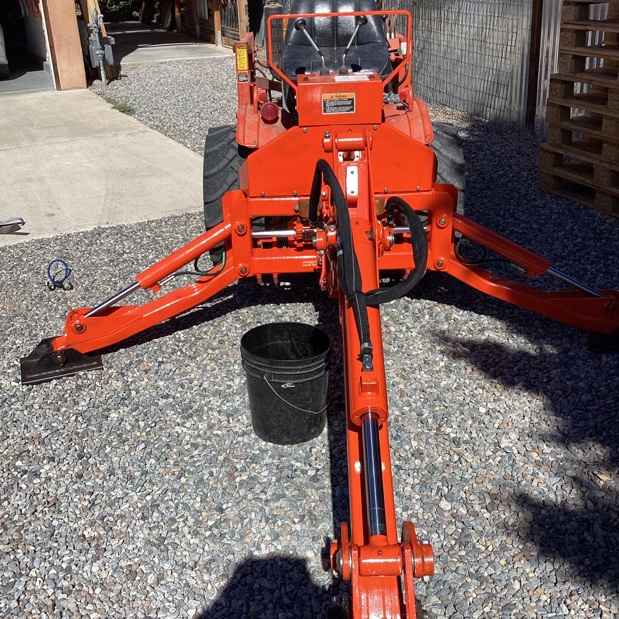

I never realized the hose holder was bent down, it is easy to get to the top zerk now. I also welded the boom lock post back on. It was in the tool box when I got the tractor.

Now I think I need to paint the tractor as well :unsure:
