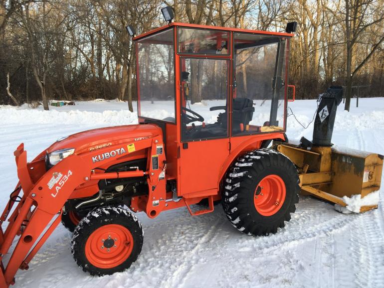

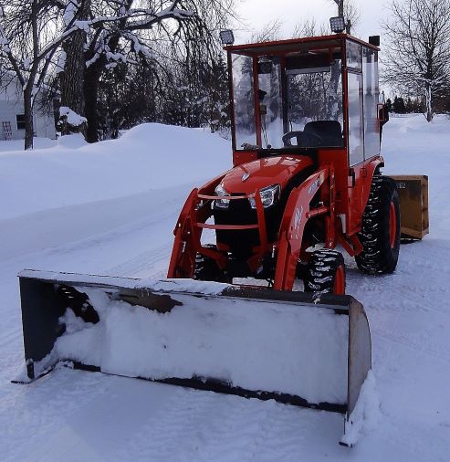

Here’s how it sits and looks with my snowblower attached and homemade pusher blade on the front.
There you have it…….my poor man’s version of a custom cab that can be installed and removed easily…..and won’t cost you a fortune…..even if you had to hire a friend to do the welding for you. Maybe this might be the way or a partial guide to build a cab for another model. It sure has worked well for me over the years and I’d be happy to share or take any other pictures or info that someone might want in contemplating their own build.

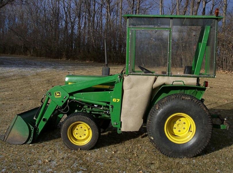

Tractor & Homemade Cab_2.jpg Tractor & Homemade Cab_6.jpg Tractor & Homemade Cab_4.jpg
The lower parts were all enclosed with some carpet remnants. Worked fine and was nice and warm too. It just ain't purdy!!

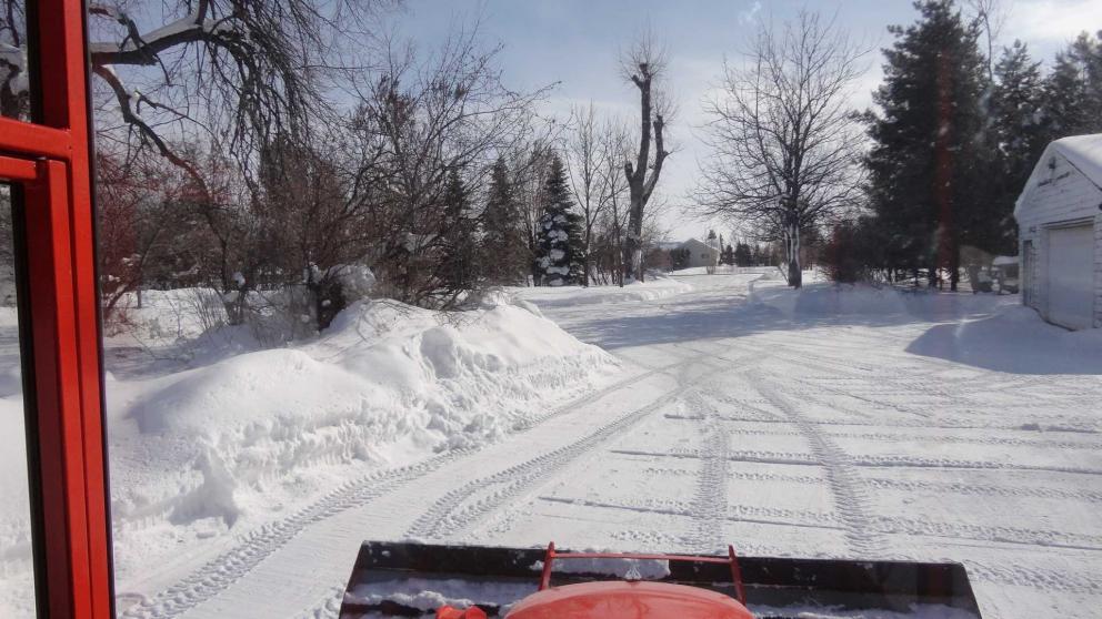

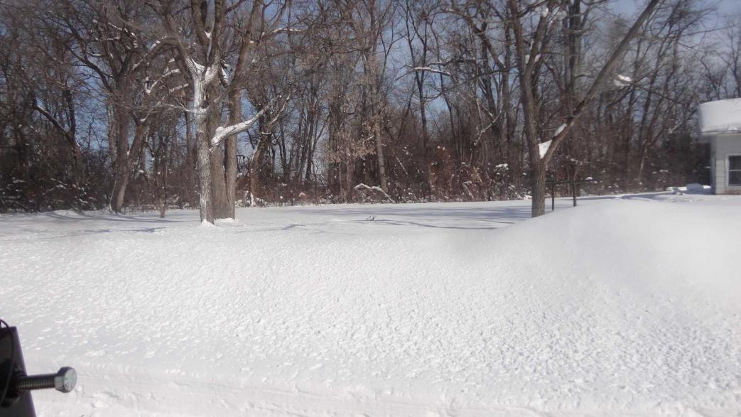

Here's a few pics today, looking outside of my windows from inside this cab on a nice sunny day.
http://www.orangetractortalks.com/forums/attachment.php?attachmentid=41255&stc=1&d=1551566776
http://www.orangetractortalks.com/forums/attachment.php?attachmentid=41256&stc=1&d=1551566798

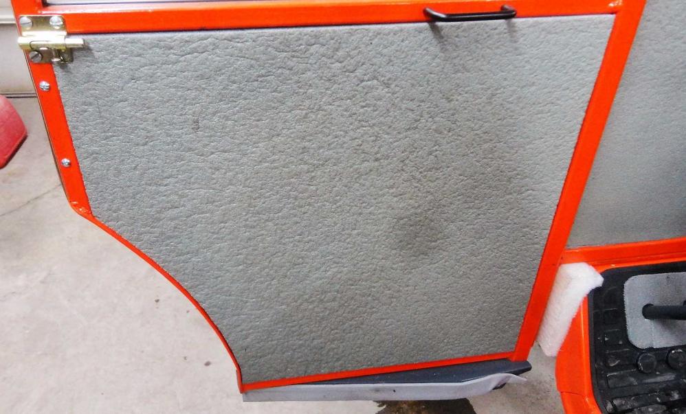

In looking through the pics it appears I neglected to include some pics about closing up some gaps and adding just a bit of insulation to the inside lower cab areas. From some foam “headliner” type insulation that was ¾ inch thick (gray in color) I made pieces that fit into the lower door, front, and side areas and around the Rops openings.
The cold breeze would still flow in and cause the feet to get cold so this piece was cut to shape and inletted into place. I first measured the center to center distance and diameters of the pedal shafts. Then a larger piece of cardboard with those holes cut out to fit around the shafts was held in place while I traced the outline of the opening from the underneath of the floorboard. +/- ½ inch was added around the perimeter of the outline and this became the pattern for the insulation “plug”. After the holes in the proper location were cut and a slit to each one from the lower edge was made, I carefully cut a narrow channel around the outside edge of the insulation piece and created what’s essentially an insulation grommet. The travel of the brake pedals stay pretty true to the same spot so there was no need to oblong the holes at all. The give in the foam took care of any deviation of the shafts when depressing either or both brake pedals. To install: From inside the cab, first place the piece around the two pedal shafts and then work into place by fitting the slot around the perimeter into the floorboard opening. If it seems to tight to go in at first, just increase the depth of the edge "channel" a little more and try again. It only took one try, it was quite easy to do (even for me), and you couldn’t have a better seal around those pedals. And just as good…..it comes out the same way when your done with the winter work. Just slowly work one edge around while pushing it upwards from the underneath and pop it out to the inside for removal around the pedals. Can't get any better or easier than that!

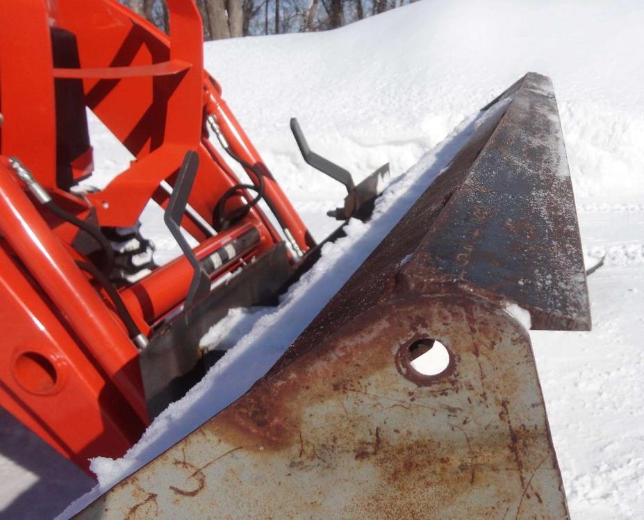

Just for an FYI I'll throw in these two pics in case anyone might be interested.
The first is of my older Lorenz snowblower purchased new in '91 or '92. Originally it was hooked up to the JD750MFWD and with only 17 HP at the PTO it was a little underpowered. But inside the trees here the snow seldom drifts into hard pack so it wasn't ever an issue. Plus, instead of the usual auger type components this has the two rollers with angled paddles on them to break up any hard pack. And boy, do they ever do that well. Even with just 17 HP powering the blower those paddles still broke up the hard crusts and cleared a path. The new Kubota B2650 with 19+ HP at the PTO is a noticeable improvement and turns this blower into one mean snow eating machine. I can't imagine what it would do with 25HP input! Years ago the kids had left a basketball out under the hoop and a heavy snowfall had covered it up completely. I thought and explosion had taken place while blowing snow the next day! I couldn't imagine what I had done or broken. Upon shutdown and inspection I couldn't find a thing wrong. Started things up again and all was normal. Happened to look out into the yard and saw something black laying on top of the snow. Walked out there and found the carcass of their basketball cut and split into pieces that were still all clinging together. :)
This is an extra cutting edge I welded to the top of my snow pusher blade. When I tilt the bucket almost all the way forward I can nose up real close to the garage doors, etc. and pull any snow or hard packed snow from tire tracks away from those openings with ease. It sure makes life easier!!
