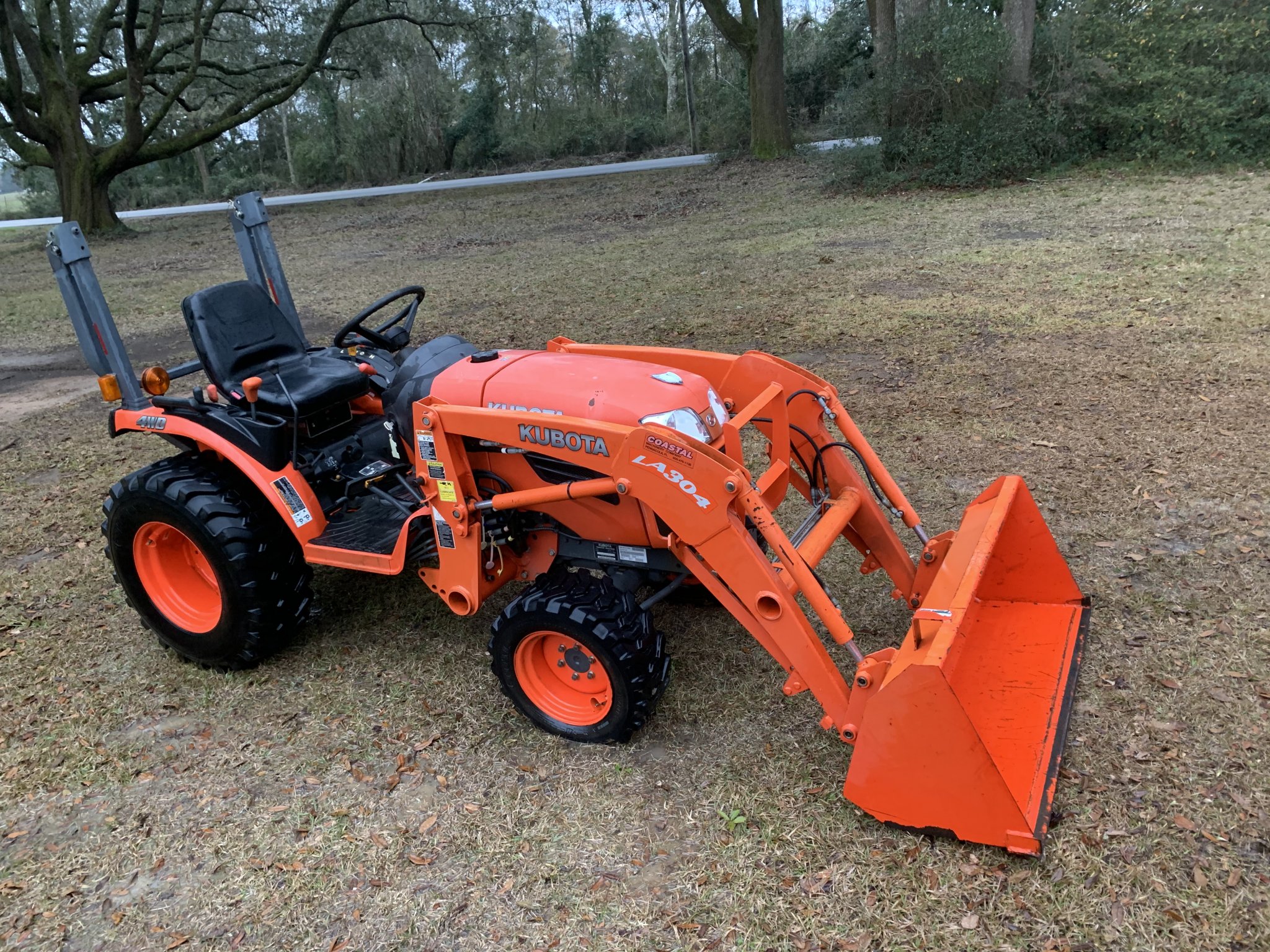

I have a 2012 Kubota 2320 which I got used. The 3 point hitch does not work. I have a front loader on it which is fully functional. I had to replace both hydraulic lines running from the reservoir to the pump, the filter and the fluid m. The control lever is locked in place. I have turned the speed control below the seat to open and turned the steering wheel right to left while pulling the lever back and forth still nothing. I’ve sprayed blaster directly into the stub coming out of the gear and it’s still locked.

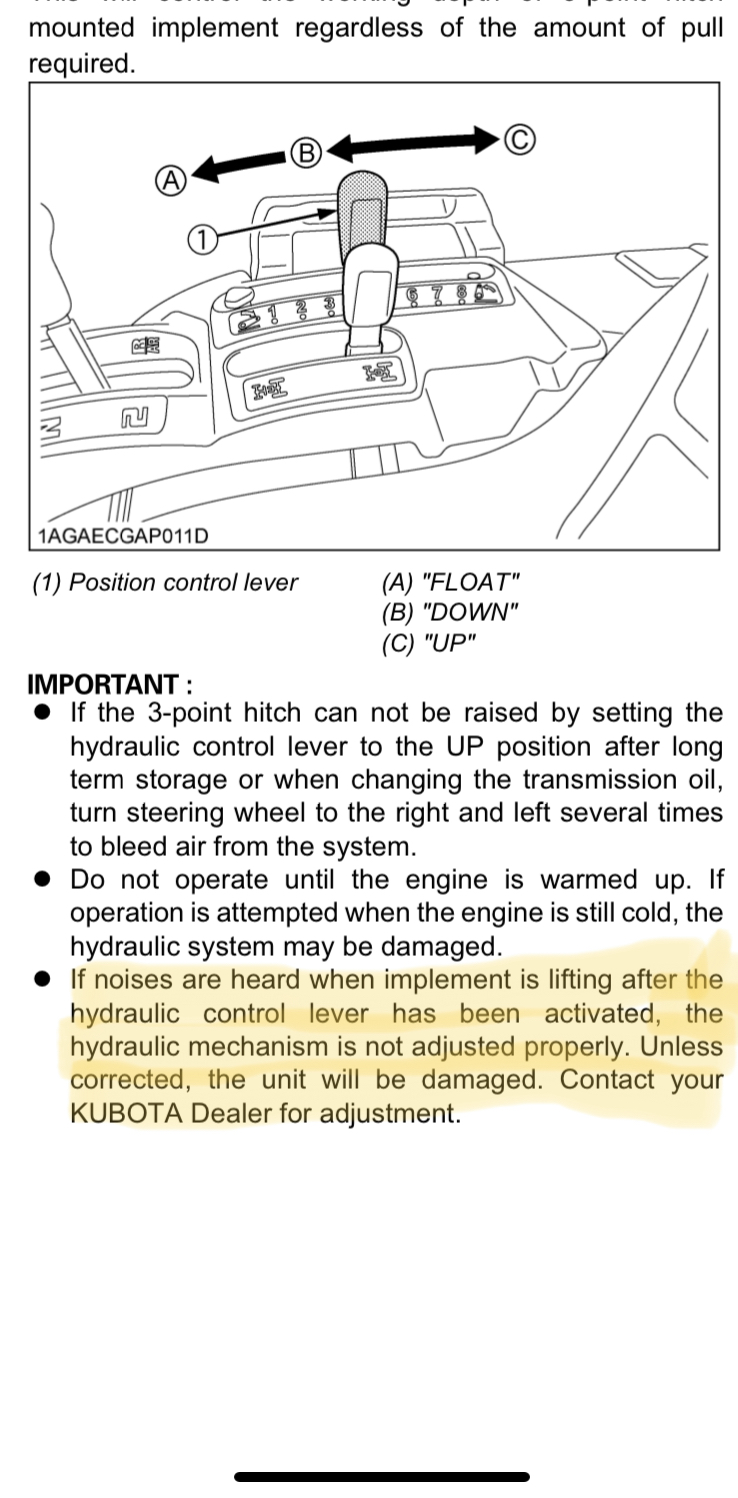

...The control lever is locked in place. I have turned the speed control below the seat to open and turned the steering wheel right to left while pulling the lever back and forth still nothing. I’ve sprayed blaster directly into the stub coming out of the gear and it’s still locked.

Is it possible that there is a lever lock device that someone installed to keep the 3pt lever from moving without unlocking it?
Did you try asking the previous owner about the 3pt to see if it worked for him? You mentioned that there was a box blade on it before you bought it. They had to get that off somehow and to me that would suggest that the 3pt was working at least until you bought it.
There is one more possible place to look. does your tractor have an adjusting knob for a MMM? If it does, look to see that the knob is set to "0". If it is set to any other number, the 3pt will not go down to the lowest position.

Ok. Can you physically lift up on the 3pt hitch arms? IE can you lift them by hand? If not, spray some penetrating oil between the lift arms and the rear of the tractor (and all other 3pt connections). A good whack from a hammer may help as well.
Take a look at this diagram. Can you turn the 3pt lowering speed knob counter clockwise? This would be the image at the bottom. These things do freeze up (as in rust) if they aren't used often enough. Lots of penetrating oil if it doesn't budge. Be careful working this knob.
If the knob turns, turn it full counter clockwise and try lowering the 3 pt hitch with the engine off. You can stand on one of the lift arms to help assist gravity. These lift arms only provide hydraulic force in the up position. The down position only uses gravity (and whatever weight/implement) is attached to it.
