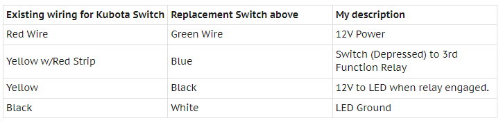

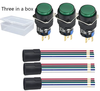

I bought this from Amazon (3) 16mm switches for $12.99 - P/N: B0975WXJ3H and took off the square metal on the switch and wired in the Socket Plug knowing an easy replacement in the future. Wiring this switch to my existing wiring harness was eased by melting new solder on the existing soldered wires to reduce that solders melting point. My wires were already short, so I didn't want to cut them.
Here is what I wired mine for the Kubota switch wiring to Replacement switch Wiring.
I slipped heat shrink tubing over each replacement switch wire and then soldered the new switch wire socket in place.

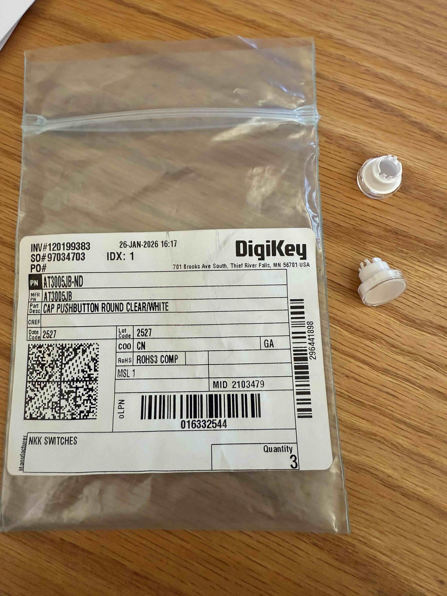

I had the issue where I flicked the little white switch cap off of my 7J056-84152 (i.e., off the switch mounted just below the joystick) and was unwilling to pay the current $200-225 for this part. I successfuly replaced the cap with NKK switch part number AT3005JB "Cap Pushbutton Round Clear/white" purchased from Digikey.com. Three of them (two spares) were around $20 with shipping and tax as of 1/26. This is a "bright LED" switch (not incandescent nor Super Bright LED).
It is easy to see how it snaps on if you look closely inside the switch, there are two dimples and the clips on the switch hook into them. Also easy to see how it can easily be flicked off. My solution is kind of kludgy but I put a piece of clear packing tape over mine and just put another piece of clear packing tap on the underside of the long piece of tape where it goes over the switch so it sticks to the orange fender but not to the actual switch cap itself. This way I can't flick it off, it works fine, and I can still see if it's on or off.

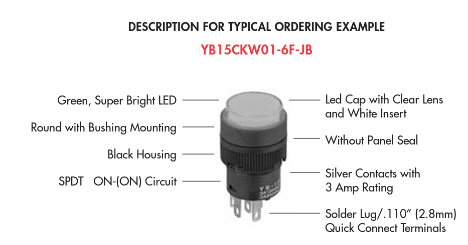

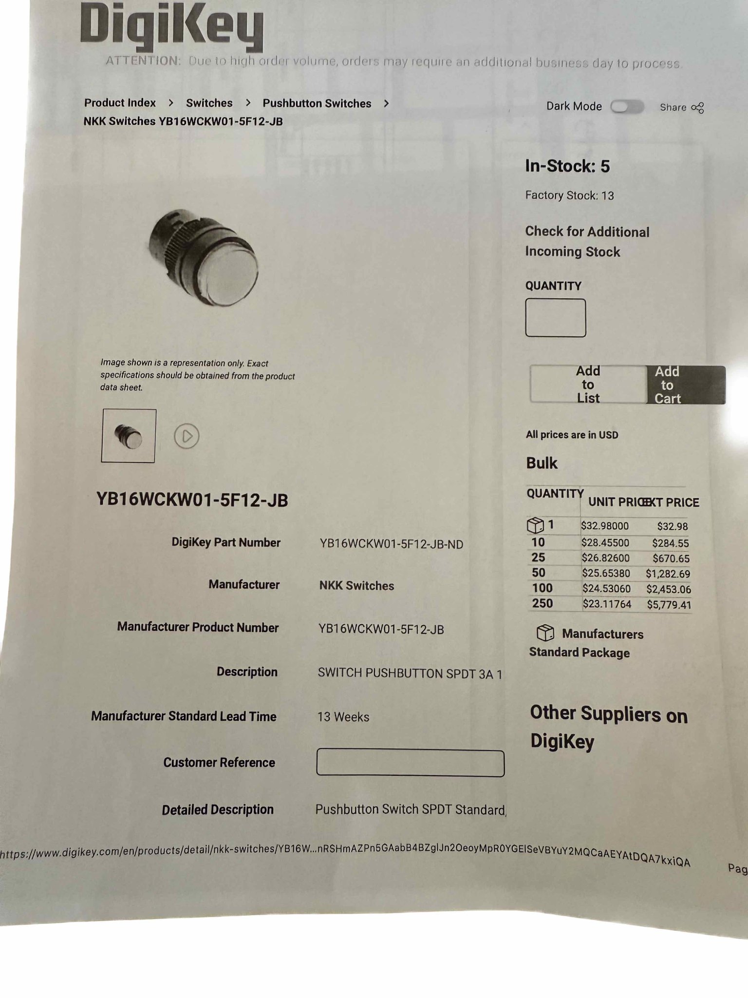

If you destroyed the switch entirely (dirt/water ingress, etc.), the exact replacement switch seems to be (I didn't buy one, but pretty sure) YB16WCKW01-5F12-JB. Right now this switch at DigiKey is around $33 - see 2nd attachment (kind of a lot for a switch in my book). You can check me at https://www.nkkswitches.com/pdf/ybnonilluminated.pdf - page D106 and D107 show the nomenclature for determining the correct switch. Also, you could use that nomenclature to ensure that if you find a cheaper switch that it would work (latching vs. momentary, etc.). BTW, even if the cap is lost, you should be able to test it by turning the switch on with your pinky fingernail or whatever - try your fingernail in multiple orientations. Make sure the tractor key is on.
