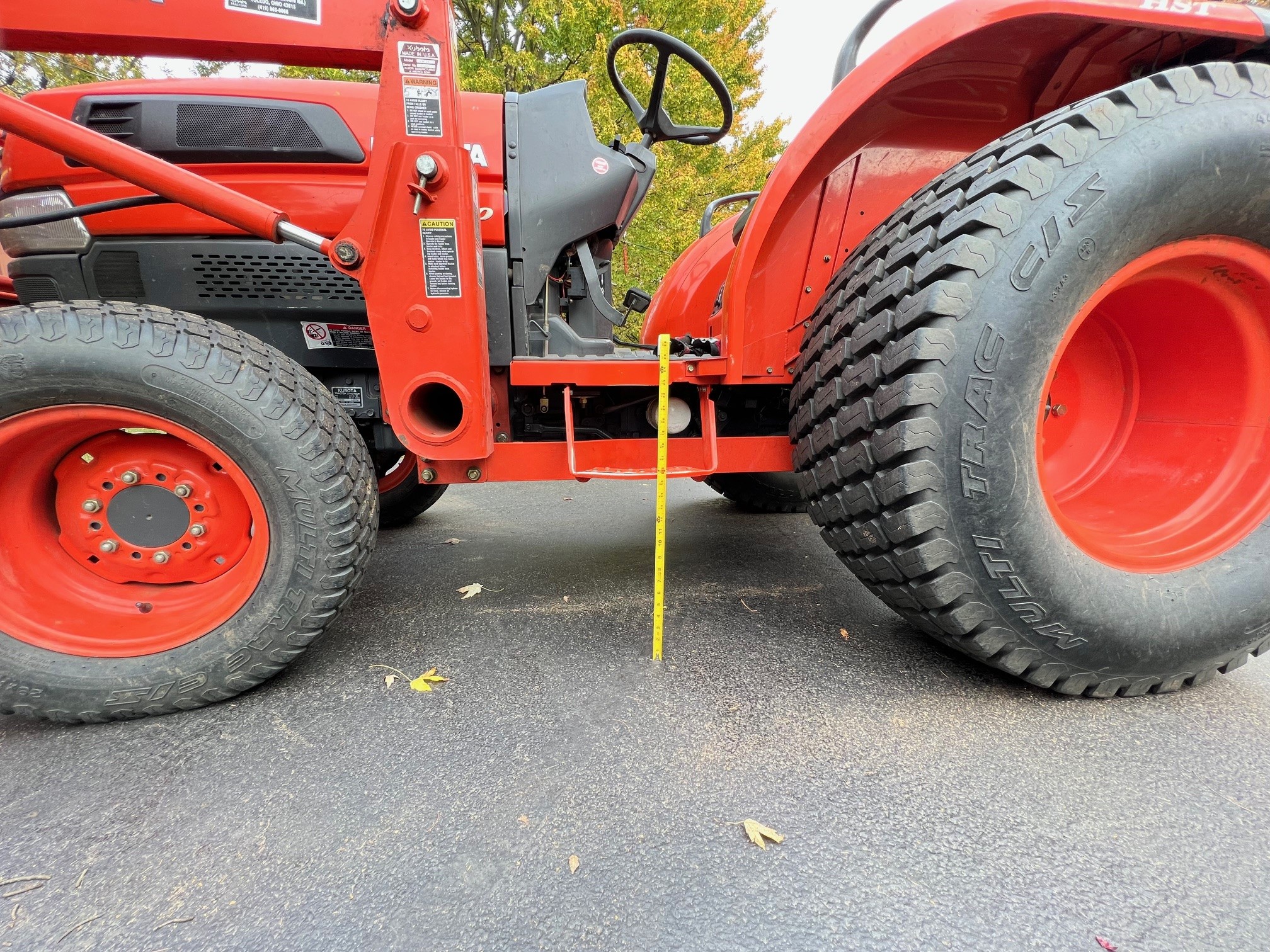

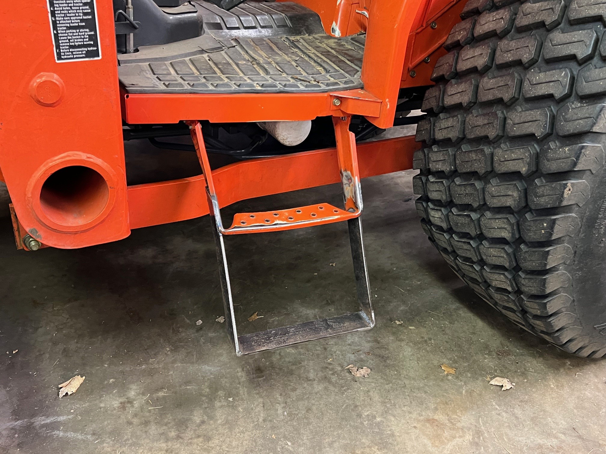

I have had numerous problems with my knees and ankles once I started using a Kubota. It has taken me some time but I believe that I can shed some light on what may be happening. The step on my Kubota is over 16" off of the ground. To get on the tractor I must step up 16" and the grab the handles and pull myself up. After a day of working, cutting trees, and getting off and on my tractor my ankle and knee was swollen. So I had a welding shop weld another step on my tractor so that I only have to step up 8" at a time. Once I did this, my knee and ankle problems went away.

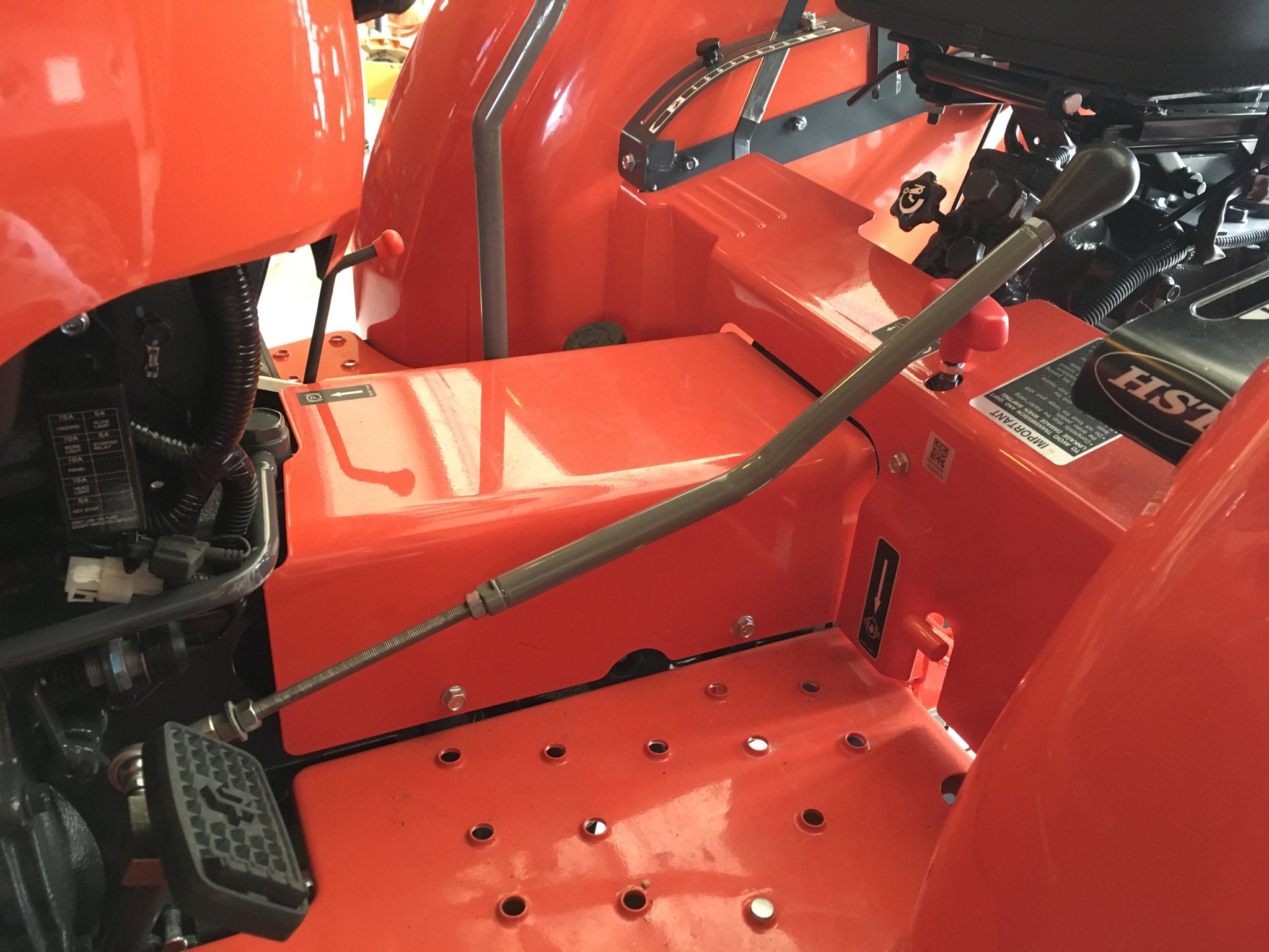

By necessity I fabricated hand controls for both the HST pedal and clutch pedal on my L2501.
The HST pedal hand control is bolted on, no welding required, and does not change being able to use the foot pedal. I have had many able bodied operators use my tractor and the hand control lever has never been a issue, as a matter of fact some users prefer it over the pedal. This might be a solution for those that experience foot/leg pain from extended periods of operating.
( I am not offering to build or supply controls).
I do not have a good picture of how I mounted the control on the HST pedal and right now do not have access to the tractor.
