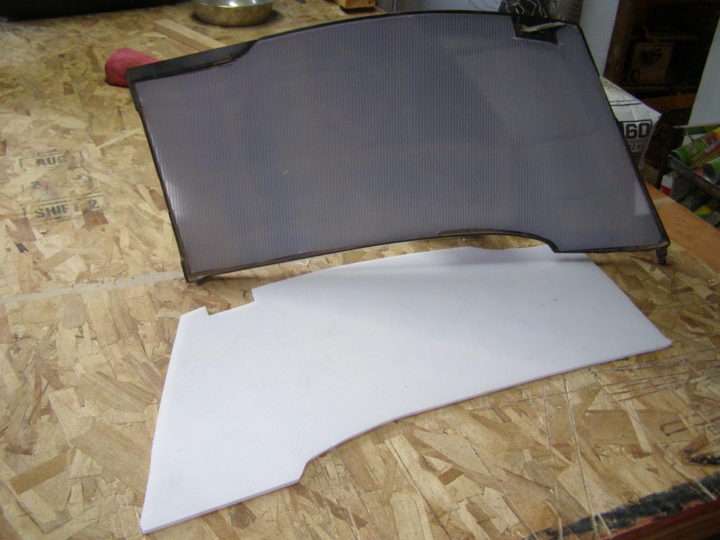

Hi All! November first already, and I wanted to thank you all for the advice on keeping Bessy II warm and ready to run this winter.
I’ve gone with a “smart” trickle charger from Tractor Supply to keep the battery topped off, and a self-made “snood” for the engine compartment, to keep the heat in and the snow out.
Its nothing more that a piece of plastic sign material, available for any craft supply store. Use the thinnest sheet available, and use the screen as a template to cut the cover for the radiator. It will slide right into the screen’s channels. I put a little foil tape tab on the top edge to make it easier to remove.
For the side panels, trace their profile directly on the sign material, cut out with a box cutter, then tweek and trim until they slip into the inside face of the panel. I kept mine a little larger at the corners so they would stay put just by friction and tension.
I gave this set up a test the other day, during the coldest morning of the year so far. Bessy fired up with a 10 second glow plug charge, puffed just a little white smoke and warmed up to the center of the dial in about 10 minutes!
