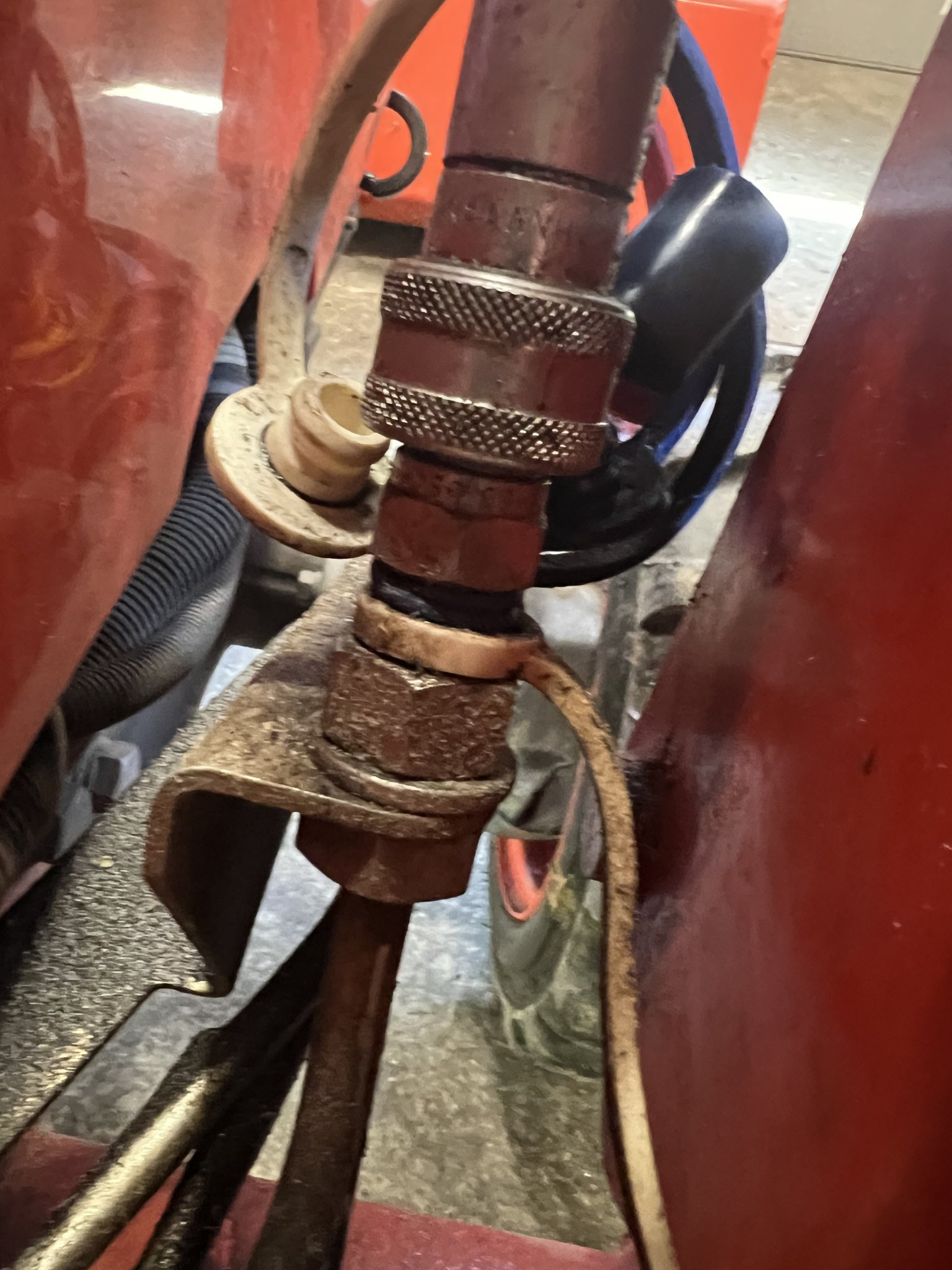

Pretty sure the blue goes on the white, red goes on the yellow. Like @DustyRusty said, can barely see it because it's just one or two wraps, but there's the blue winding on the white coupler on my tractor.
