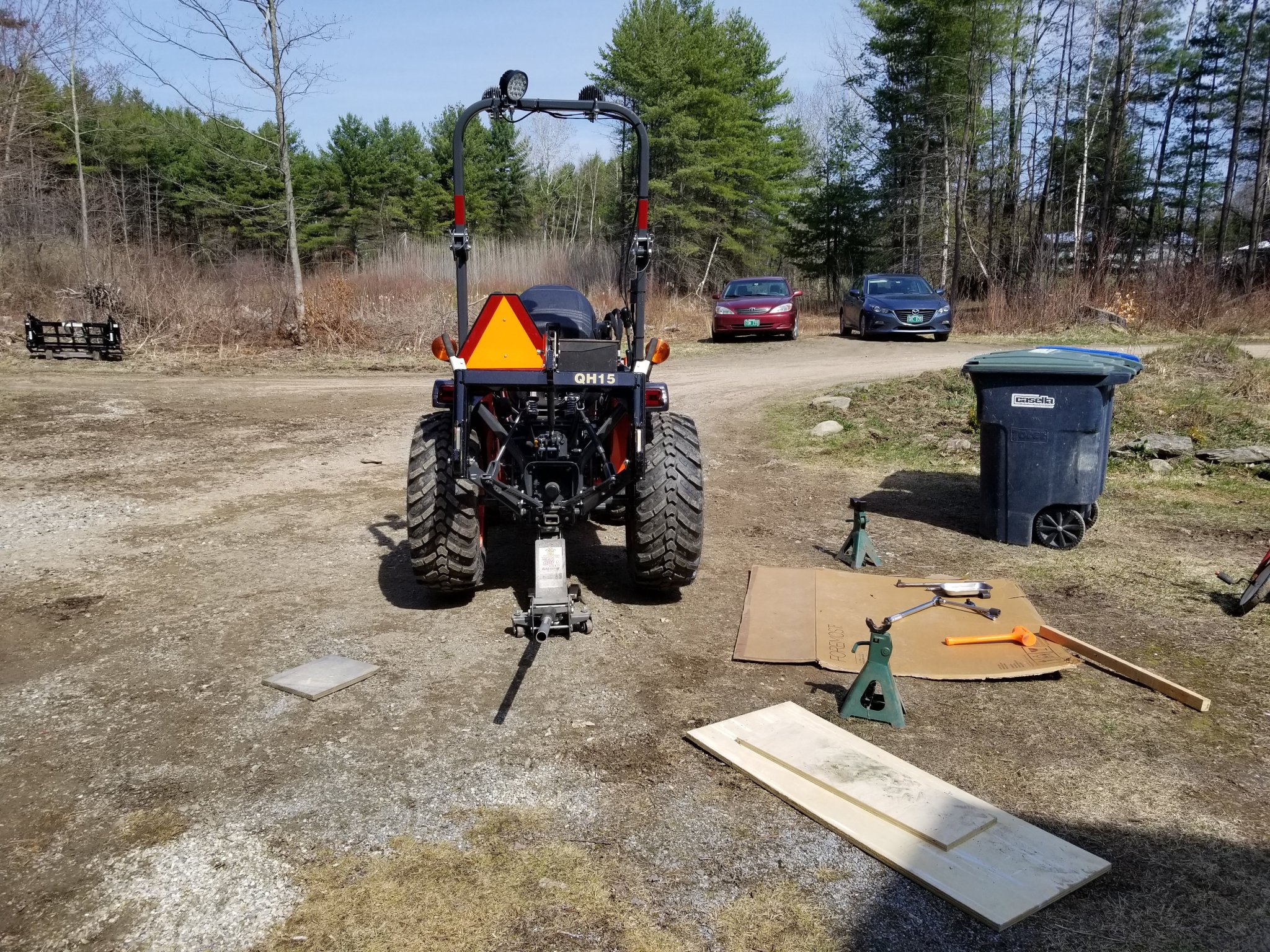

Assuming you have solid, flat ground I would jack in the center of the rear axle. When doing that I would put a jack on either side just in case it tipped or moved (I did not let the jack down all the way on the stands). One tip, you'll see I had plywood out, that was so I could jack the tire up high enough to get it off the ground and remove it, then when installing it I would put the plywood down, roll the tire on it, and line up the holes. If you do that you can just line up the holes and tip the tire onto the studs. Once you get the top lug nuts on part way you can jack up the tire an inch, pull the plywood out, and the tire can easily be pushed on the rest of the way. I think the tires weigh 250-300lb so I did NOT want to lift them or risk having them fall!
Mid-work picture with the left side as-is and right side with the 2" spacer:
Completed:
