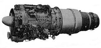

Had to look that one up on Wikipedia. I didn't recognize any of the aircraft it was used on. What were you flying?
6,038
3,314
Commonly known as a “Hawker” but more widely as a “HS-125”. It was originally (1960’s) a DeHavilland DH-125, but DH was acquired by Hawker-Siddeley (1970s) so it then was known as a HS-125. Then British aviation began a nationalization and British Aerospace acquired them…still known as HS125 worldwide. It was a very successful corporate jet especially in the US, but also had military applications in the RAF and Maritime Search-Rescue in Japan. It had “pure-jet” engines (the Vipers) until the ‘70s…then was produced with fan-jets (AirResearch/Honeywell 731s)….until around 2015. Mfr’d continuously for over 50 years…eventually acquired by Raytheon and airframes were completed in Kansas and Arkansas until the end of production. The recession of 2008 was the beginning of the end. Thousands still flying around all over the world.
The only civilian jet which ever actually hit with a heat-seeking missile from a fighter-jet but still landed safely with its passengers.
I was a demonstration/production-test pilot for the mfr’r on it after flying it corporately and lastly training and examining pilots rated on it until I retired.
The engine began life as an Armstrong-Siddeley Viper, but acquisitions thru Bristol-Siddely and finally Rolls-Royce. It was also used as a target drone engine (and may be still in the Jindivik drone) ..but it was so durable that shooting it down didn’t kill the engine…it’d crash if the drone was hit by a missile…but the engine would continue to run even after the crash until the drone ran out of fuel….so the realization it might make a great passenger-jet engine. Doh.
Used in a wide-variety of aircraft including one of the very first vectored-thrust aircraft (Bell X-14.)…and before Bezos got too far into “Blue Origin”…Four of tghem were used instead of rockets in guidance tests.
Here’s an informative link for the engine: https://en.wikipedia.org/wiki/Armstrong_Siddeley_Viper
And for only ONE of the airplanes that used it (believed to still also be in service in and after-burning version of a Romanian figher: https://en.wikipedia.org/wiki/British_Aerospace_125
