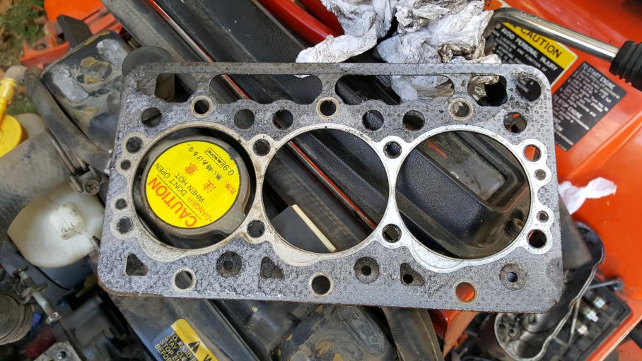

Why do I need to put in a new head gasket? Is the old one bad?
When a head gasket is tightened into place its soft metal rings crush between the hard iron head and block, forming an intimate fit to seal high-pressure combustion gases. After one tightening, the gasket won't seal as well again. It may seal enough to work for a while, but will usually fail early.
Can a head gasket be cleaned up and re-used? Yes. Is it a good idea? No. Microscopic leaks can act as small blow torches, damaging the head and/or block, or pressurizing the cooling system, mixing coolant into the oil, all manner of bad stuff. Don't take the chance. Put on a new head gasket.

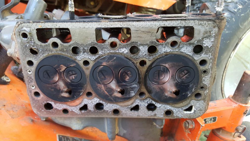

In the future it may save you some work to try to determine what the possible causes of the problem might be before tearing into an engine. As North Idaho Wolfman suggested, knowing the compression readings help determine the problem you were observing. Because this eliminates a major breakdown of the entire engine.
Characteristics of the engine would also help others to isolate the problem. For example, has the engine ever overheated? Have you done maintenance regularly..does it have correct oil level? Have you noticed any unusual noises while it's running.....etc.?
If you plan on keeping your machine, and want to know the upper part of the engine is OK, you can take the head to a machine shop and have it magnafluxed for about $40. This will confirm the head is not cracked. They can also make sure the valves are seating correctly. This is not necessary, but sure provides peace of mind at a minimal price.

As D2Cat said, since you have it off, have it magnafluxed to check for cracks. They can also check for warping. If it is warped, sometimes they can machine that out. If it's warped to badly, it would have to be replaced. As for cleaning, it comes back from the shop pretty clean. Anything else can be cleaned with a wire brush and steel wool. None of this is prohibitively expensive except for the head replacement.

The first picture you posted. In the upper right hand corner is a nipple stinking up. The o-ring goes there. Get the correct one, don't guess. Cost about $1.25 at dealer!
You don't need to get the head "sanded down" until you have it magnafluxed. That process will tell you if there is a crack in the head. If the head has a crack it become a boat anchor, and you find another one.
When the machine shop has the head, they can give you advise on further machine work needed, if it needs any.
That "sanding down" you were told about is a process used the make the head "flat" again on the bottom if it is warped (sometimes caused by extreme overheating). It's actually a milling process often called "resurfacing" a head.

The nipple sticking up from the block had an o-rong. Its quite clear in the pictures. Where it went is anybodys guess. Usually packed with the new head gasket.
