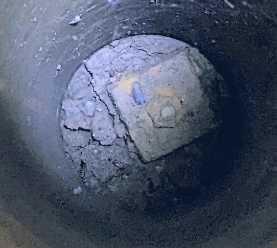

First, I did NOT drop my phone in the hole but I did get a picture taken!
It doesn't look like it uses a church key but it does look like a shutoff of some sort.
Oh and for the record that's about 5 feet under ground.
Is that nut metal?
That looks like a 2" square nut on top of a ductile iron gate valve. Possibly much bigger than a curb box. Never saw a curb box with a nut that size.
2" or so is standard water main gate top nut size - - 4" up to 16"...maybe bigger. Usually, there's a ductile iron riser in the street. On a lawn, no need for DI.....
Curb boxes are often ball valves.....think 3/4" valve with a small square nut or tab. 90 degrees on/off.
It's possible the utility got water curb boxes with 2" nuts. Never seen it, but doesn't mean it doesn't exist. ;) Saves on tools, and curbs boxes can be a hassle.
A 2" valve key is much more heavy-duty than a curb box key. That tool could easily break a curb box......so not sure how viable that theory is.
So I'm not thinking that's a typical 3/4-1" curb box.....

I really don't know but it looks like it is. I mentioned in one of my posts above that my shutoff is in a box up closer to the house and appears to use a more typical key. This is on some property (10 acres) we bought next door that once had a house but I never found the meter/shutoff for it. I'm considering getting water back on at the new property just to help grow some grass/clover for the deer but I'm having a hard time committing the $$.

Check with your water provider. They should know exactly what property it is for.
