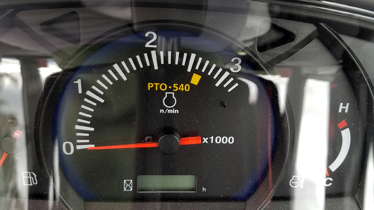

Neither the MX nor the M have red line indicators on the tachometers so what's the maximum RPM allowed? Do these tractors have rev limiters to prevent over revving the engine? I'm not concerned about the MX because the rpm is set with the throttle slider, but the M with its low gearing and accelerator make it very easy to rev the engine above the rated value.
M6060 manual states rated rpm is 2,400 and PTO 540/540E rpm is at 2,160/1,828.
MX6000 manual states rated rpm is 2,700 and PTO 540 rpm is at 2,660
MX6000 tachometer
M6060 tachometer

Rated RPM is where the engine HP is also rated.
The marked RPM on the tach results in 540 RPM on the PTO shaft.
The engine on a diesel has a governor and can not (normally) run above a limiting RPM but the engine could run above that RPM but generally not for very long before it blows up.

Rated rpm is the engine speed that delivers the advertised horsepower. The computer won't let you overspeed the engine. In other words, as far as you can push the throttle lever or stomp the foot throttle is oh-tay. In a runaway situation, all bets are off.

I understand what the RPM mark on the MX tachometer means and also what the M6060 manual means re engine rpm and pto rpm, but I wasn't sure if I could safely run the M6060 over 2,400 rpm. It's a relief to know that the engine rpm is governed so that I can't damage the engine. There can be a lot going on in the cab, when it's all new anyway, and I've exceeded 2,500 rpm a few times.
