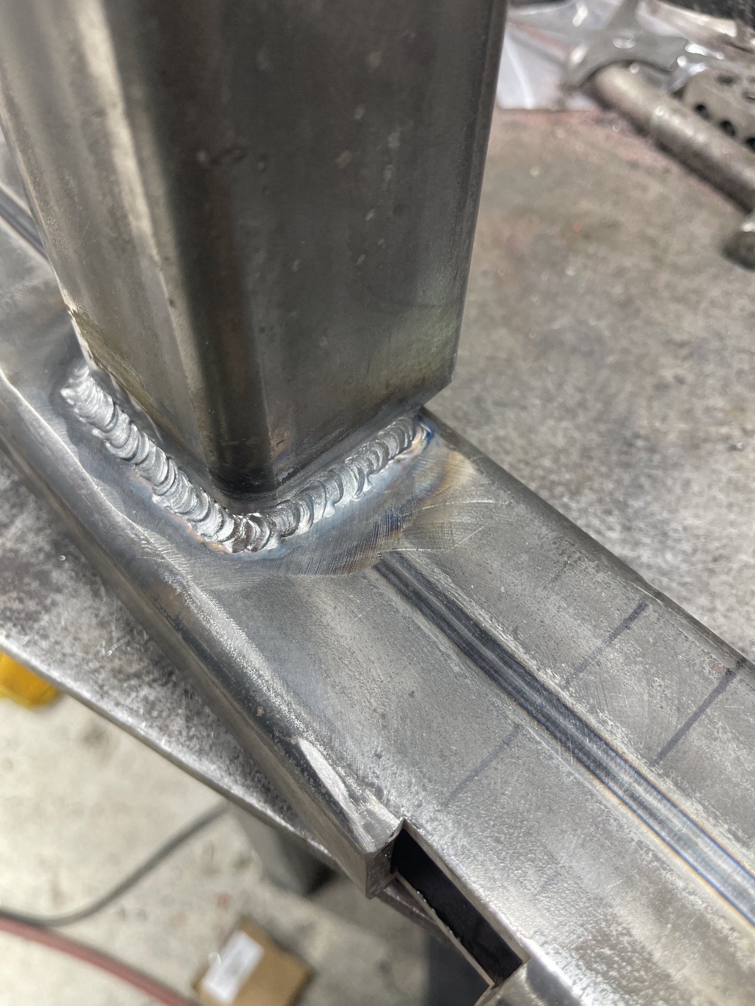

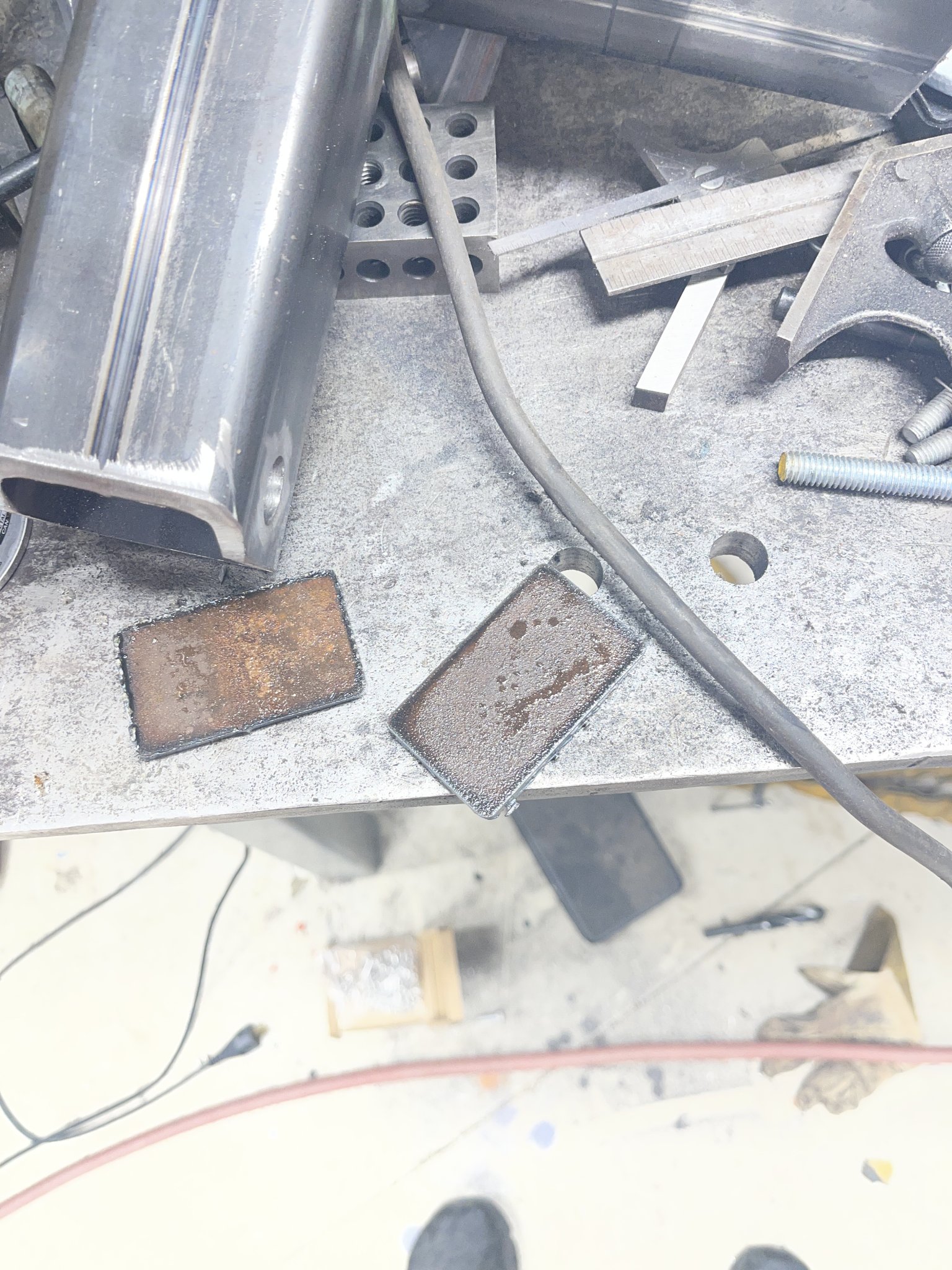

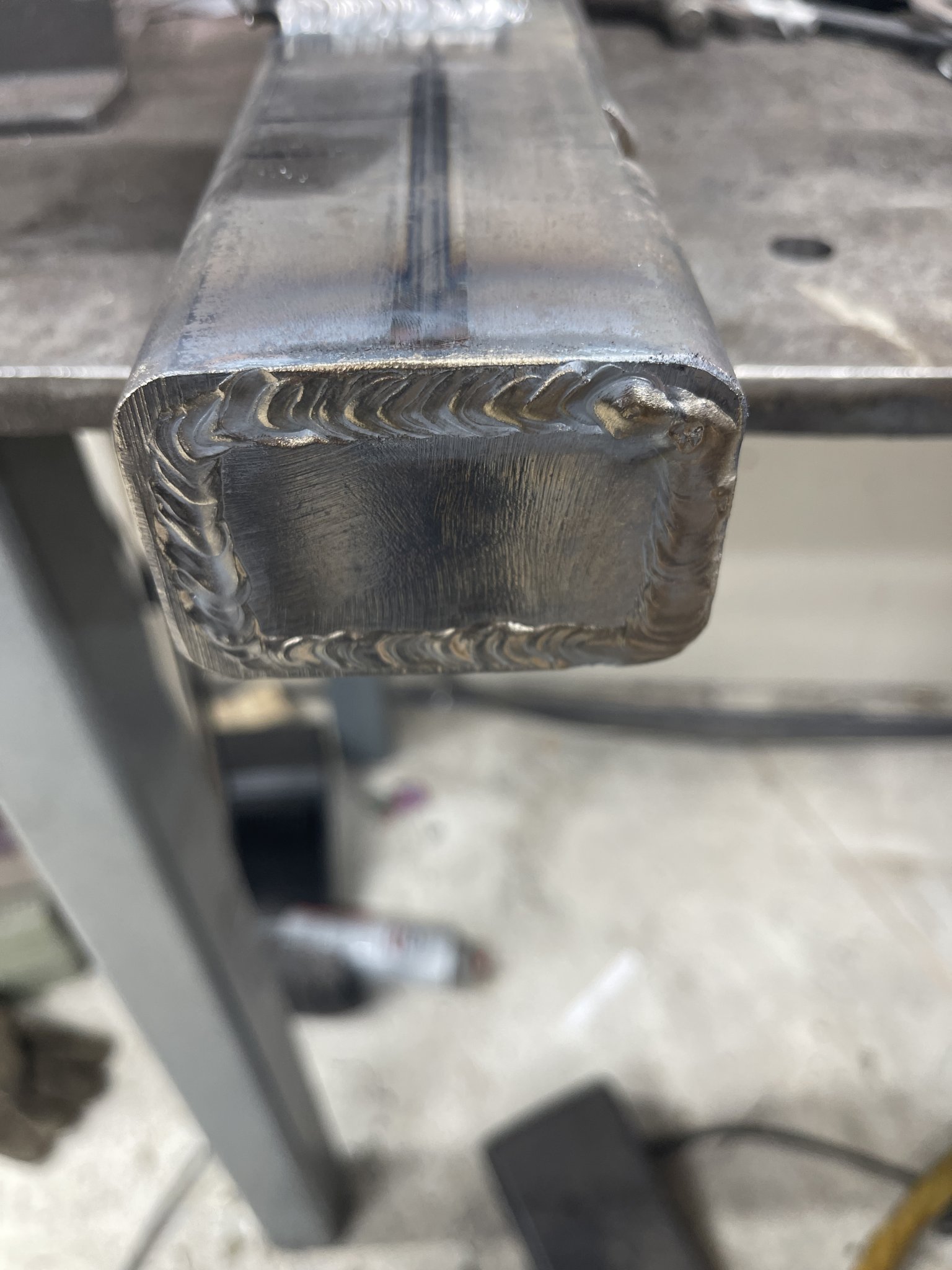

Now it’s off to the CNC Plasma cutter to knock out the “end caps” from a plate of “mystery metal"

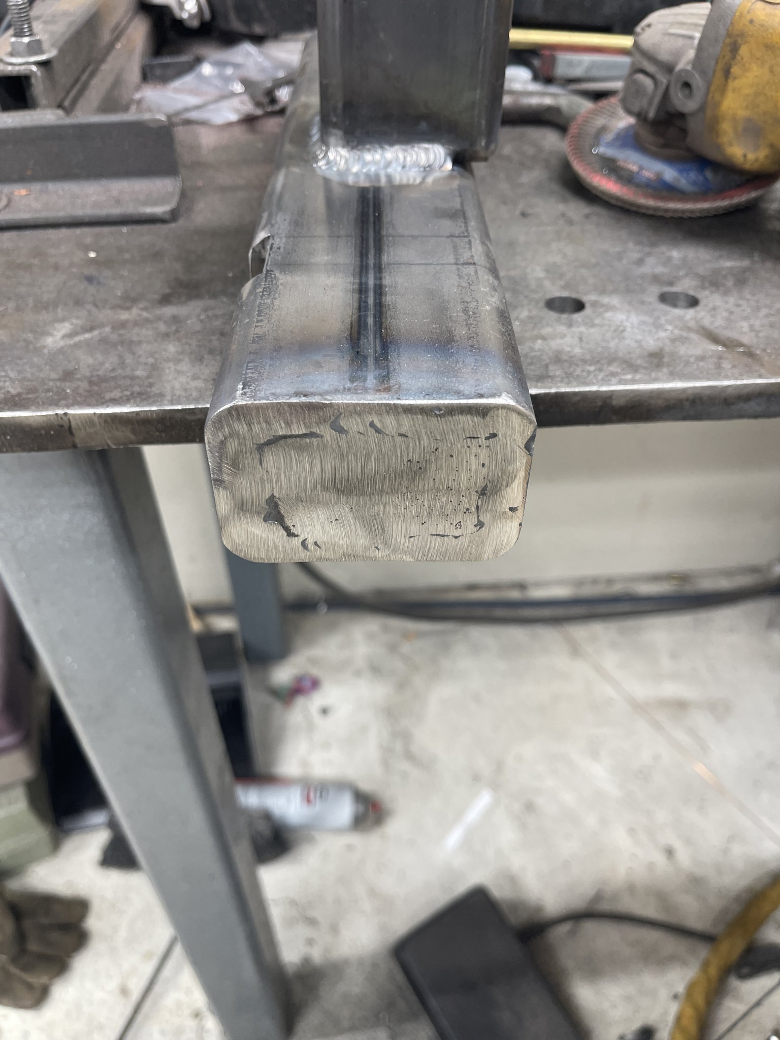

Now for the “fun part”……..TIG WELDING!!!!!!!!
I clearly need some practice, but it’s dosen’t go too bad.
It’s not NASA quality, but it should be “Rhino good-nuff"
Sadly though…..The welds need to be “ground down” to make it fit…….

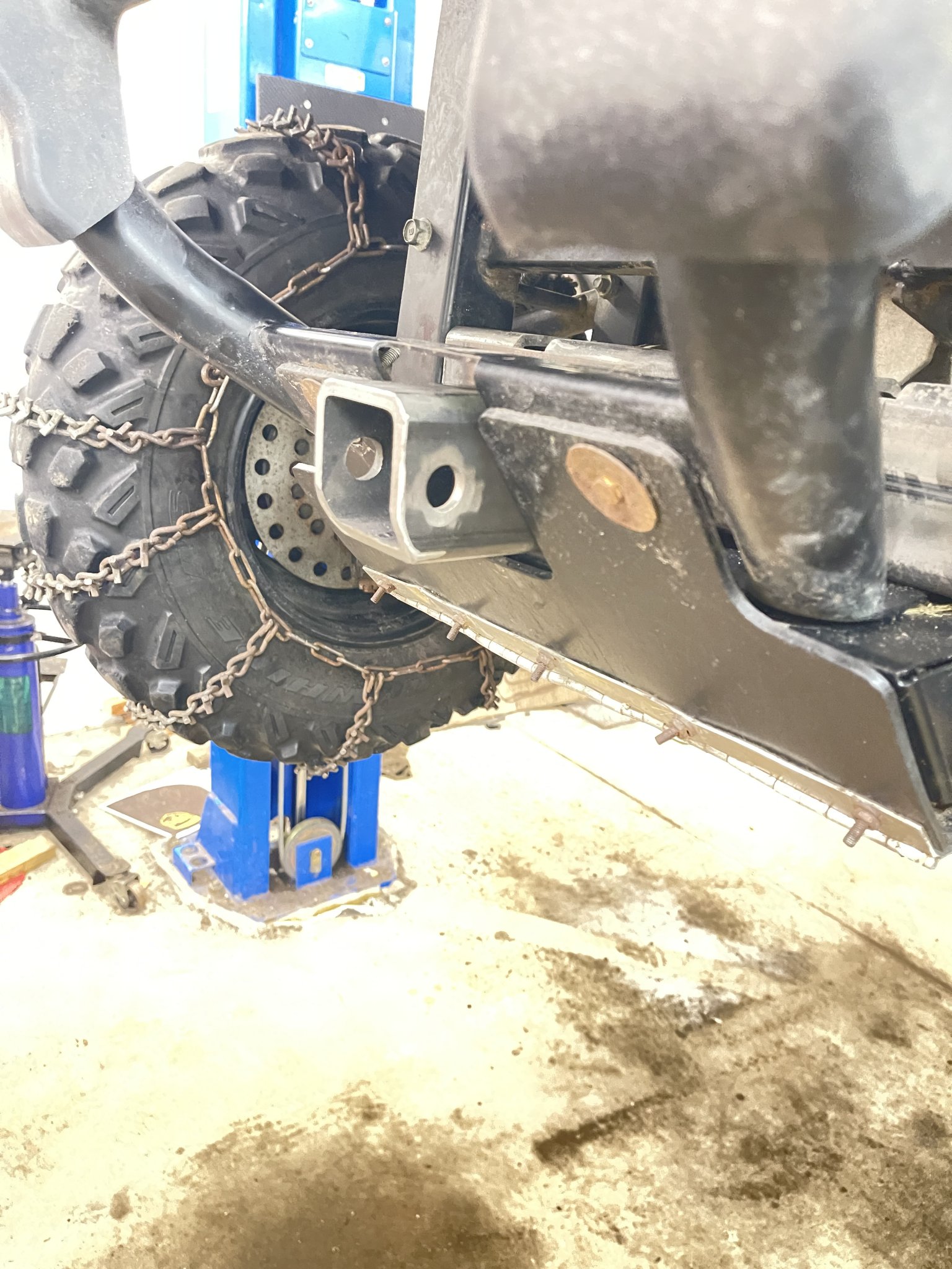

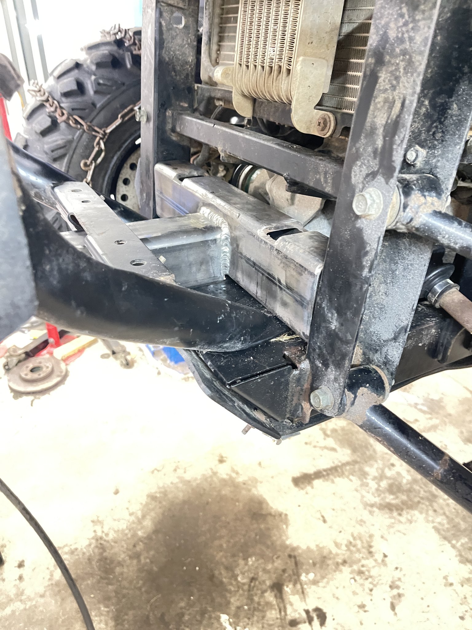

Well now it’s time for another “test fit”, and I decide to bolt her in place before I try to locate and drill the Vertical holes.
She’s looking pretty good, so I am stoked.
Now here is where things get “scary”……While I was putting it in, I “slightly boogered-up” the first thread (or2?)…….
Now normally this would not present a problem, however; I don’t have a damn 12 x 1.25 tap.

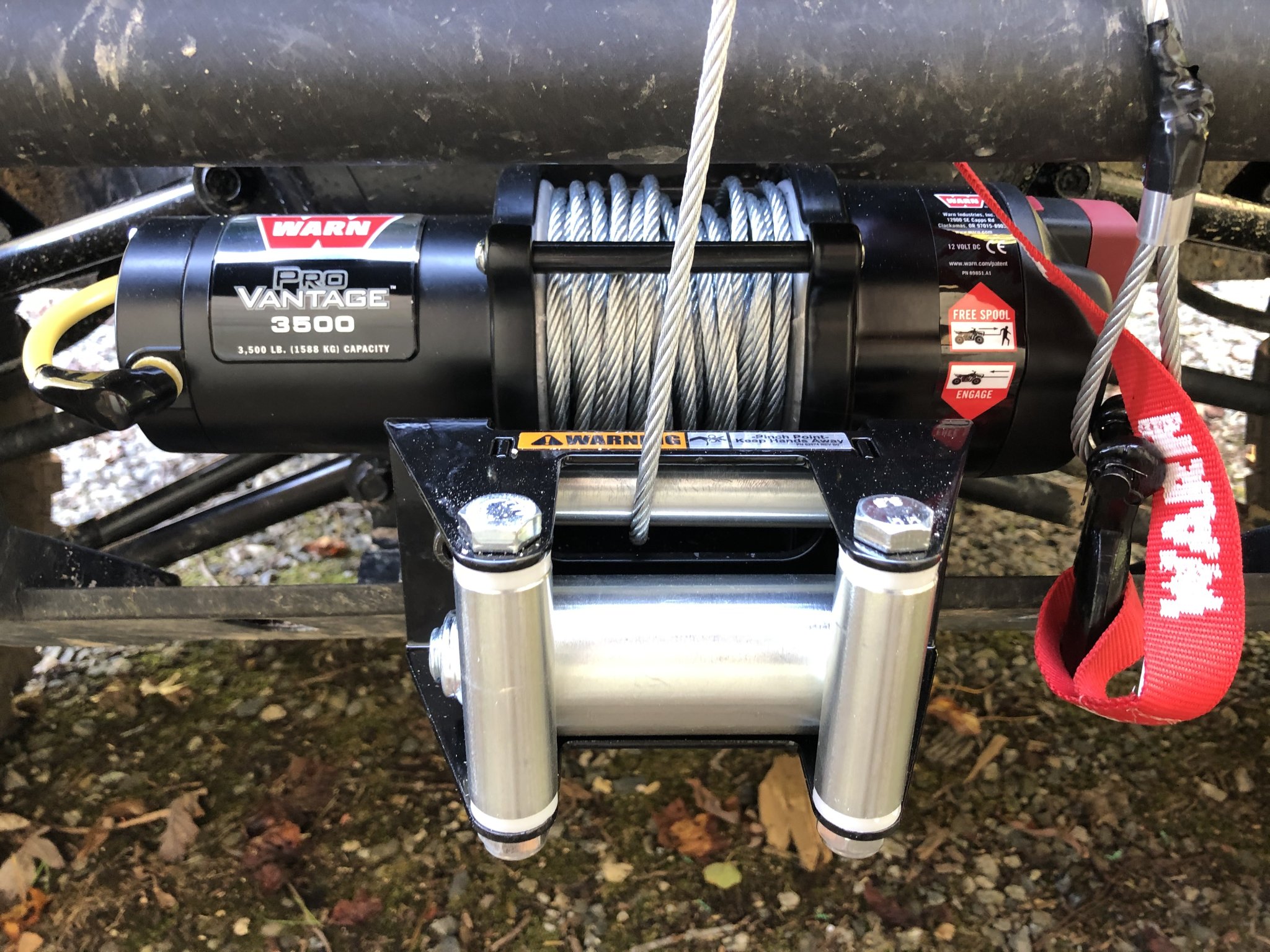

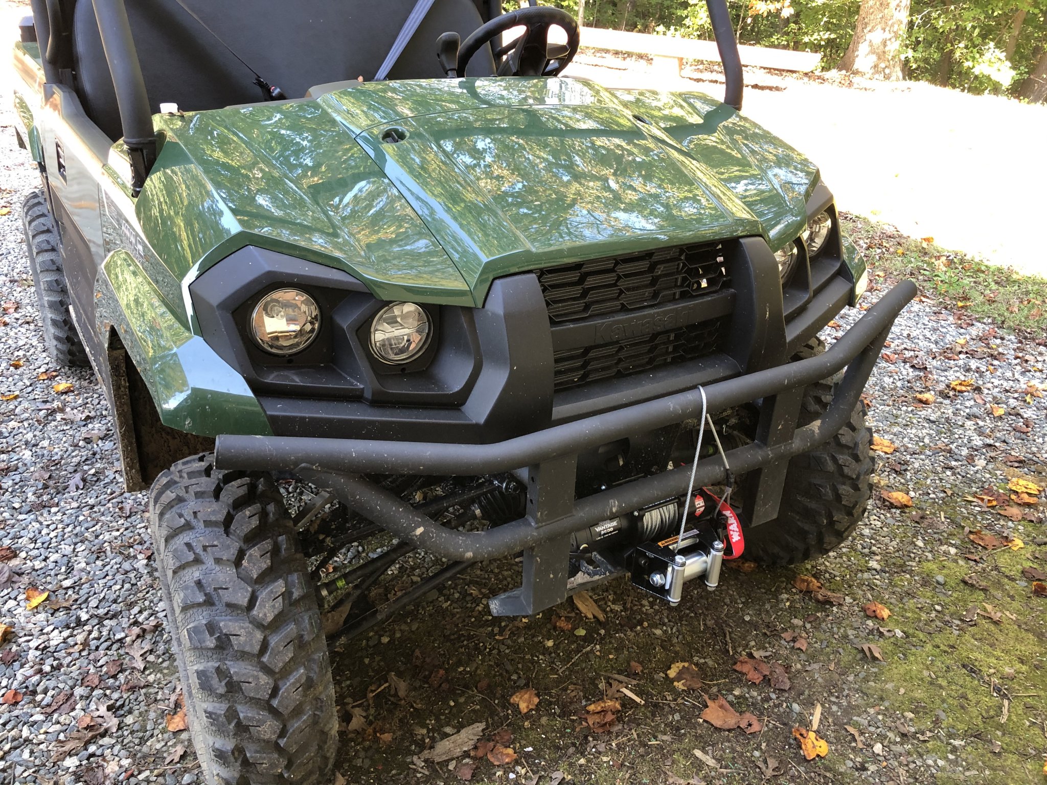

More on topic, interesting project you have there. One of the first things we did with our little Mule was put a winch on it. Don’t use it often, but wouldn’t want to be without it. It’s great for moving larger than man sized obstacles off trails and the occasional self recovery. Mostly, it lets us drive into questionable situations knowing if we don’t make it, it’s not that big of a deal. It would be nice to be able to mount it front or rear as needed, but of course mine is stuck on the front. With a snatch block or two, it will do a lot more than just pull you out of a mud hole. Fortunately for me, I didn’t have to do the fabrication you’re doing.

So I tap the holes
Then test fit it and
mark/drill the side holes for the cross bolt
I used a piece of “all thread” to pass all the way through instead of coming up with a way to try and “fish a nut” in there, then try to hold it.
Everything seems to line up well, and its fitting very nicely, so it’s time for some paints.
