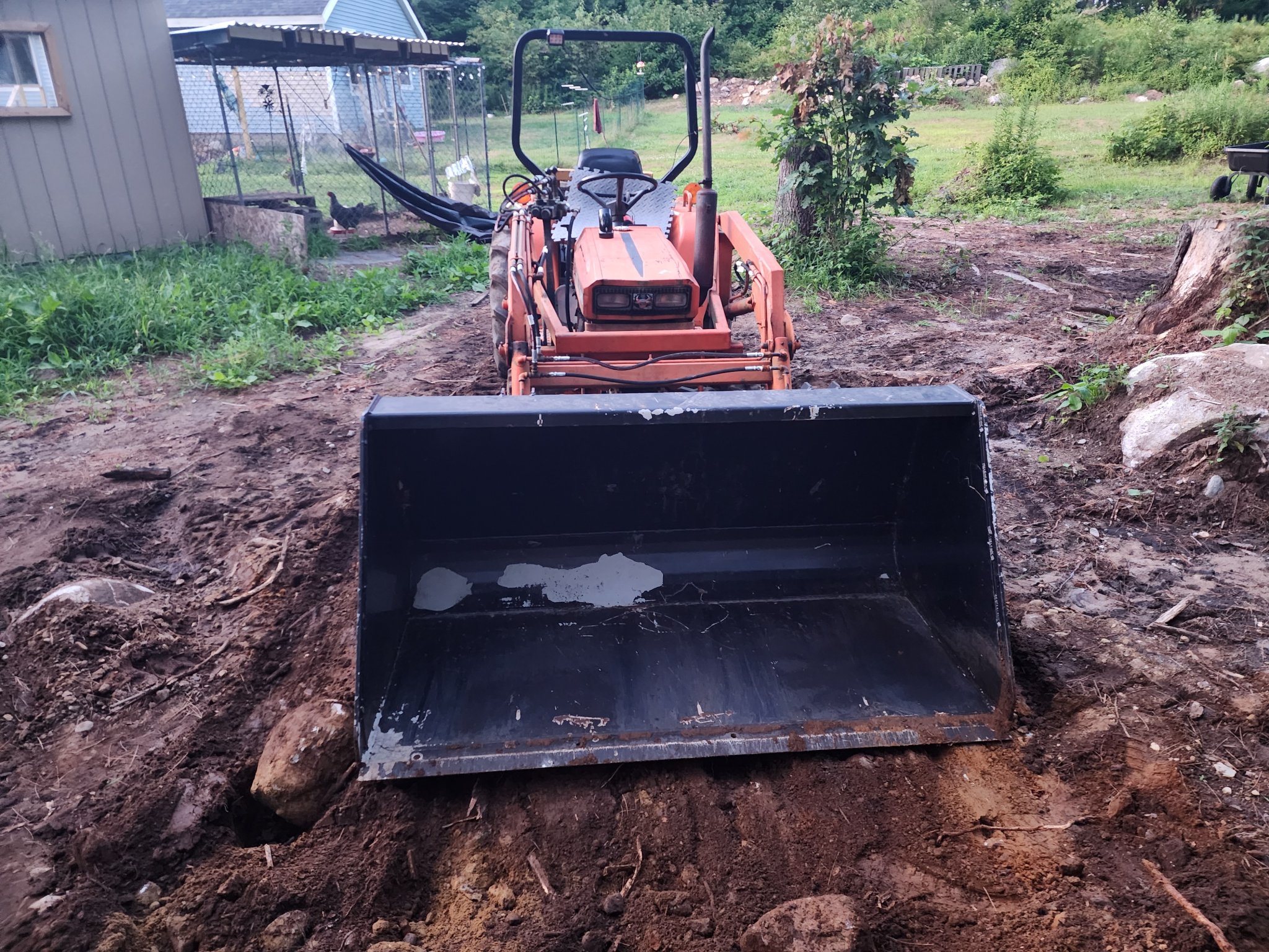

Is my bucket to big?
ferball
B8200
Jan 25, 2024
I picked up a new bucket for my BF300 loader. I did not realize how much bigger it was than the one I am replacing, I was so focused on finding something with the proper pin bracket dimensions that I did not realize it was 6 inches wider and 6 inches taller and I suspect its at least 150 pounds heavier. What is worse case scenario if I pin that bad boy on and start pushing dirt around?

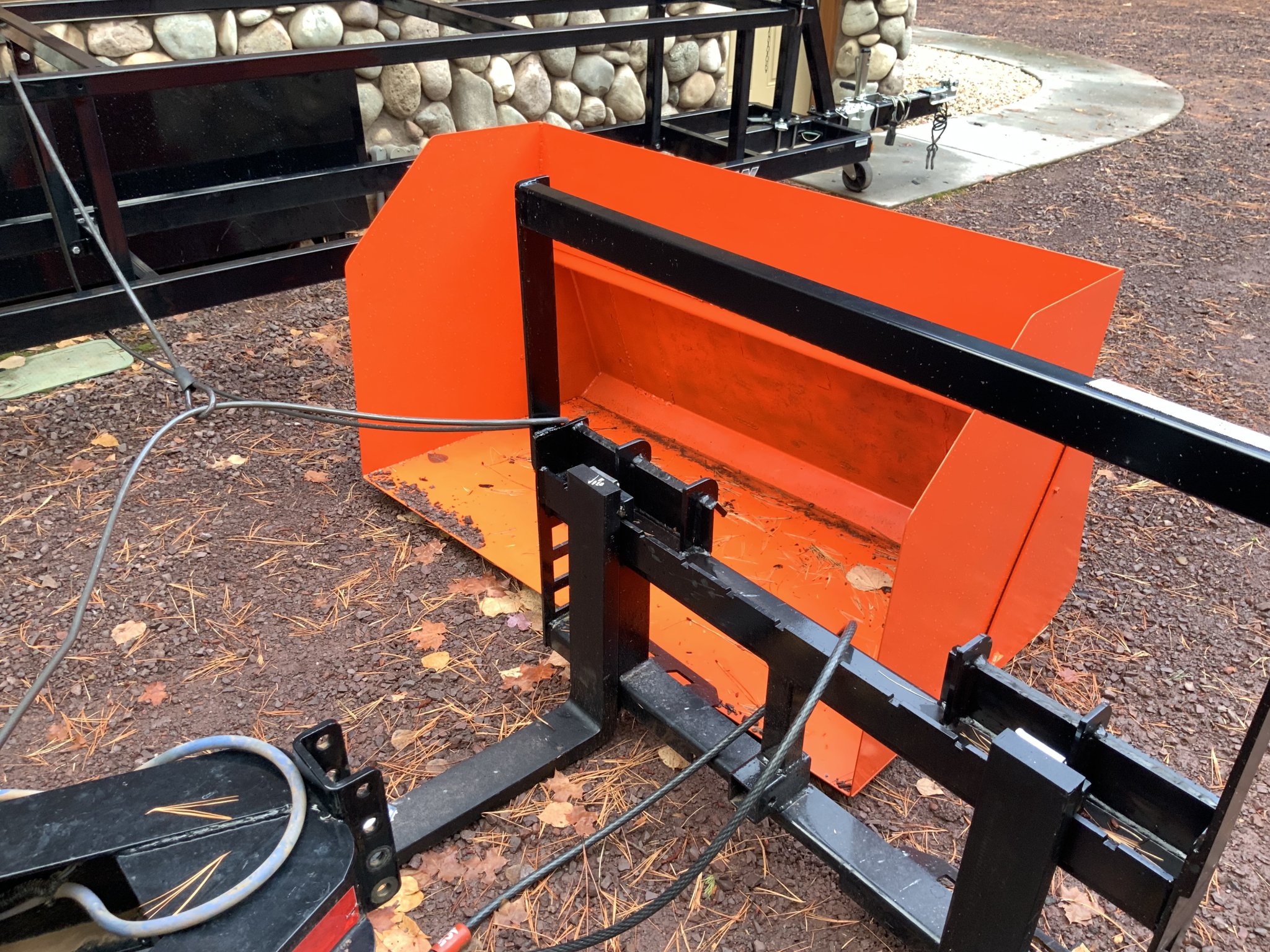

Here is an oversized one I made out of my old bucket when I went to QA…
I am very careful with it….it is only used for property clean up of pine needles and tree debris during my annual spring clean up. I used fairly lite weight sheet steel when I built it…probably 80 or so pounds more…but I can feel the difference and try to not overload it. Been great for 10 plus years. I would never dig or fill it with anything other than fluffy crap…

It is huge, but it is fantastic for grading and moving wood, I know there is no way it would do a full scoop of dirt, but a 1/3 to 1/2 scoop she does fine.
