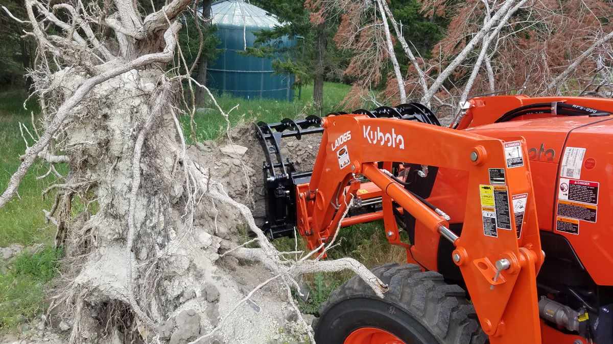

It really depends on how the OP is going to use the grapple and what type of grapple. If your grubbing brush, ripping up small stumps and small trees out, a lighter weight grapple will bend and not hold up.
If I had used a lighter, less quality made grapple, it probably would be scrap metal.

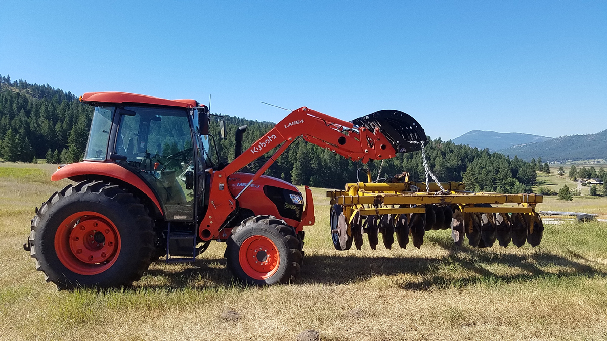

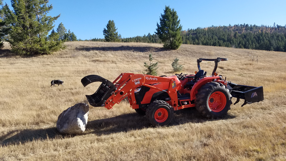

How do you equate lighter to lower quality? That's simplistic to put it mildly. I don't pick up and move sticks with my grapple. I move 2,000 lb rocks around and dig those rocks out of the ground with my 400 lb grapple. I pick up a 2,500 lb disc harrow with my grapple and a 1,500 lb plow. Hardox 450 virtually throughout, strong where it needs to be, no wasted steel and no damage after many hours of hard use, not pushing twigs around that my dog could drag out.
It's the OPs money, but steel is bought and sold by weight, and paying for 900 lb of steel when 600 lb will do a better or equivalent job makes lot more sense, regardless of whether you have 500 hours of moving sticks around or not.

Again, I said "If I had used a lighter, less quality made grapple, it probably would be scrap metal. I also previously mentioned AR400 steel in the teeth plate.
