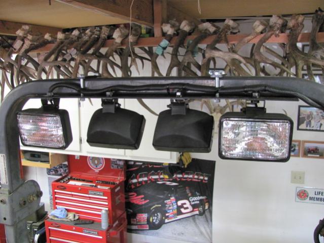

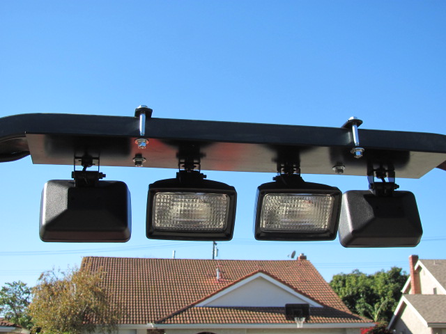

I just installed work lights on my L3830 last week they work great. I put 2 trapezoids to the front and 2 floods to the rear made my own mounting bracket as you can see in attatched photos I also installed seperate switches and fuse both front and back lights sepratly. I used Optronic lights great light for the money bought them at Oriely auto parts all 55 watt lights.... Dan[
