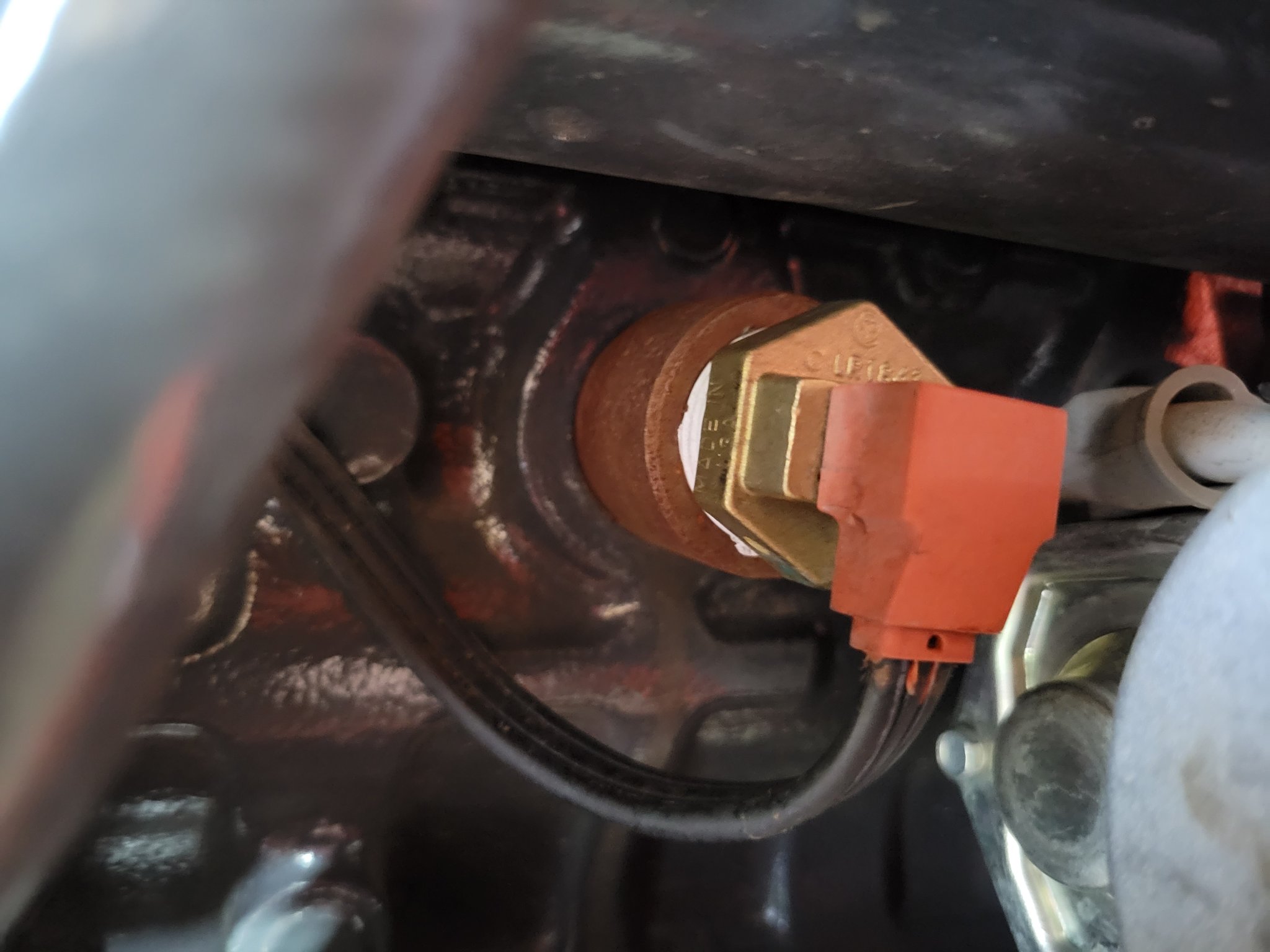

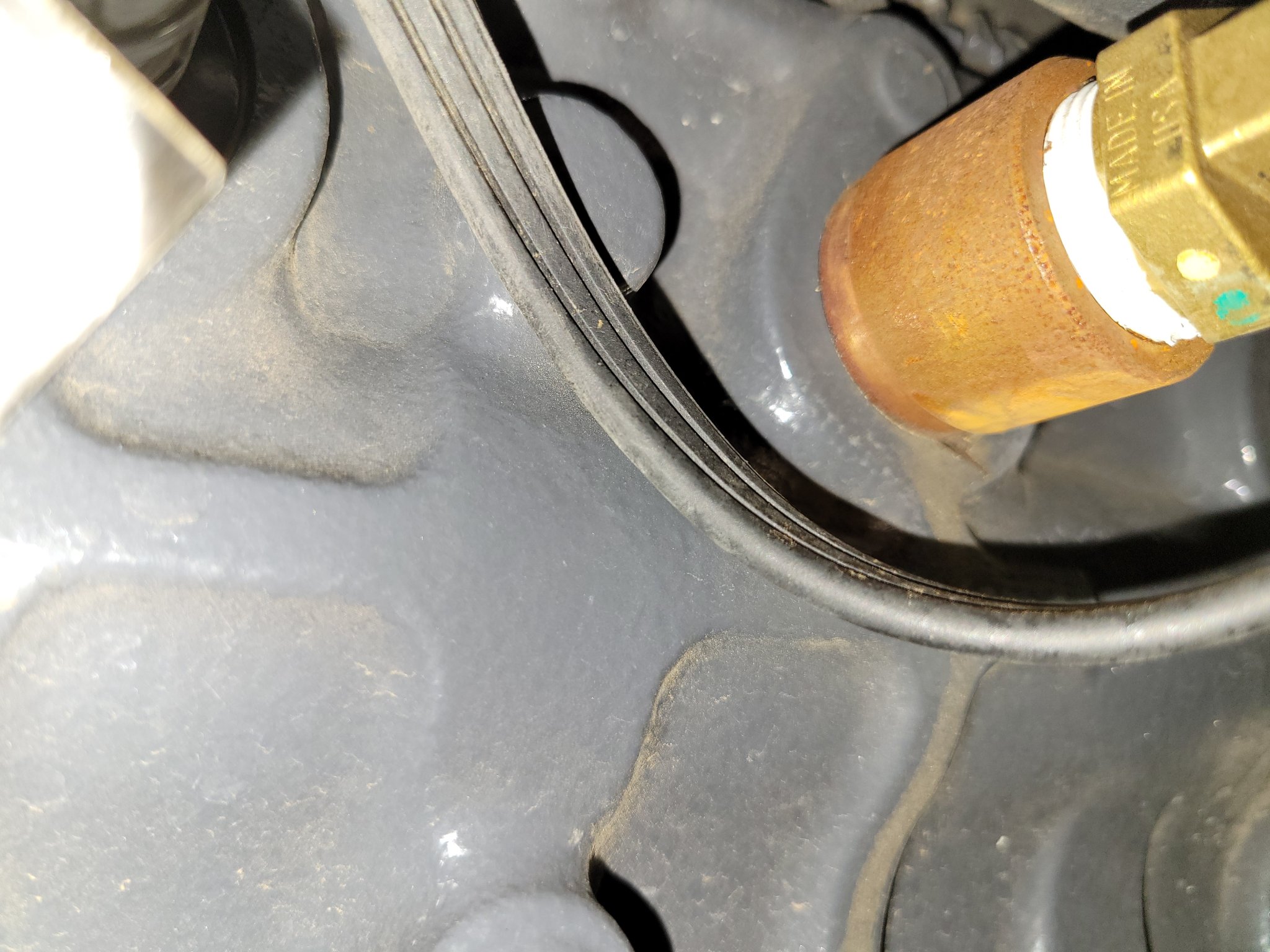

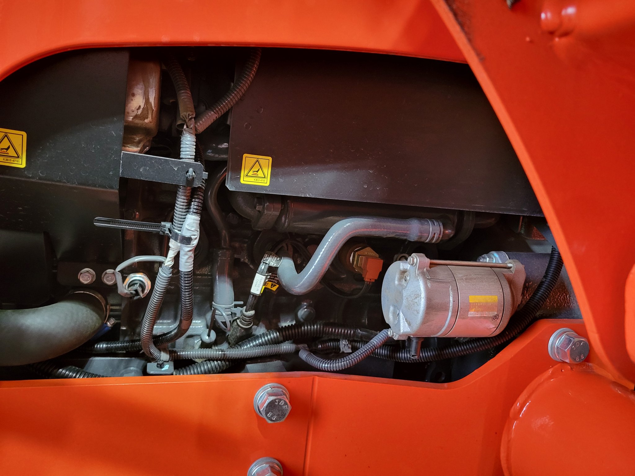

Here are pictures of my factory engine block heater on my M5660. 20221104_174320.jpg 20221104_174337.jpg 20221104_174351.jpg Mine looks like a pressed in bushing, press fit O.D. and pipe threaded I.D. and the block heater screws into it. Mine is installed forward of the starter.

I'll post a picture of my factory engine block heater on my 2020 M5660 when I get home for your edification. Mine looks like a pressed in bushing, press fit O.D. and pipe threaded I.D. and the block heater screws into it. Mine is installed forward of the starter.

Here are pictures of my factory engine block heater on my M5660. View attachment 89919 View attachment 89920 View attachment 89921 Mine looks like a pressed in bushing, press fit O.D. and pipe threaded I.D. and the block heater screws into it. Mine is installed forward of the starter.
Thank you so much. That helps a lot. I was looking for an Allen wrench type plug like I saw on a YouTube video, but I see now that the block heater goes in place of one of the freeze plugs. I did not know what a freeze plug (aka core plug) was when I started this journey :)
