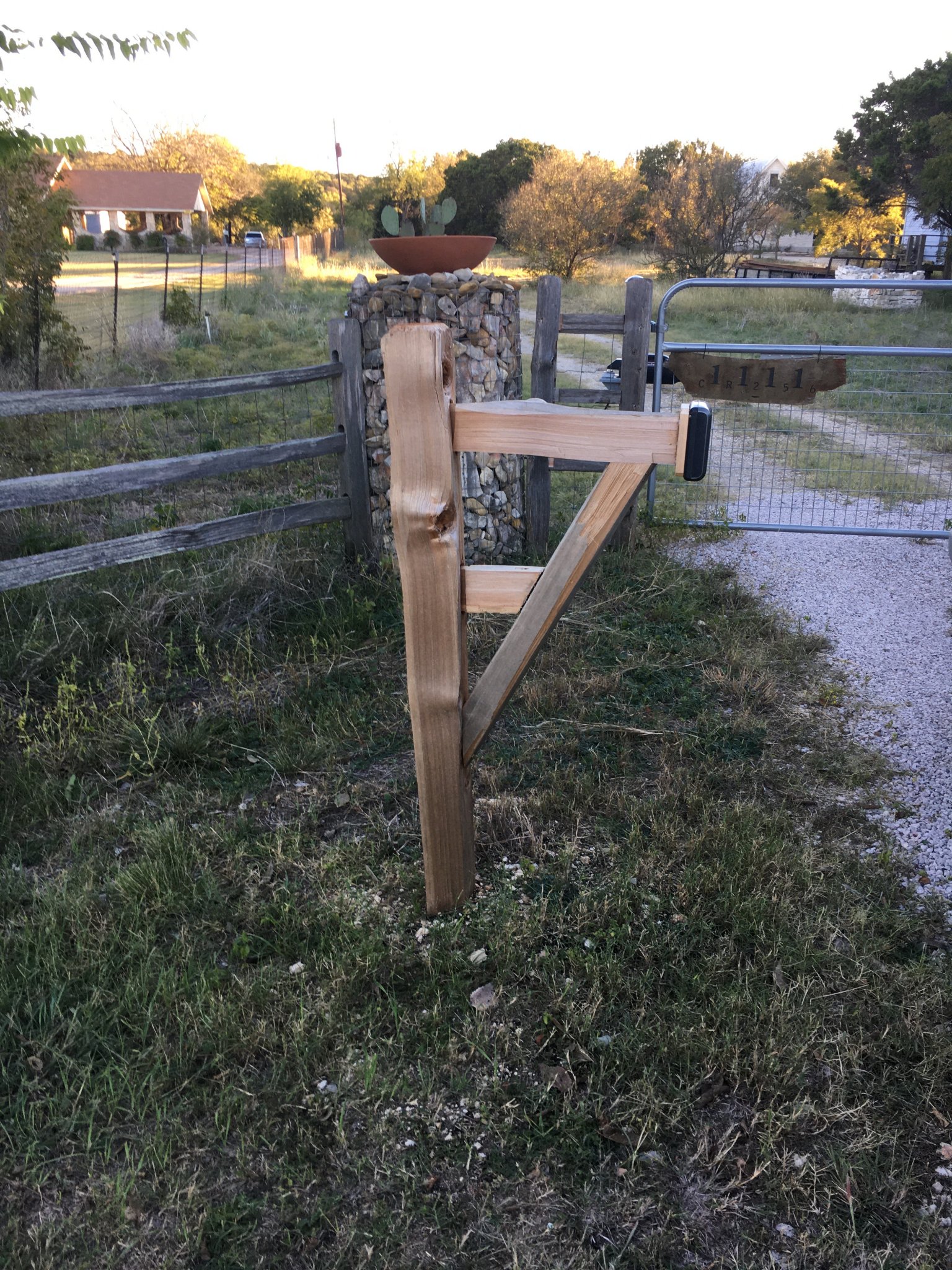

Well a little update to call it finished.
Here is the keypad post I built to match the fence.
The only complaint on anything is that the Cartell free exit sensor failed but that was probably due to the length of time to get it buried was long. The replacement one has worked well and no problems with it since I buried it right away.
There are a few embellishments to add like an indicator light to show when the gate is closed at night; a couple of signs for the address will be added to conceal the opener behind the signs to tidy the appearance up and that is about all that I have planned.
So I will probably post again in a few months to report on how it works over the long haul.
So far it has been worth the investment of time and money.
