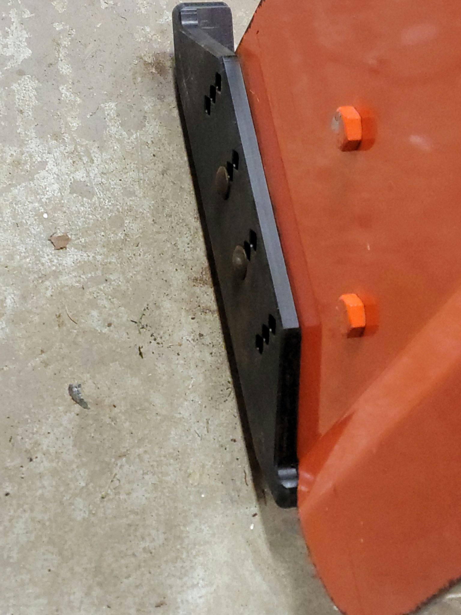

Installed these today - Robalon Skid Shoe. Hoping it stop any scrapping on the driveway pavement. Perfect fit for my 2755HD

what material are they made of?

Here's the description:
PRODUCT DESCRIPTION
Robalon replacement snowblower skid shoes are salt, age and wear resistant. Robalon lasts 2-5 times longer than painted steel, and 3-4 times longer than stainless steel or injected molded plastics. They have been factory wear tested for proven long life. No marking on concrete. Will not scratch pavers or exposed aggregate.
A220BS Applications: Replaces
77700-02283
NOTE: Robalon Skid Shoes Sold In Pairs
  • No scratching of pavers, stamped concrete, or garage floors. Will not leave rust stains.
  • 2-5 times longer life than Steel shoes and 3-4 times longer than stainless steel and injection molded plastic shoes
  • No breakdown from road salt, sprays, or sunlight and allows smoother operation for easier steering

Can you measure them? Went to their web site but doesn’t list dimensions. Look nice.

Did your steel shoes wear out and that is the reason for these new shoes?

Are they bigger than the original ones?
11,420
4,908
wow...
check the price then saw that's for ONE !!!!
OP place it's for a PAIR of them....
ROBALON is probably UHMW, so back to making my own......
from google...
... ROBALON is a highly wear-resistant UHMW-PE-based material

I'll measure them in the morning for you. They're the exact same size as the steel shoe that came on the blower. I'll post the measurements

Different blower and shoe configuration, but I put some 1/2” thick UHMW liners on my steel shoes years ago.
Amazing how resilient that stuff is. Hardly any wear after several years.

Yep, sheets or sticks are fairly inexpensive. I put Delrin pieces on the shoes of the (walk behind) snow thrower. Robolon is $$$ apparently. But hey, if it works....

I wanted to follow up on the Robalon replacement snowblower skid shoes. I've cleared a good amount of snow over the past few weeks. These shoes are awesome.
I added an additional cutting blade to the bottom of my blower to get closer to the driveway. I have about am 1/8 inch of snow left on the driveway after clearing.
The shoes leave no markes or scraps, they don't even dig up the grass when I clear a few inches of the driveway.
My opinon, GREAT PRODUCT
