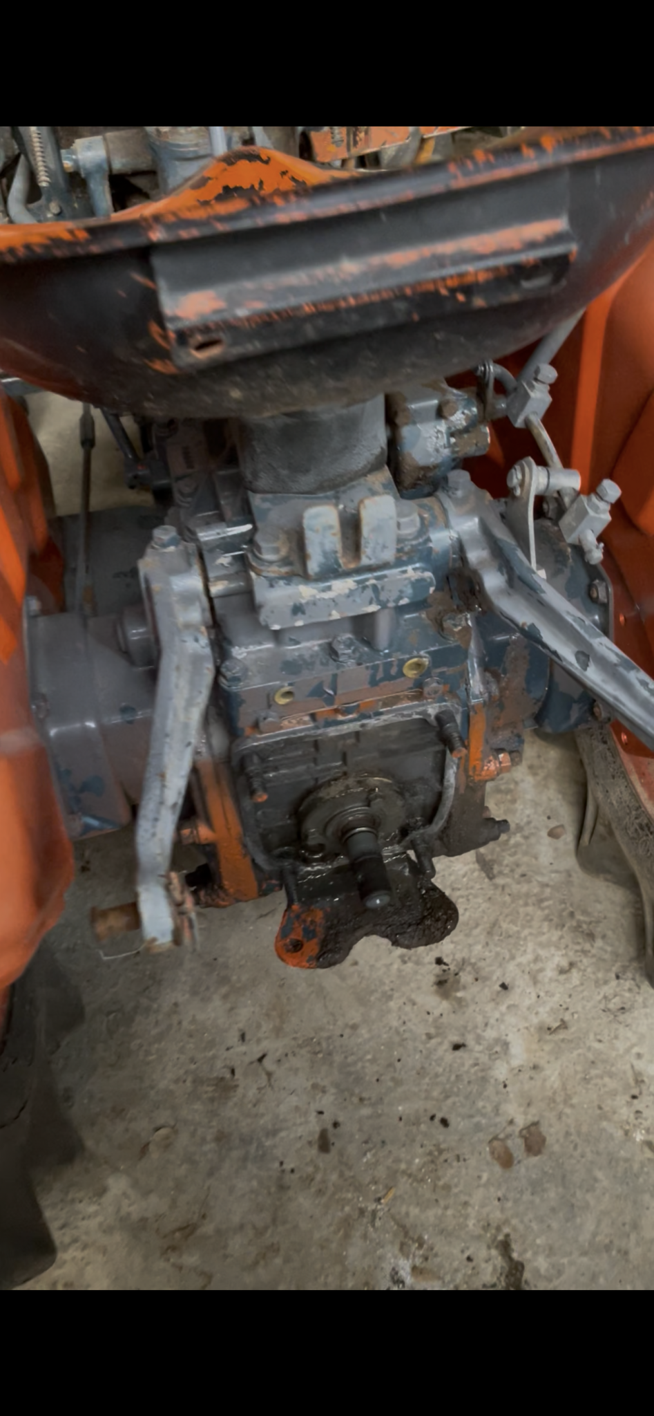

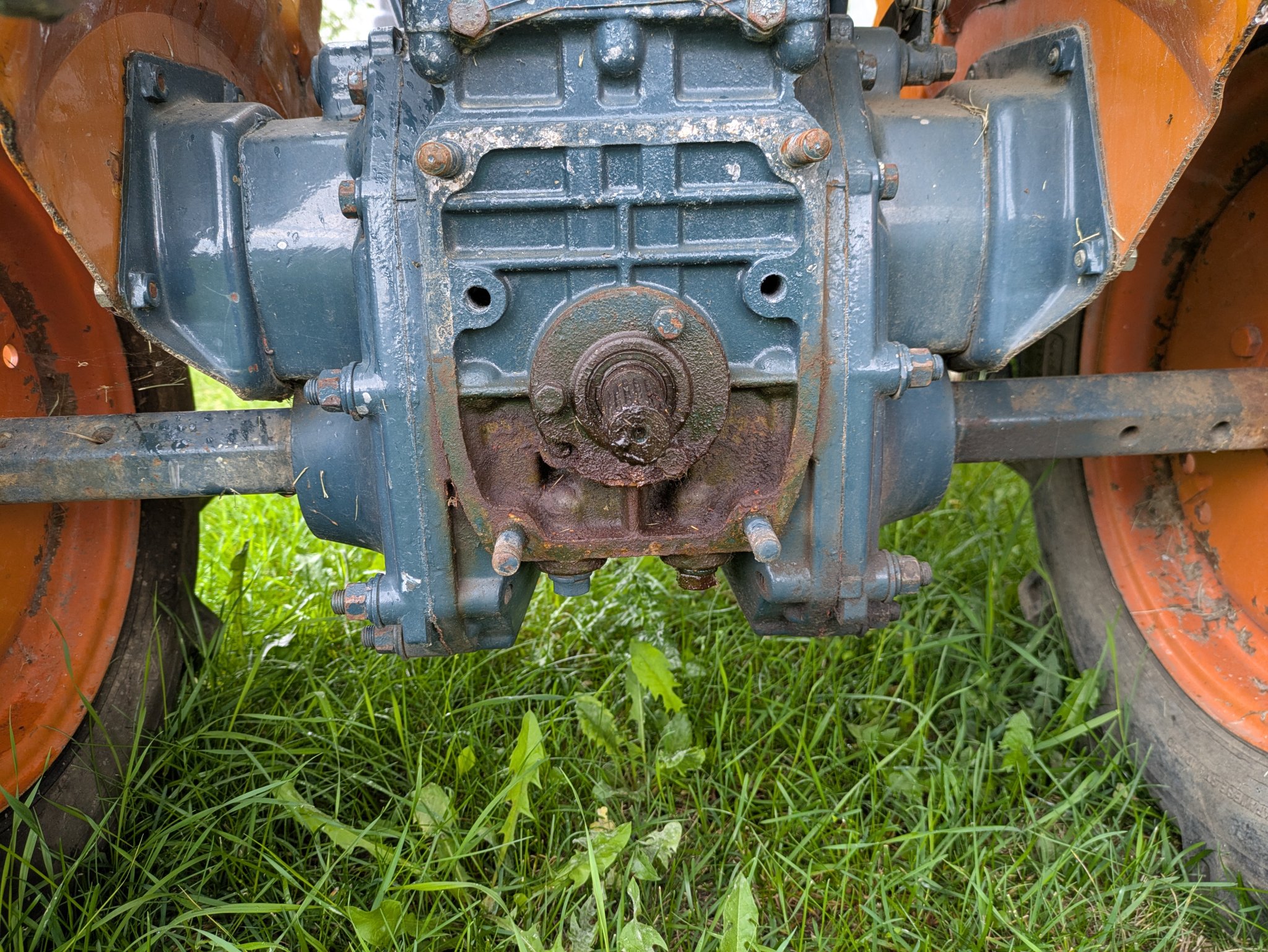

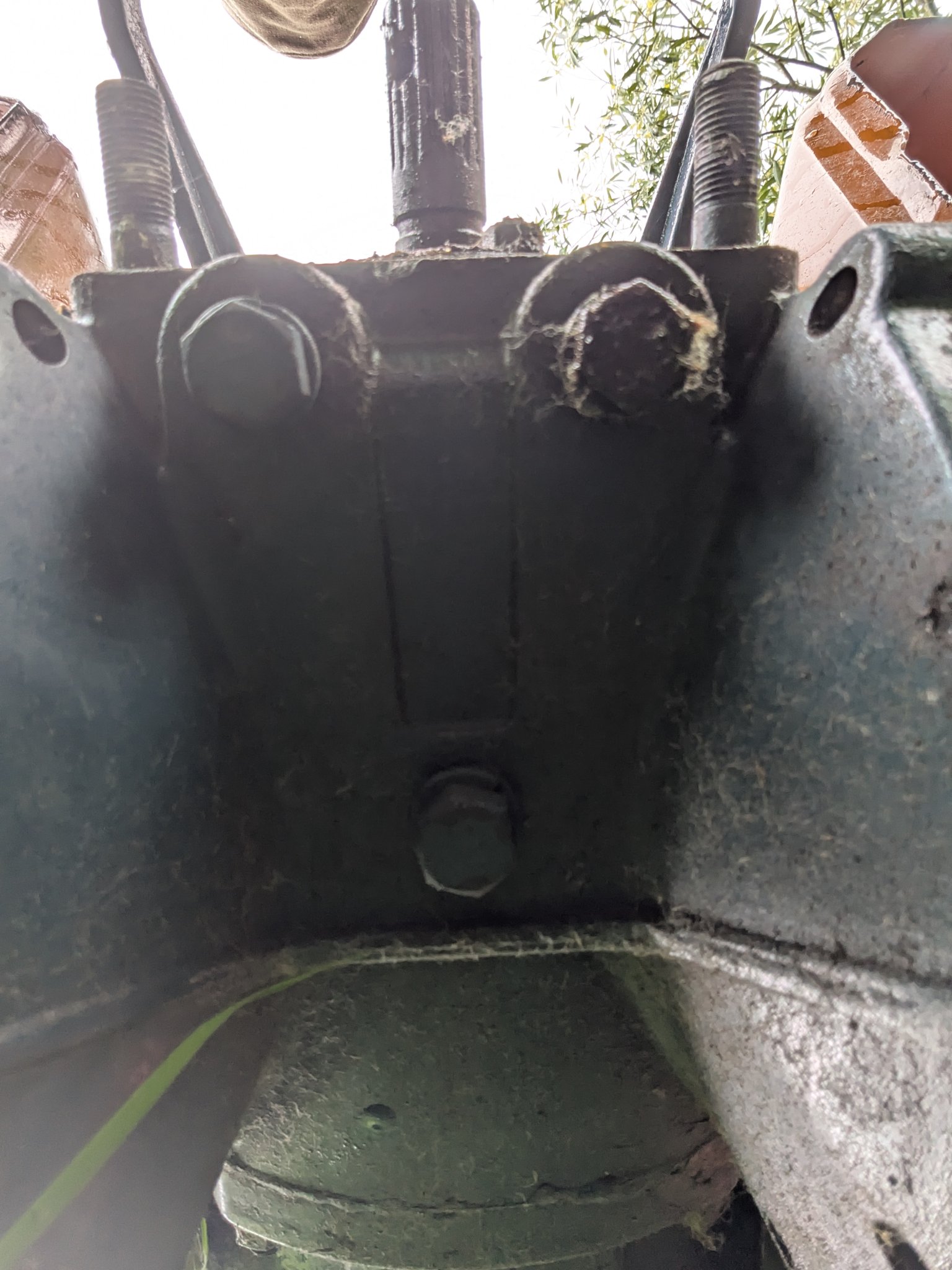

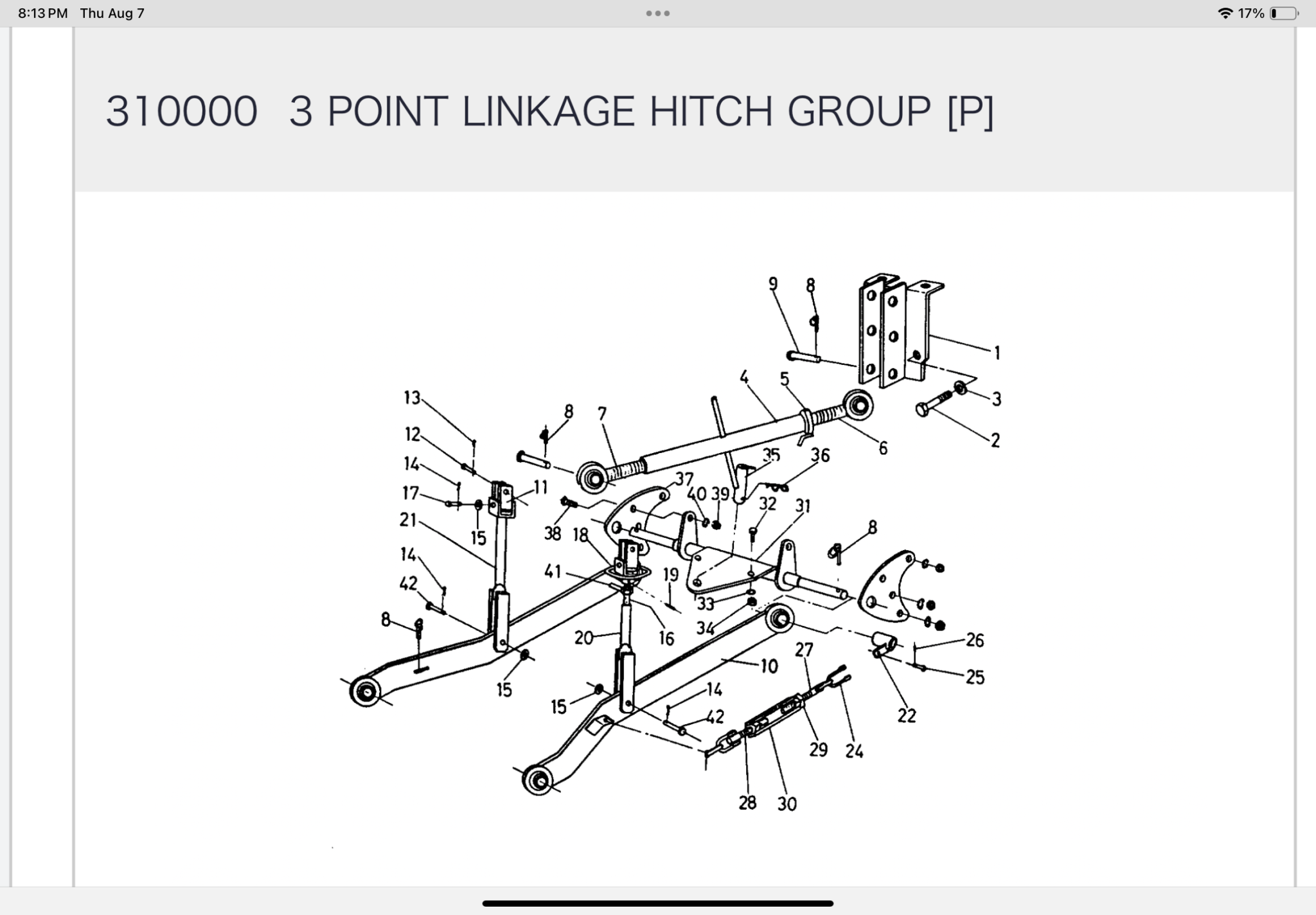

Hola, quiero instalar los tres brazos en mi Tractor Kubota B6000 pero nunca se le había puesto un cultivador ni ningún accesorio como desbrozadora etc y no tiene nada más que esto que adjunto en la foto. Además de colocar un inversor de giro quiero instalar estos brazos como el tercer punto y los dos inferiores pero no tiene anclaje para poner el eje inferior ni sé cómo va. ¿Que necesito? Estoy un poco perdido.. Gracias

Hello, I want to install the three arms on my Kubota B6000 tractor, but I've never installed a cultivator or any other attachments like a brush cutter, etc., and it doesn't have anything other than the photo attached. In addition to installing a reverser, I want to install these arms as the third link and the two lower links, but there's no anchor to attach the lower axle, and I don't know how to do it. What do I need? I'm a bit lost. Thanks.
6,442
2,064
Looks like you are missing a few pieces that allow the mounting of the arms.

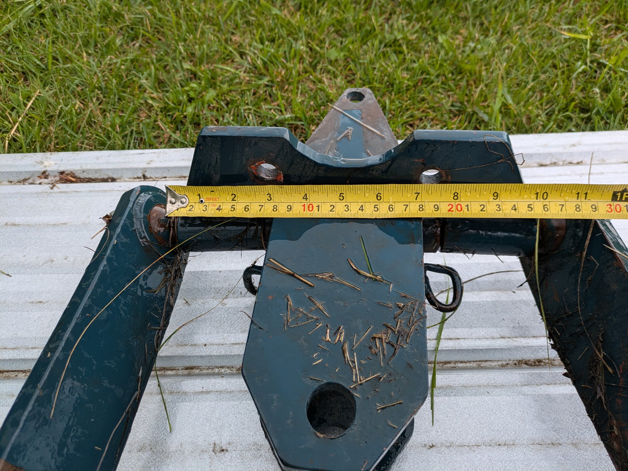

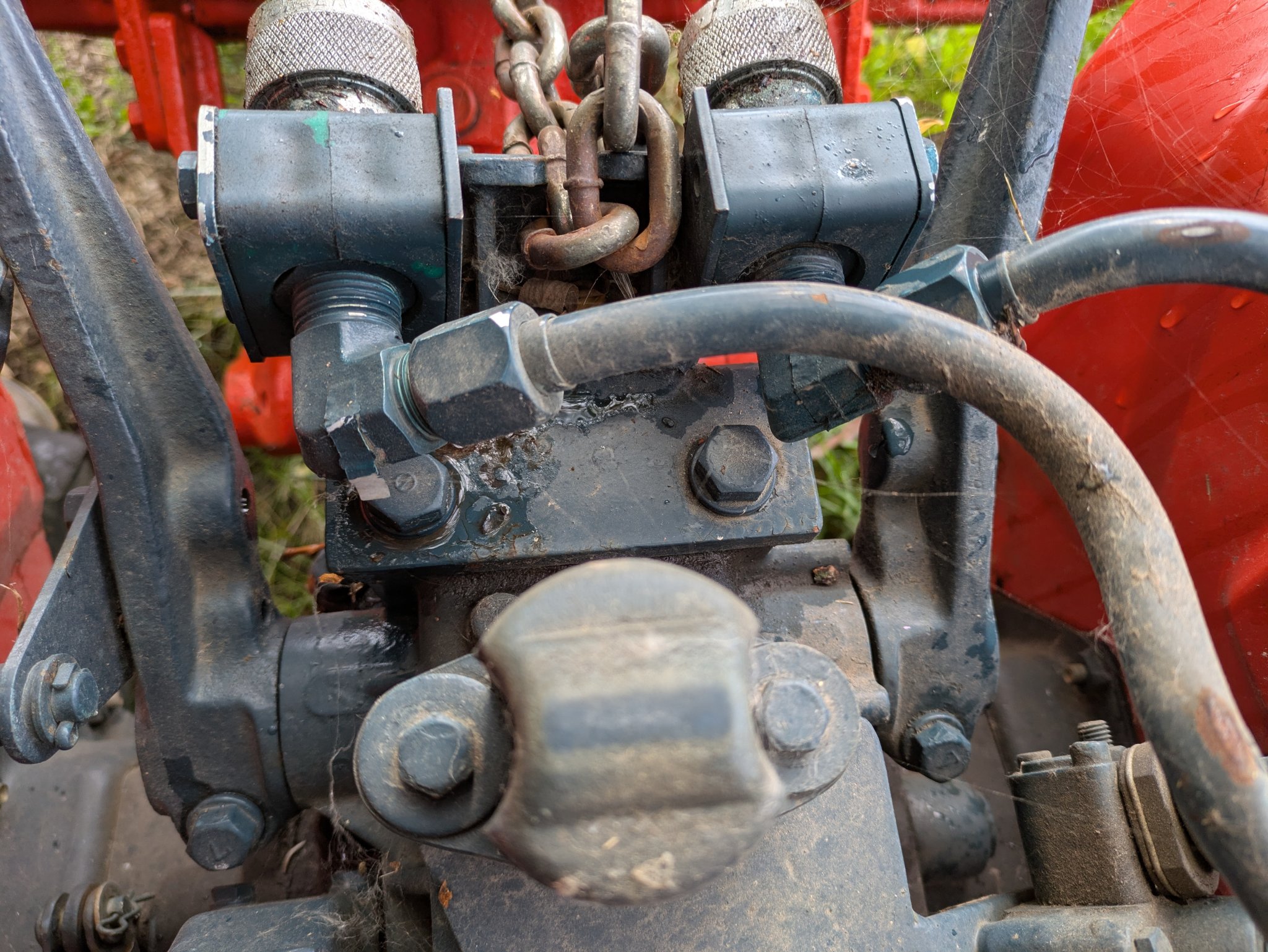

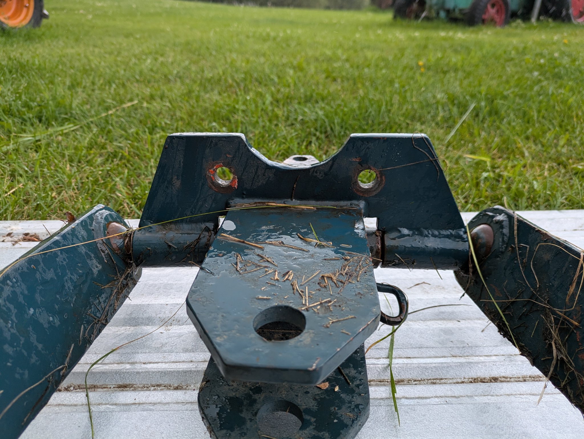

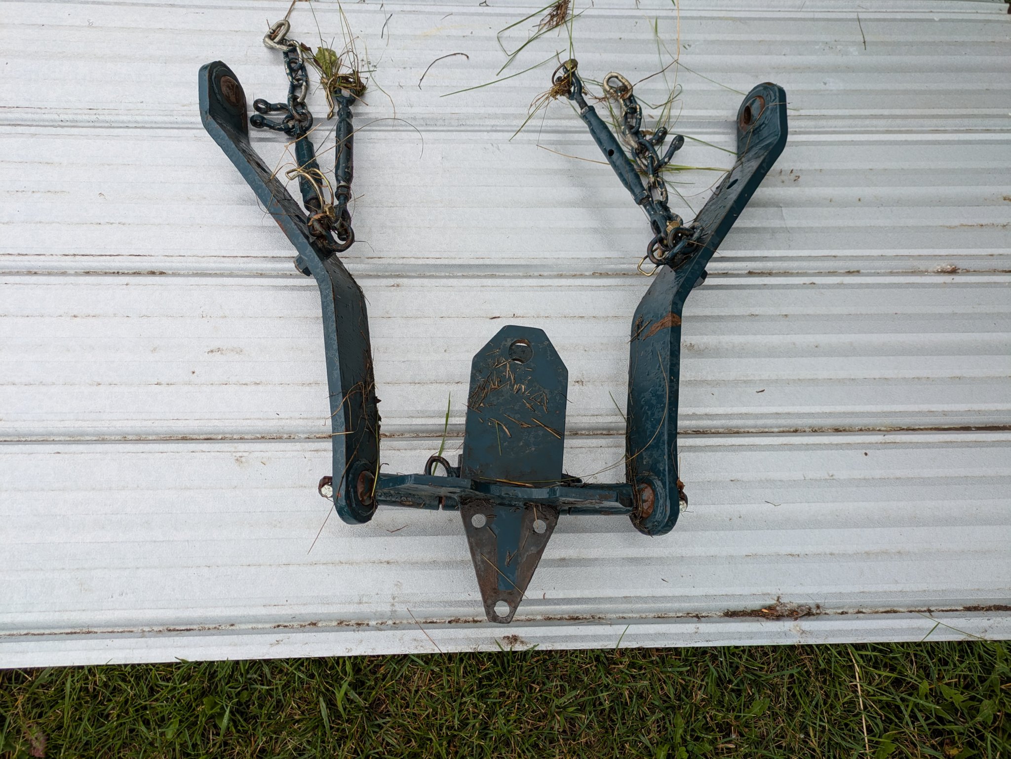

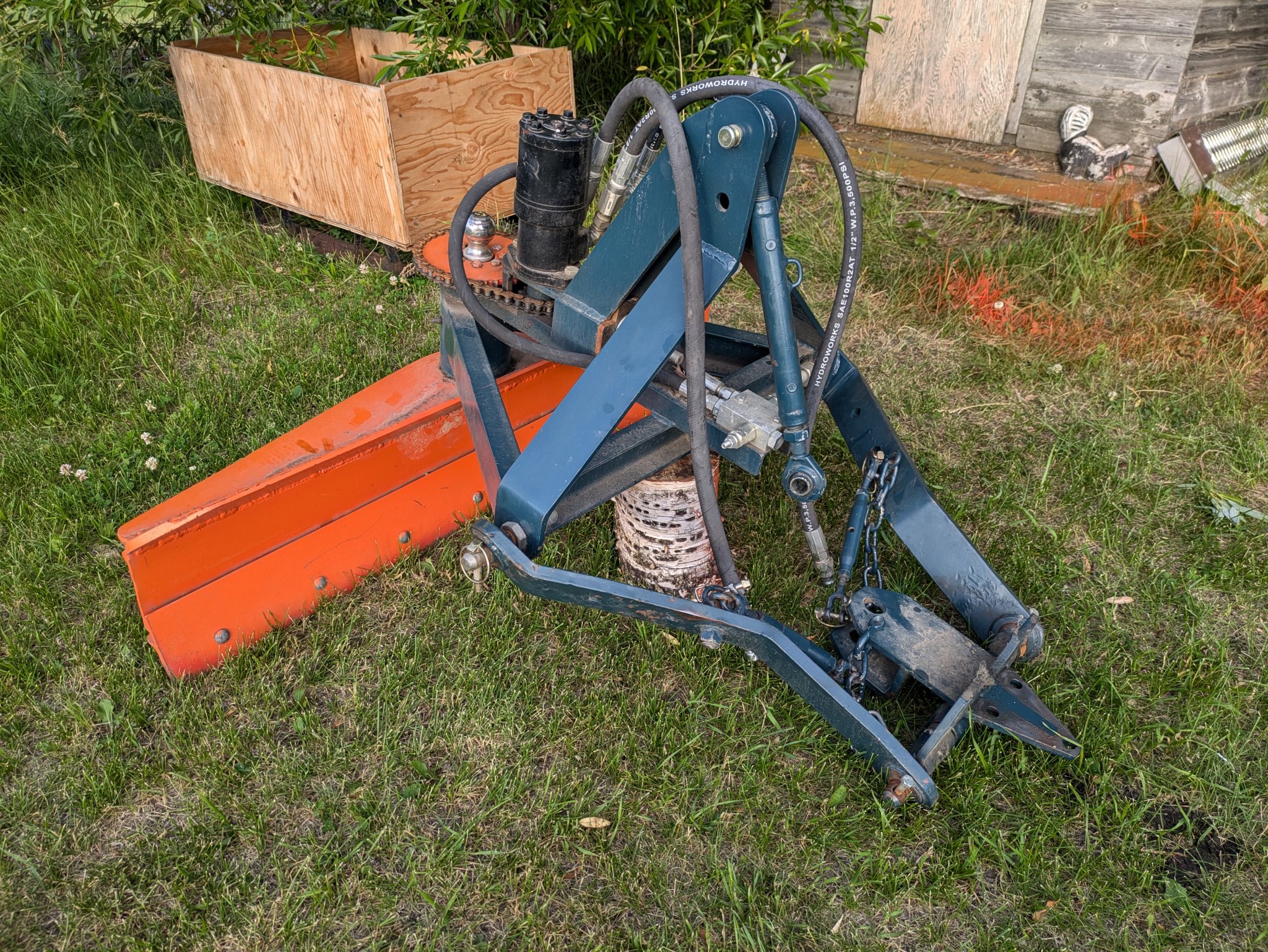

Here is a photo of the 3 point linkage removed from my B6000.

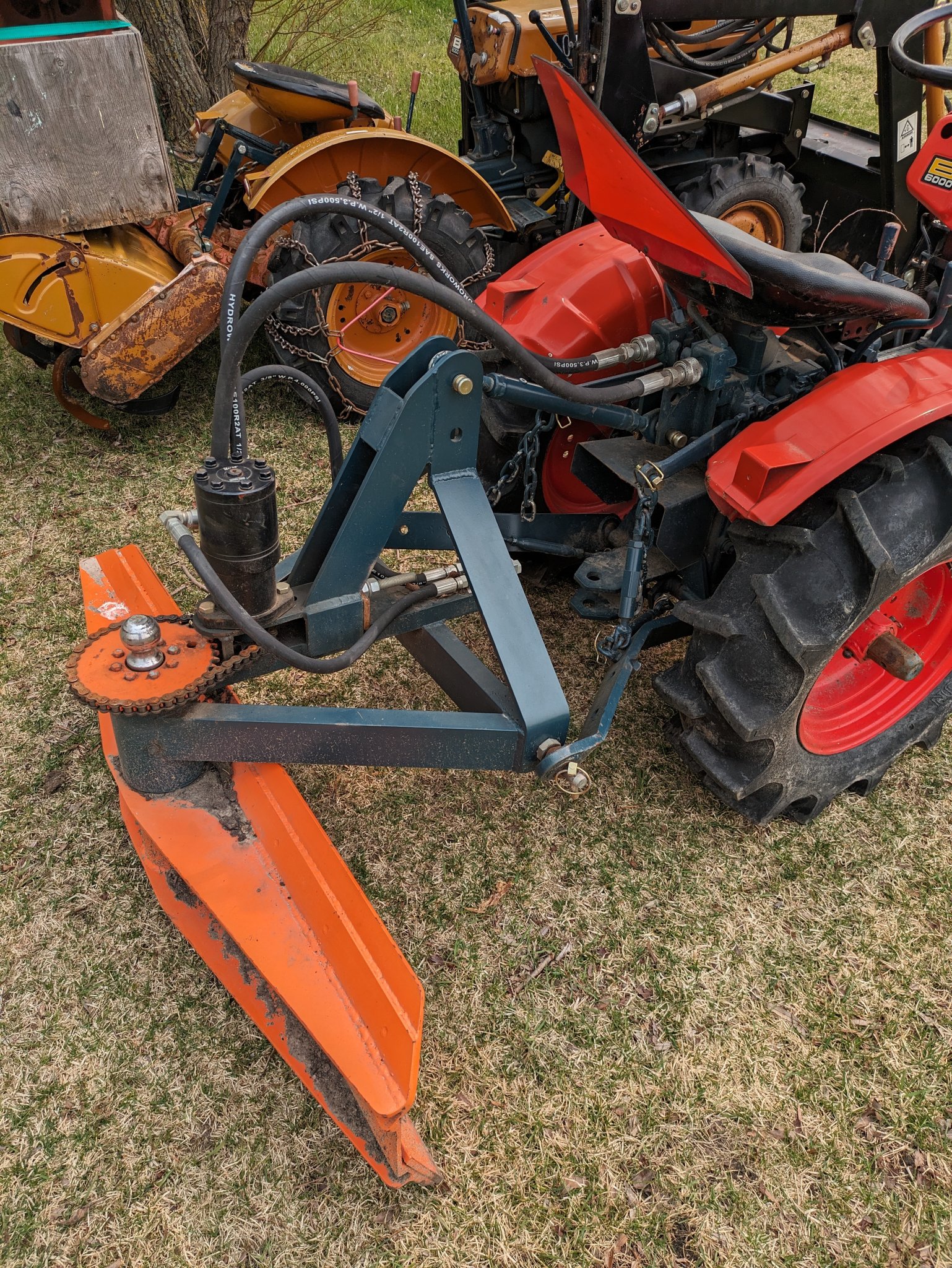

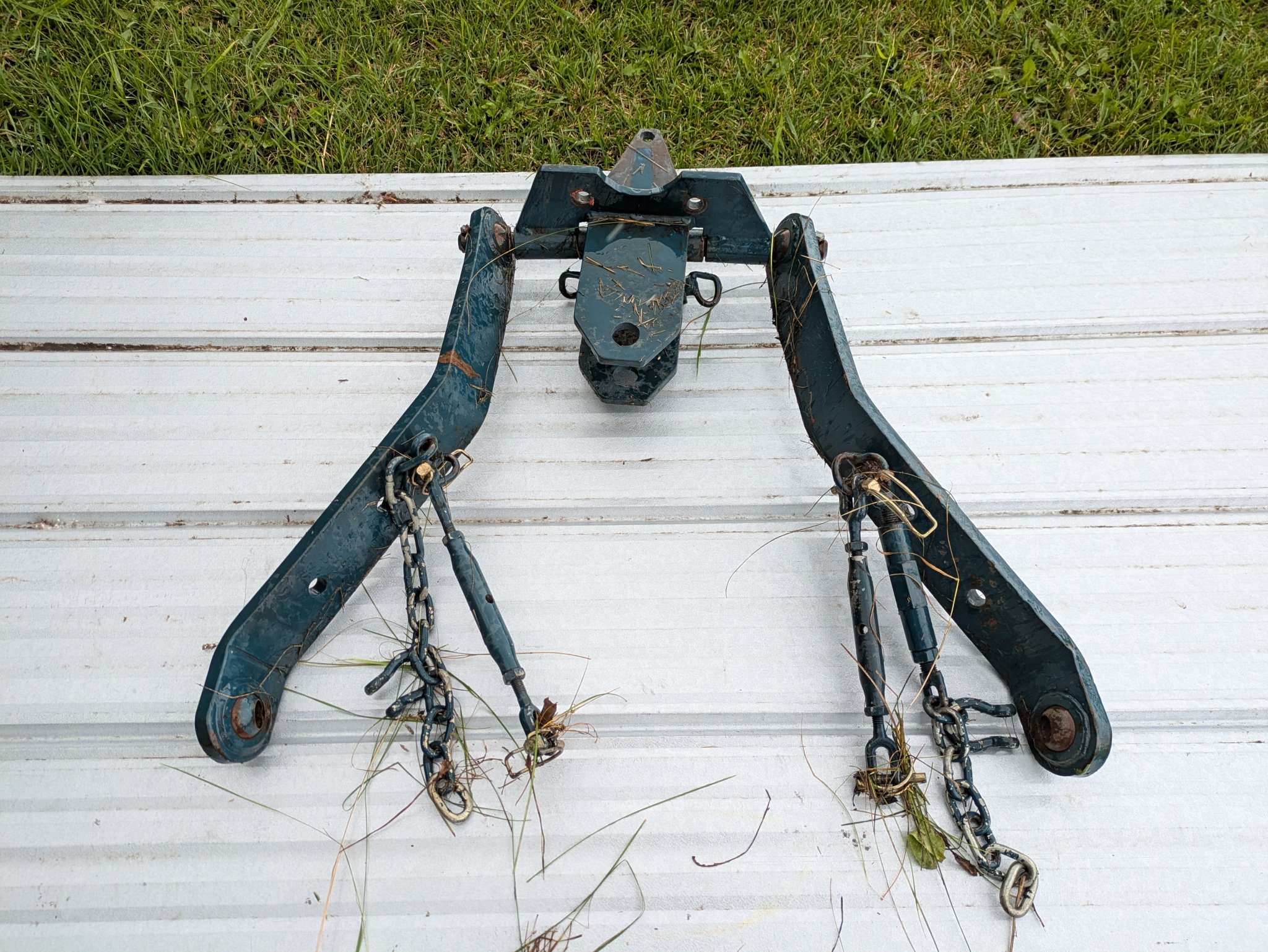

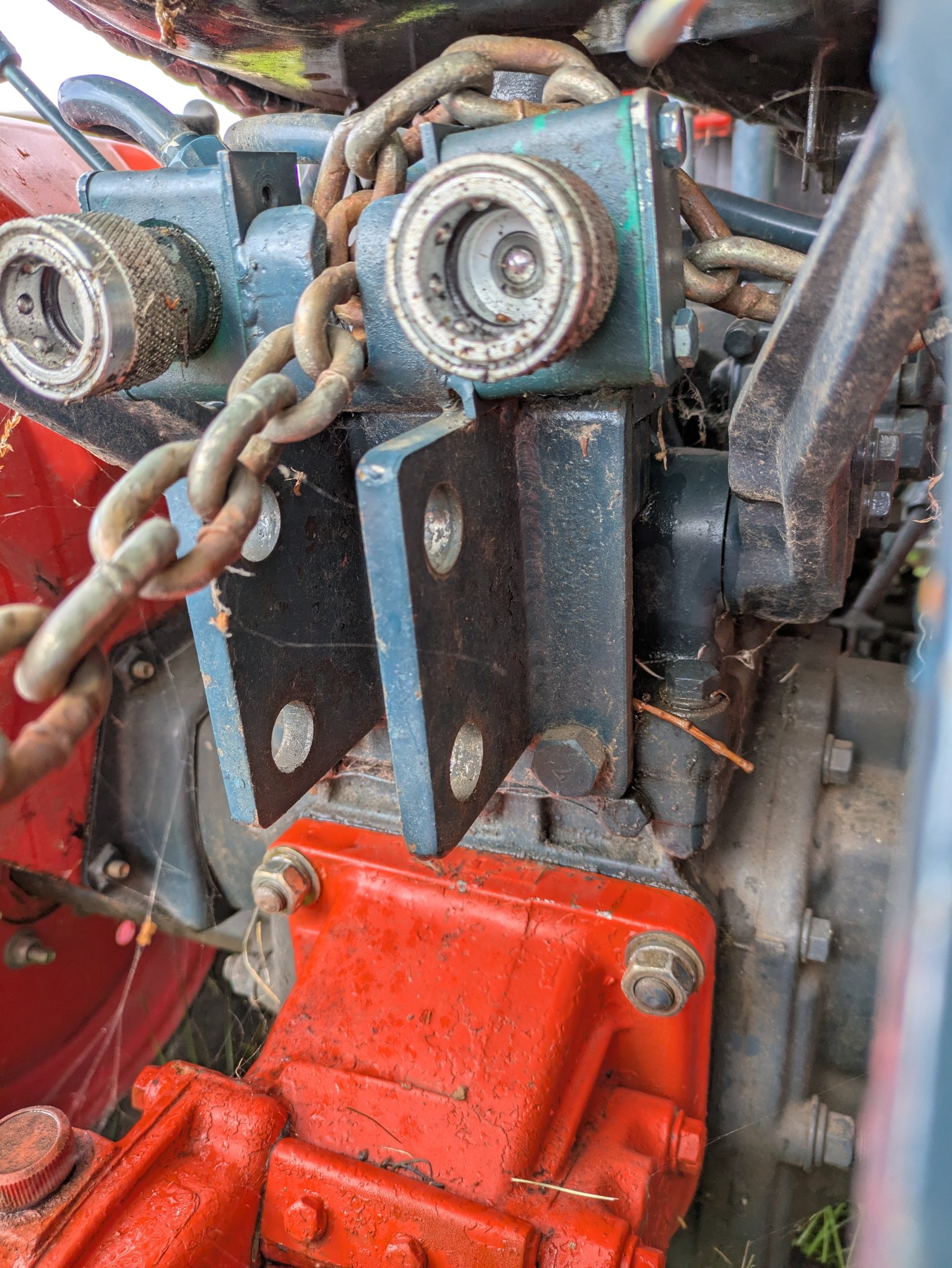

And another with it installed.
I don't know about the quality but This kit seemed like a cheaper option than trying to find OEM pieces when I was looking at adding it to the other tractor that didn't have it.

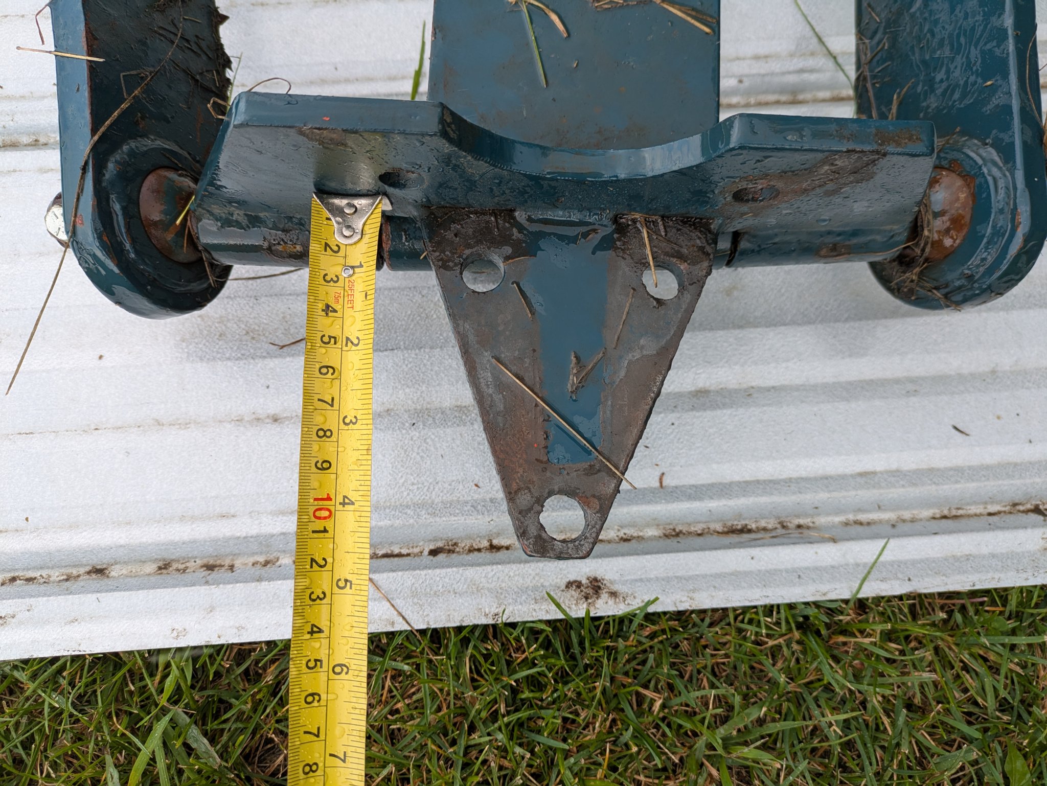

It doesn't look like it includes the lower bracket that bolts to the tractor that can be seen in my first photo though. It would not be a hard piece to have made though. I could get some better photos of it if you would like.

Here is a photo of the 3 point linkage removed from my B6000. View attachment 160183
Would you mind showing me the bottom and top sections so I can see where they're screwed in? Thanks.

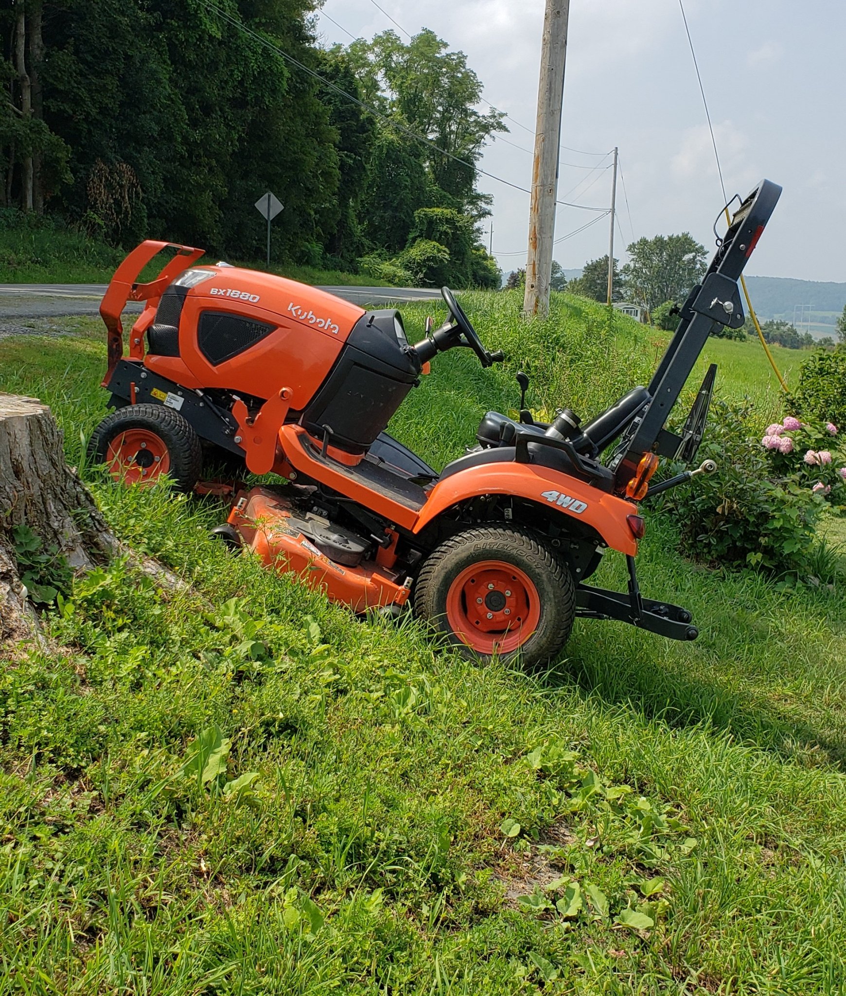

Geohorn is spot-on about working on slopes, your tractor - your pucker factor - your decision. This is something you'll develop as you get more and more time in the seat. Just the fact that you're thinking about it now instead of after something happens is a good thing.
Below is a picture of MY TRACTOR on a 25 degree slope. I've been going up and down this in 4WD for as long as I've had the BX, no problem. Would I do it going side to side - no way. Where I'm standing taking the picture from the slope is about 15 degrees which I've done side to side, but still makes me nervous so I go up and down. I have nothing but the MMM on, any FEL or rear attachment changes the whole equation.
Be aware if you are going side-to-side, even on very moderately sloped hills turning can flip you without notice especially turning up-hill. More so if you have the front loaded, I've come closer than I like to admit. You've been at it all day, it's getting late and you want to get done, that's when it happens.
Post pictures when you get it all hooked up, we're cheering for you!
Two things:
That kit is WAY less expensive than Messick's
Chain driven back blade adjustment, pretty cool.

I will try and get some better pictures of the plates and where they attach tonight or tomorrow for you.
