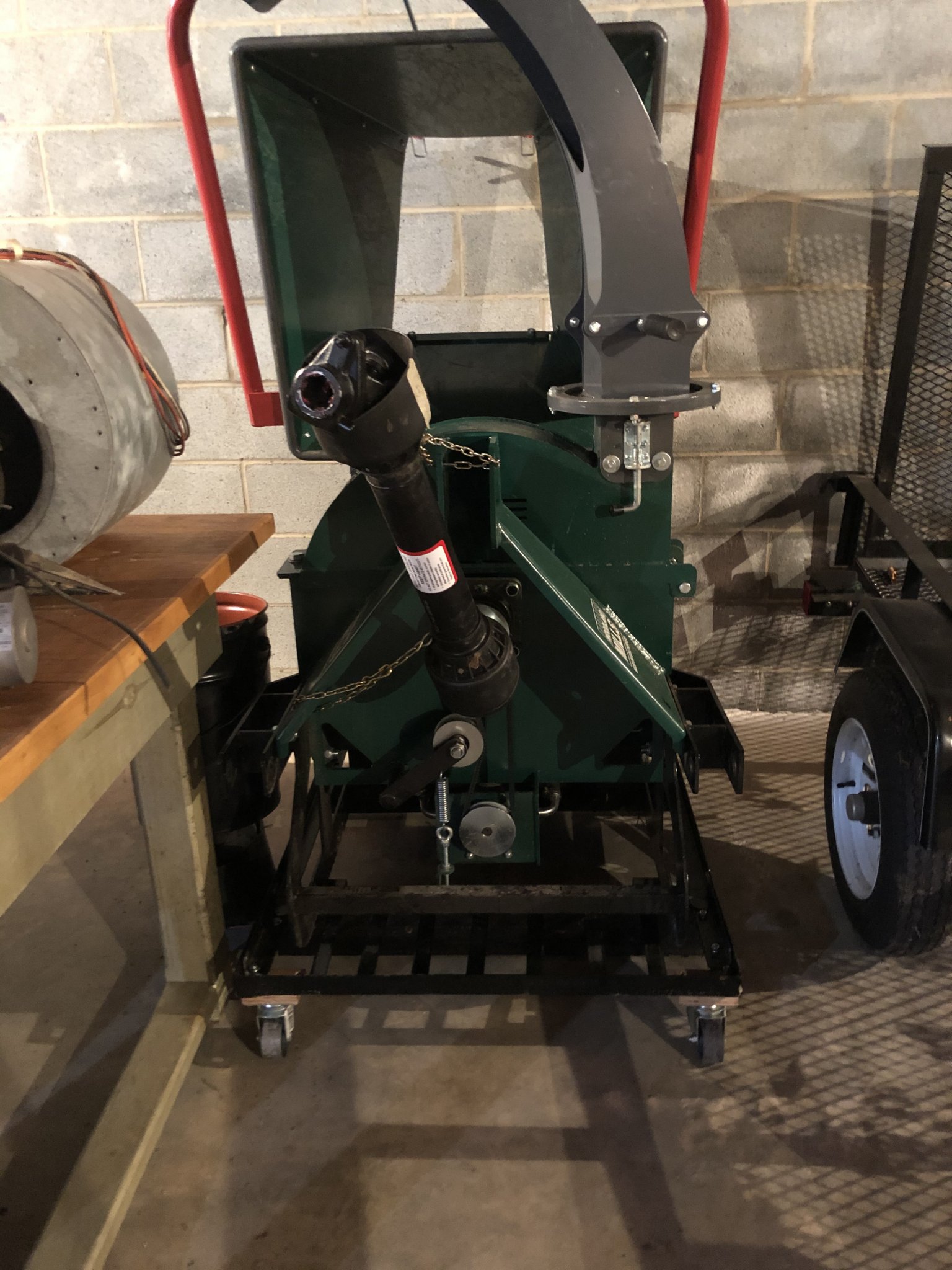

Smooth concrete. Put everything on casters. Heaviest thing I have is this 800lb chipper. Steel casters have very little rolling friction so they make it easy to move stuff around. The chipper came on a swell steel pallet so I reinforced the corners a bit and just that for the chipper. Other stuff, I made plywood dollies of appropriate sizes and rimmed them with 2x4’s for the really heavy stuff such as the box scrape. Makes storage much simpler and efficient. For instance, where the chipper is sitting in the photo; no way I could put it there with the tractor.
Also I don’t have a quick hitch and it makes installing and removing stuff from the 3 point MUCH easier to load it off a castered dolly.
I do have some lighter, less often used implements in a dirt floor shed and they’re more of a pain to deal with but don’t use them much and they’re light enough to manhandle a bit. Manhandling the chipper or box scrape to wiggle it around to hitch would require a bigger man than me if they weren’t on casters.

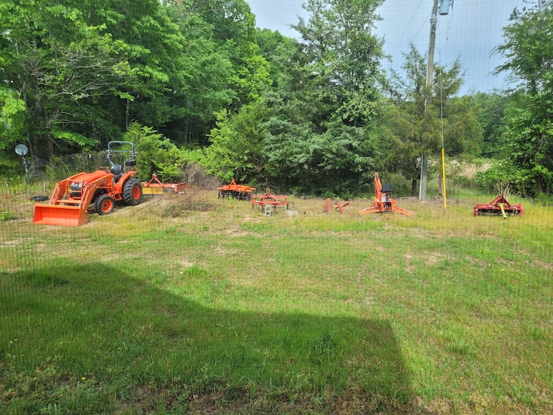

Yeah, I don't have any place to store them, so along the fence it is
"A large, flat, covered area is on my wish list." - One of these days

That's kind of what I'm doing except they're next to a garage and the ground slopes away from the garage ... significantly! 😖
