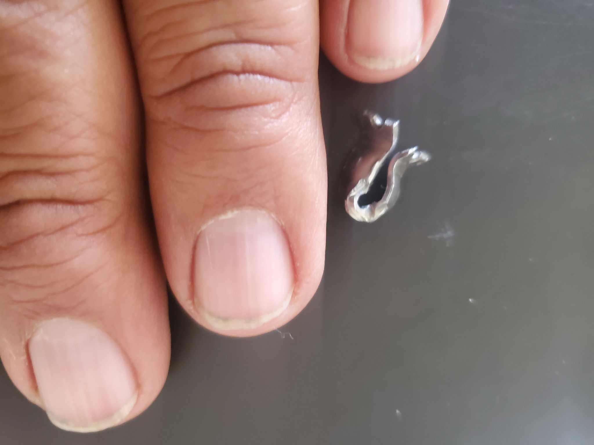

Identify this part
6,400
2,043

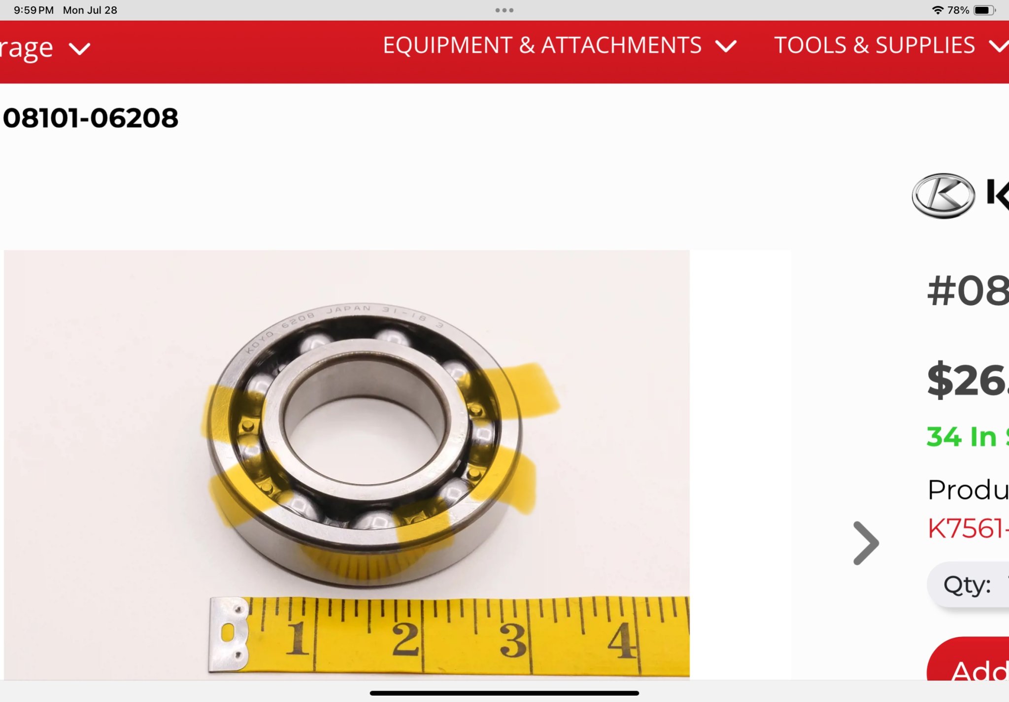

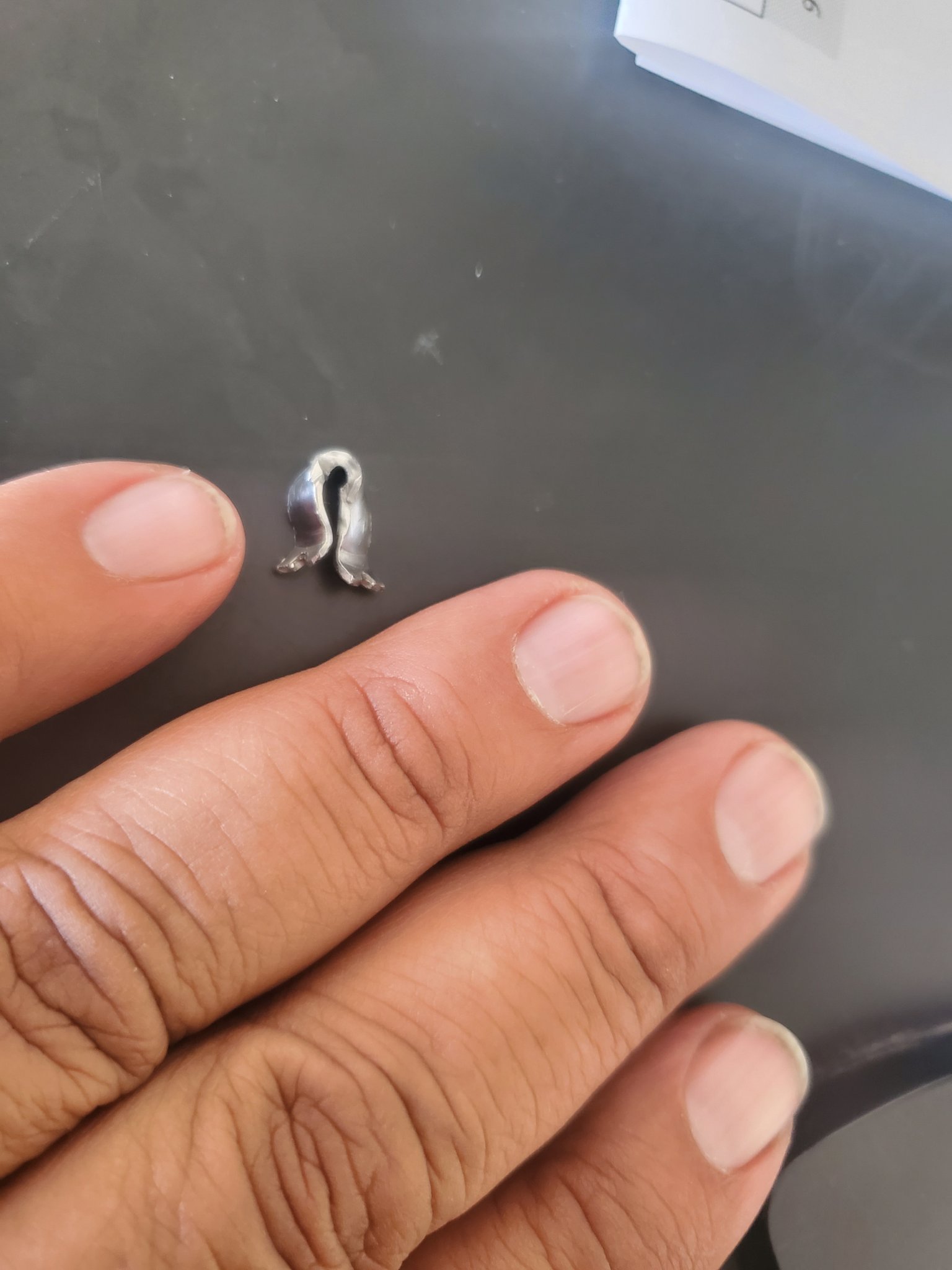

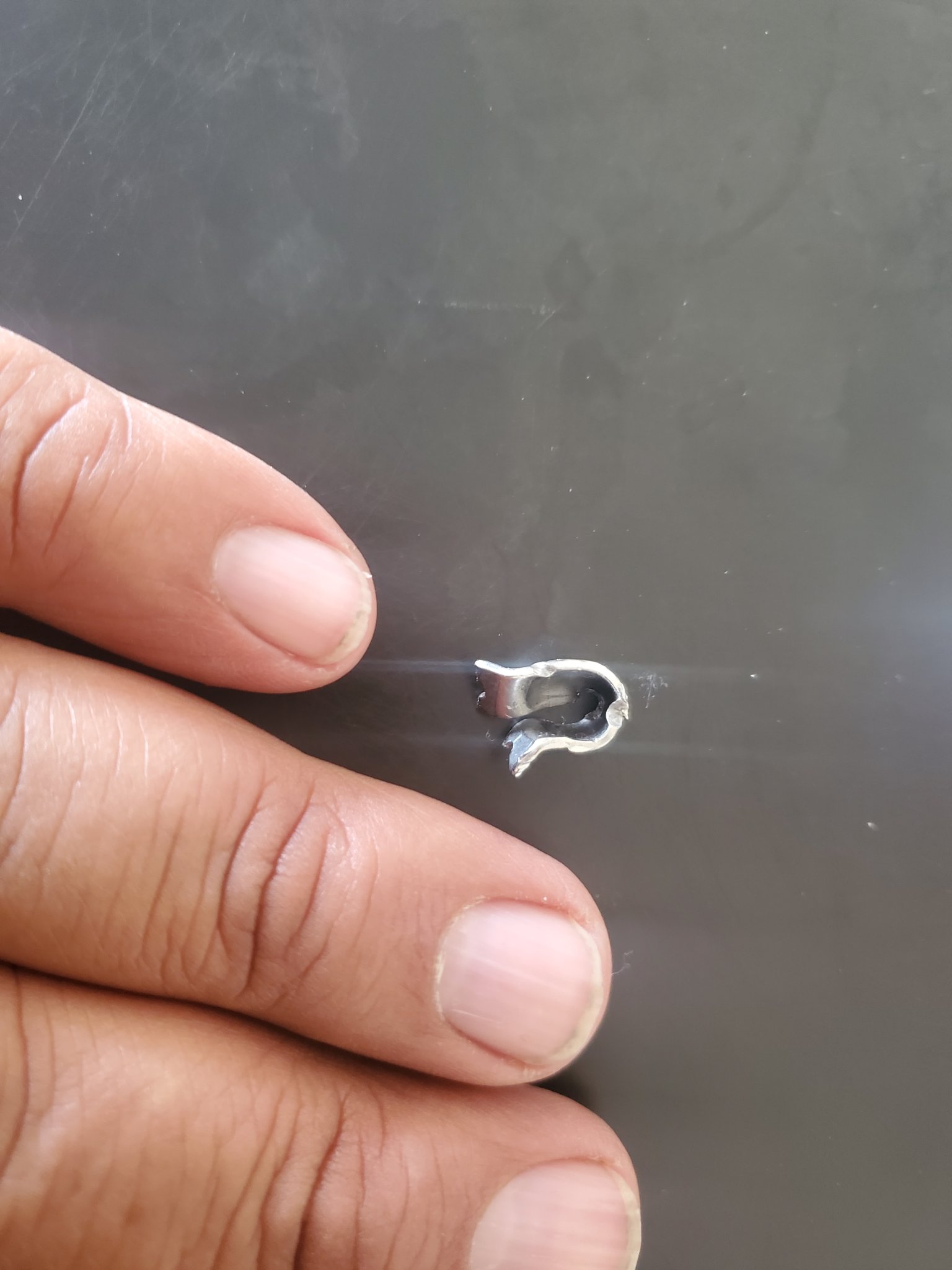

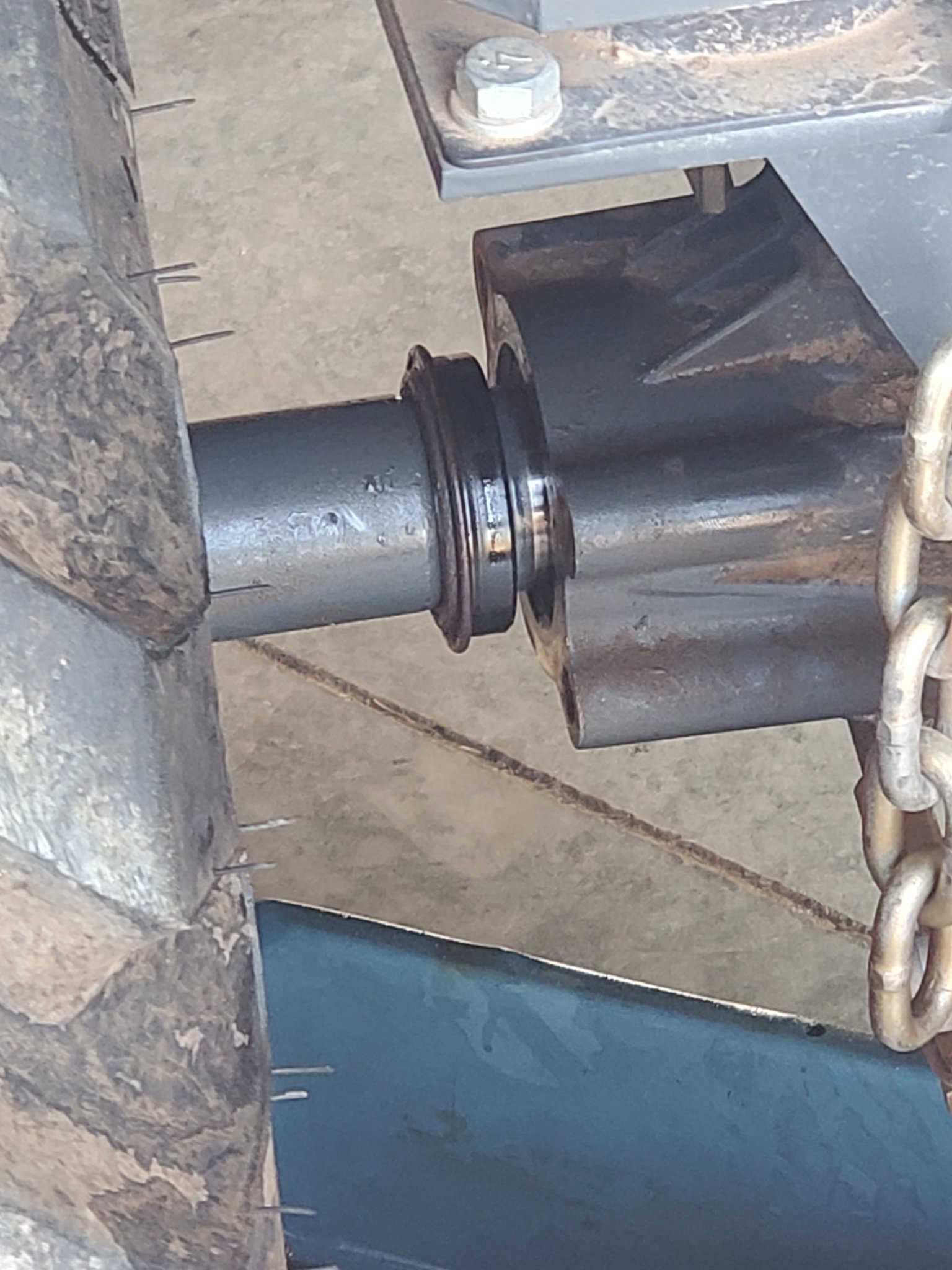

That looks sort of like part of a bearing cage (ball separation cage). There is a bearing behind that seal (size 6208?).
The cage is riveted together and (some of) the rivets are highlighted in this picture.
You may be able to get a picture looking in there but I think you have a failed bearing.

Good luck with the repair. Make sure you find every last piece of that bearing or you'll be looking at a second tear down.
